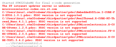

Hi, I am currently working on a project that uses a BLDC motor (42BL90L2-3), and I am trying to drive it using a DRV8323 gate driver. I have been using the ST MC workbench (version 5.4.8) to profile the motor and control unit, but when I try to generate the project I get a whole bunch of errors stating "PDSC version is not supported". The project still generates, but after importing it to CubeIDE it will always HardFault when I try to debug, it never makes it to the while() loop. I am using CubeMX version 6.2.1 and STM32 FW V1.8.4. Has anyone else ever encountered this issue?

Just got the same problem and I am using ST workbench 6.2.1 and CubeMx 6.4.0, I was curious if this is already figured out.

Bump. Any info on solving this. I'm running 6.3, and not getting this on all projects.

I upgraded STM32CubeMX to 6.12.0, but now I get the following errors in MC Workbench when I attempt to generate code:

Winner winner, finally got everything running again with this last fix:
https://community.st.com/t5/stm32-mcus-motor-control/mc-6-3-with-mx6-12-attr-not-supported-dmpu/td-p/694578
