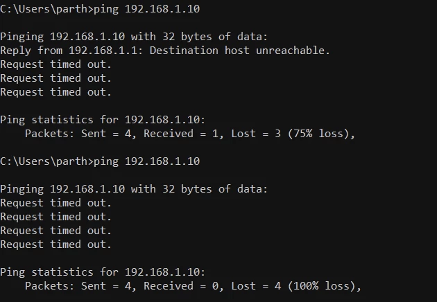

Troubleshoot Ethernet and LwIP Implementation on Nucleo-H753ZI

I'm writing to seek assistance with challenges I'm encountering after implementing Ethernet and L w IP on an STM32H7 Nucleo-H753ZI board using STM32CubeIDE 1.17.0 and Hardware Pack 1.12.1. I've meticulously followed the steps outlined in the article: https://community.st.com/t5/stm32-mcus/how-to-create-a-project-for-stm32h7-with-ethernet-and-lwip-stack/ta-p/49308
However, when I attempt to ping the device, I experience the following issues:

Jan 6, 2025 1:57 PM UTC
Hello @ParthDhoble ,
the content you provided for your issue is generic and seems to be AI generated content.
I'll be glad to assist you in your implementation following the article you mentioned but I will need to know what your issue is exactly.
as a head start if you developed an application following this article you can crosscheck it with the provided examples on GitHub for your specific MCU GitHub - stm32-hotspot/STM32H7-LwIP-Examples: Ethernet examples using LwIP + FreeRTOS for STM32H7 Discovery and Nucleo boards.
please make sure to describe your issue with your proper words instead of using AI generated content.
refer to this article to help you maximize your chance in getting a solution. for more information about why you shouldn't use ai generated content check this article .
Regards
Jan 6, 2025 6:20 PM UTC
the contents mention in the post are supported for stm32cubeide version 1.9.0 and hardware package h7_1.10.0 below the newer version for these software and packages such as CubeIDE 1.16.0 and package h7_1.12.2 have different config and defaults.
also the contains in the tutorial point are not proper as the images and the step contradict each other.
Jan 8, 2025 4:41 PM UTC
seeing the screenshots in the above post i see that you got one of the ping requests answered from the board meaning that you had configured the ethernet and LwIP are somewhere functional.
know the reason you don't get answer from ping could be most probably caused by memory configuration stack allocation for FreeRTOS tasks and LwIP TCP/IP handling task as well make sure you configure those correctly you can refer to the implementations in
STM32Cube_FW_H7_V1.12.1\Projects\NUCLEO-H743ZI\Applications\LwIP\LwIP_HTTP_Server_Netconn_RTOS
Regards
