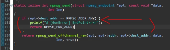

I'm developing RTOS environment of dual-core in STM32H757.
An error occurred while transfering the data from CM4 to CM7, and I didn't think the EndPoint was fully created, so the value of variable "status" checked, and the value is greated than 0.
Is the variable and creation of EndPoint irrelevant?
<Flow>
1. CM7 & CM4 : EndPoint and OpenAMP initialized (status ≥ 0).
2. CM7 : Function  MAILBOX_Poll() is circling an infinite loop in the function OPENAMP_Check_for_message() within function receive_message().
/ CM4 : Waiting for the flag status.
3. [Send error from CM4 to CM7]
CM7 : The same condition as '2.'
/ CM4 : Function OPENAMP_send is returning RPMSG_ERR_ADDR because dest_addr is equal to RPMSG_ADDR_ANY.
Any help is greatly appreciated!
# The code in rpmsg.h file.
# Terminal results
Friendly regards, Tau

Hello @Imen.D
Thank you for your prompt response and congrating me.
I haven't seen that article, but I've seen examples from the sources below.
I think the example is simmilar to the article from the source below. Is that correct?
I understand that CM7 is the master core and CM4 is the slave core in STM32H7, but I would like to use CM4 as the master core in OpenAMP.
In other words, can I apply the CM7 example code to the CM4 files and the CM4 example code to the CM7 files?
At first, I would like to send the data from CM4 to CM7. After this operation, Ultimately, I want to implement two-way communication.
