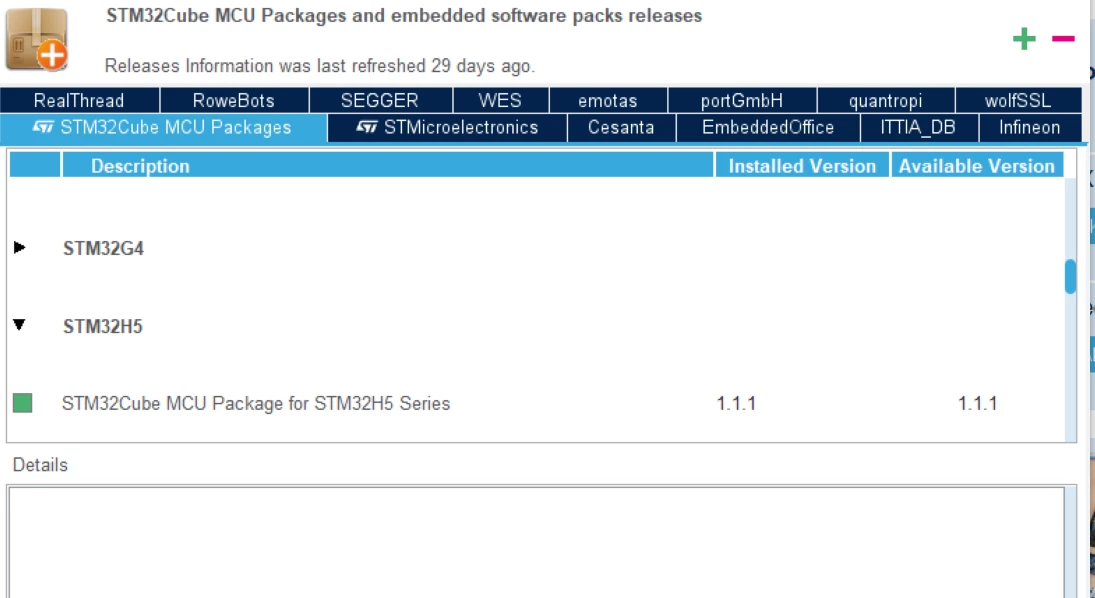

@manoj7 Please go to  STM32Cube MCU packages and downloads the package , In fact The H5 package natively supports Azure integration.

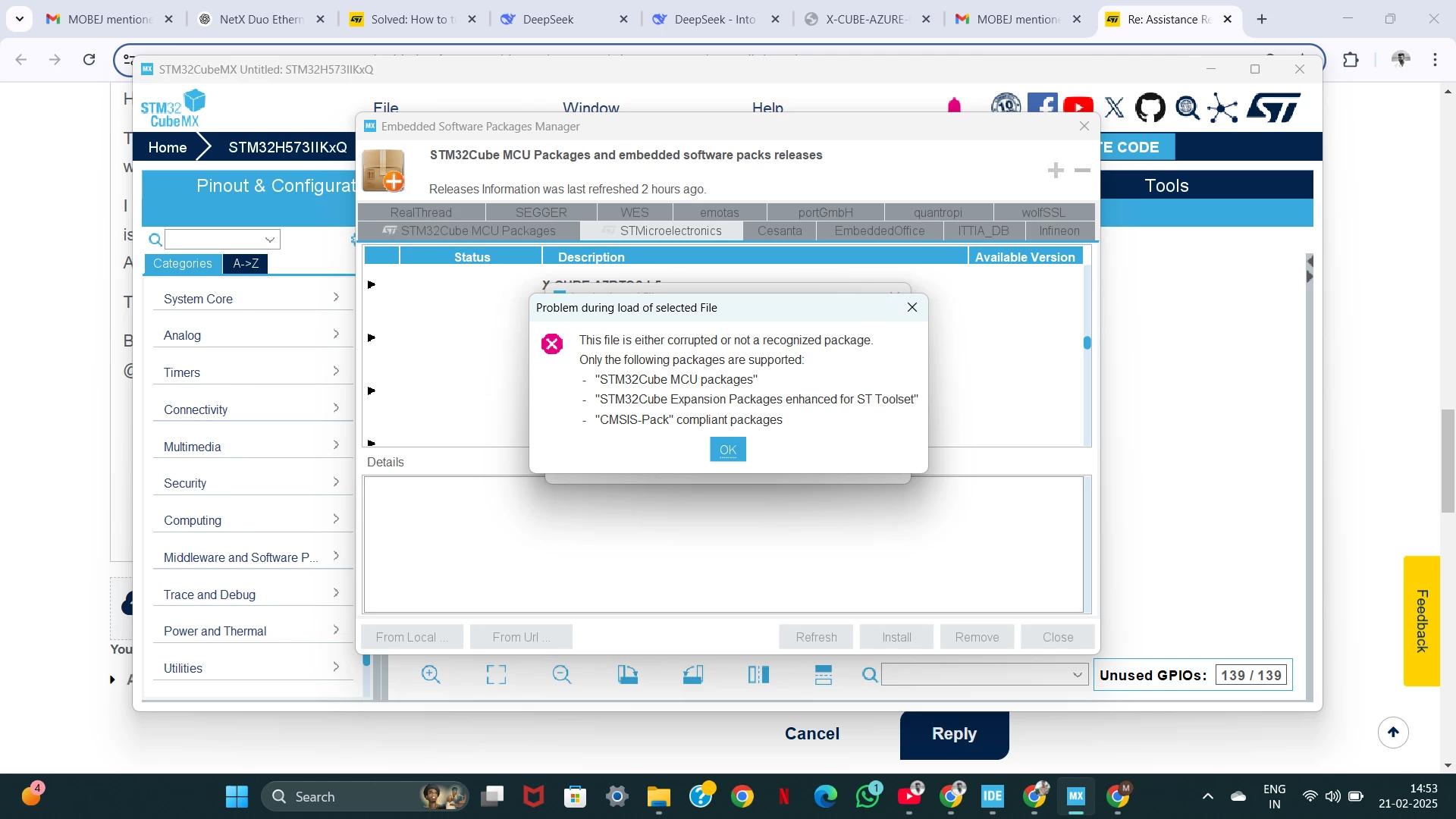

Thank you for the information! I found that NetX Duo is available in the middleware section of STM32CubeMX, which I have enabled. However, I couldn't find the X-CUBE-AZURE-H5 package in the middleware section.
I manually downloaded the X-CUBE-AZURE-H5 package in ST website and tried linking it to STM32CubeMX, but I encountered an issue (please refer to the attached image for details). Could you guide me on how to properly integrate the X-CUBE-AZURE-H5 package with STM32CubeMX?

Hello @manoj7 ,
To integrate the X-CUBE-AZURE-H5 package with STM32CubeMX, please kindly follow this  article: How to install and import an X-CUBE Expansion Pack.
