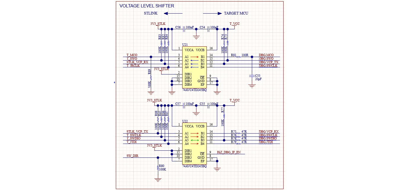

EZHON.1
March 11, 2026
This is level shifter version for some STLINKV3E solution.
