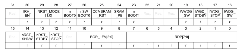

Remaining question: While troubleshooting before identifying the power issue, I found the Option Bytes panel shows NRST_MODE = 0, which per RM0440 is a reserved/undocumented value (default should be 3, Reset Input + Output). Several attempts to correct this (GUI and CLI, -ob NRST_MODE=3, various connect modes) were made while the board was still being debugger-powered and unstable, so I'm not certain whether this write ever completed successfully. Now that stable external power resolves the connection:
  1. Is NRST_MODE=0 expected to cause any issues on its own, given it's a reserved value?

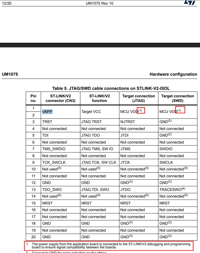

My working theory is that the ST-LINK's VDD/VTref pin is intended as a voltage sense input, not a real power source
Yes, that is correct; eg, from the ST-Link V2 User Manual:
ST-LINK probes tested: multiple units
What models ?

HI @Andrew Neil
We have pin 19 connected to power up the board. I have confirmed that the Debuggers are genuine. So, the MCU on the custom board should be getting required power. ca you please let me know if anything can be done to fix my issue.
Have a nice day.
Thank You.

» 1. Is NRST_MODE=0 expected to cause any issues on its own, given it's a reserved value?
From RM440/5.4.1 Option bytes description, NRST_MODE=0 is not described as reserved value, it is only flagged as reserved in STM32CubeProgrammer for some reason, and the STM32G431 comes with NRST_MODE=3 out of the box:
User and read protection option bytes
Flash memory address: 0x1FFF 7800
ST production value: 0xFFEF F8AA
Bits 29:28 NRST_MODE: PG10 pad mode
00: Reset Input/Output
01: Reset Input only
10: GPIO
11: Reset Input/Output

One wiring detail: with external power, the probe’s VTref/VAPP input should still connect to the target’s VDD, alongside SWDIO, SWCLK and GND. It lets the probe sense the target supply. Connecting NRST also enables hardware reset control.
Also, VDD and VTref aren’t interchangeable labels on every probe. On the genuine ST-LINK/V2’s 20-pin connector, pins 1/2 are VAPP; pin 19 is labelled 3.3 V VDD, but ST specifies leaving it unconnected to the target. See UM1075, Table 4. That distinction matters when explaining why the original setup worked.
For NRST_MODE=0, Mike_ST has clarified in this thread that both 00 and 11 select reset input/output, with 11 being the production default. That contradicts CubeProgrammer’s “reserved” label, so I wouldn’t keep rewriting option bytes just to clear that label. First save a fresh option-byte read with stable power. ST’s clarification
