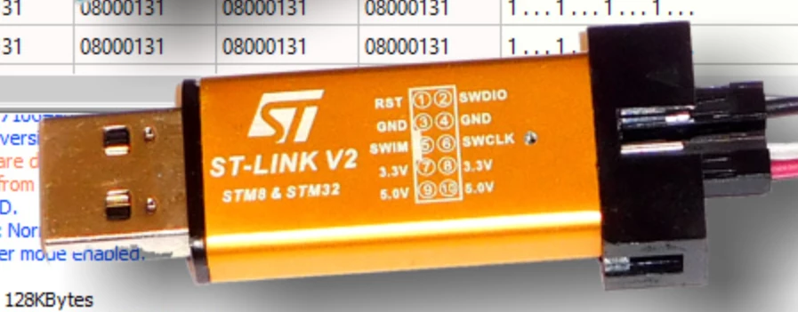

您好,请教一下,st-link v2连接电脑USB线束接错会不会损毁st-link?

If you have this programmer, it was not made by ST and is not guaranteed to work with ST tools, either with or without a USB extension cable.

谢了,不太懂英文,首先感谢你的回复,而且非常及时,也让我知道,我和老外是可以互联的,当然不能确定是不是老外回复,总之,非常感谢,我用的外形和这个不一样,它上面有两个接口,一个是stm32,一个是stm8,我在中国,下载的stm32cubeIDE本身好像也有问题,st-link专用工具我好像没有找到,一直没办法使用,所以我也无法确定我使用的st-link是不是坏了,如果是坏了,唯一的可能连接电脑的线束可能被接错,我是初学者,我下载的stm32cubeIDE也无法使用,也借此测试我们的网络情况,感谢.!

The one I'm using has a different shape; it has two interfaces, one STM32 and one STM8.
Is that one of these you have:
There are different STLINK versions available on the market, two of them are:
ST-LINK-V2:  https://www.st.com/en/development-tools/st-link-v2.html
and ST-LINK-V3: https://www.st.com/en/development-tools/stlink-v3set.html
So could you confirm which one you have? or at least post a photo for it top and bottom of it?

@abczhang wrote:
Will connecting the ST-Link v2 to the computer with the USB cable incorrectly damage the ST-Link?"
I don't know if this has lost something in translation, but it would be very difficult to get get the USB connection from the ST-Link to the host computer wrong - unless you are making your own USB cables?
If you mean the connection from the ST-Link to the target then, yes - you could possibly do damage to the ST-Link and/or to the target.
This is why using standard cables and headers (rather than loose wires) is a safer option!
As @TDK suggested, beware of fake/clone ST-Links.

Bad USB cables are out there, often charging cables, lacking data wires or improperly twisted/shielded. This is a bigger problem for USB 2.0 High Speed (480 mbps).
Hubs and Docking Stations can give issues with ST-LINK, I've seen issues with data integrity and failure, as the protocol isn't robust. Perhaps sequencing or retry issues.
I suspect non legitimate ST-LINK can be ignored or bricked.

+ If you have this one as bottom image with Chinese text, it's a ST-LINK clone:
Please read this thread: ST-link V2 Connection error
