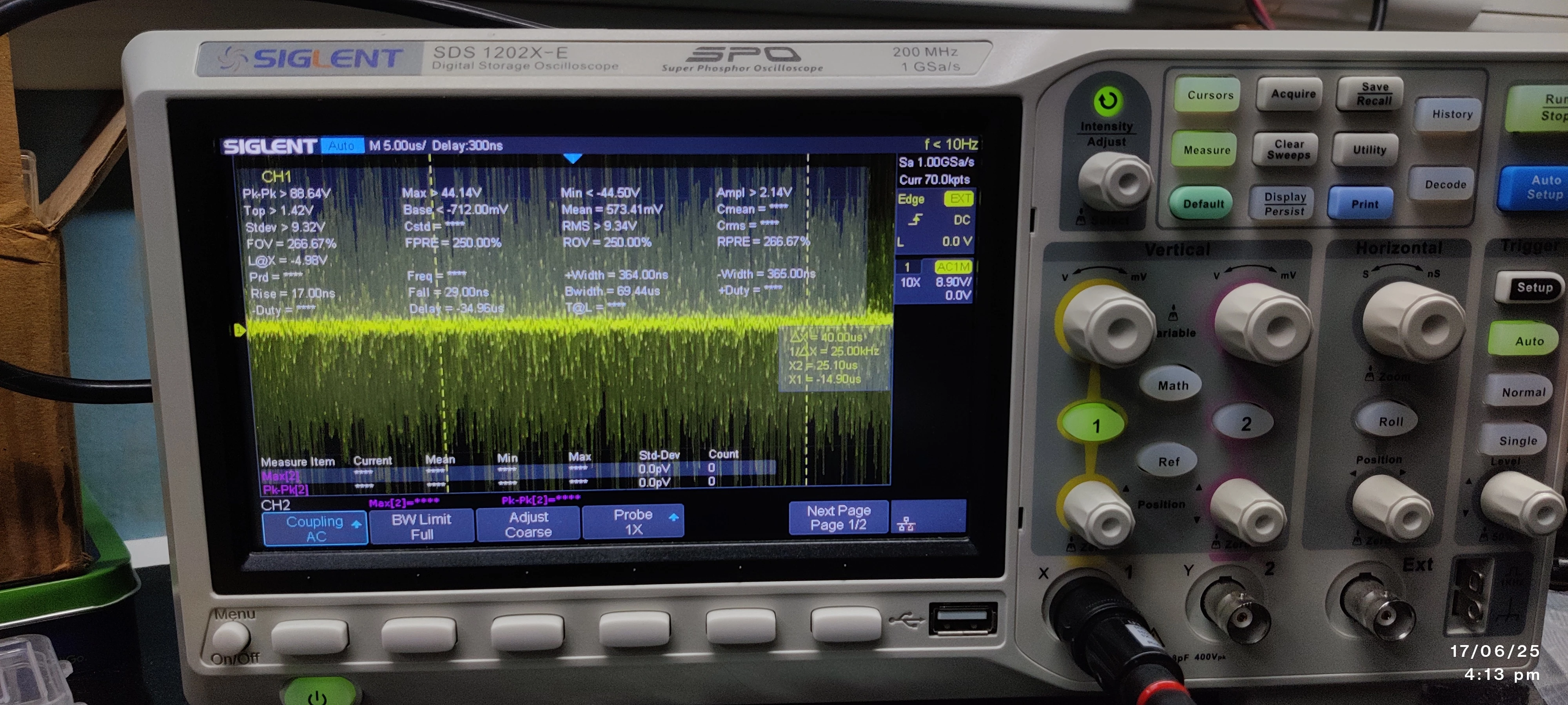

I am using NUCLEO-H7A3ZI-Q (32 bits) . While Debugging the LED4 starts blinking solid red and never exits debugging,it shows a breaking point at MCU config();.
I was running a program to obtain a sawtooth wave through the DAC pin PA5.

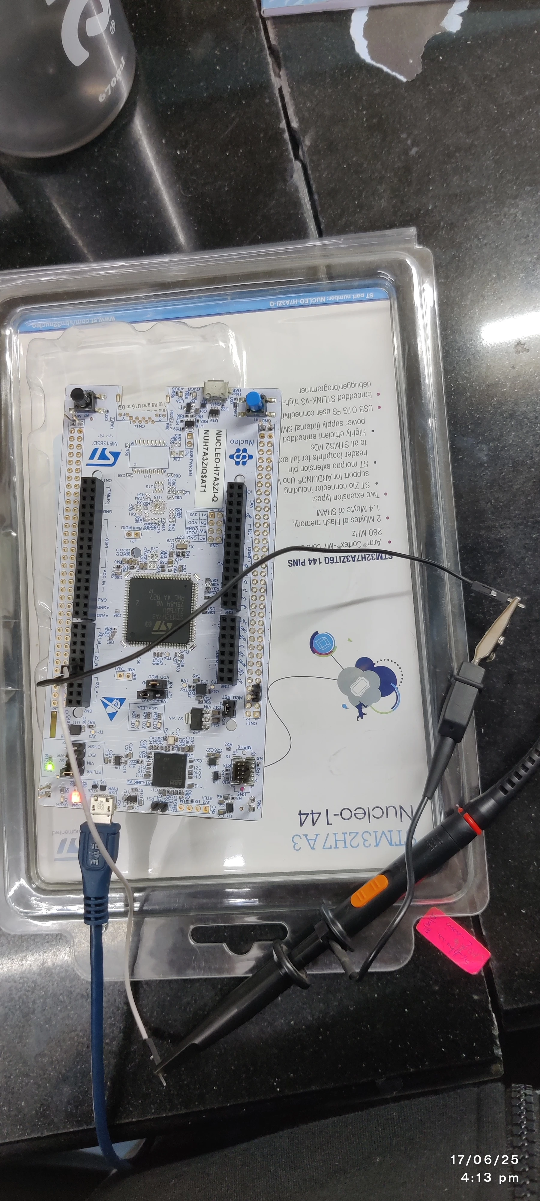

waclawek.jan
Jun 17, 2025 6:51 AM UTC
> no desired output signal (too much noise)
Show.
Also, what equipment do you use and how exactly do you connect ground?
KRISH_Author
Jun 17, 2025 10:55 AM UTC
1000246739.jpgthankyou for the reply .frequency coming in kHZ and MHZ
KRISH_Author
Jun 17, 2025 10:56 AM UTC

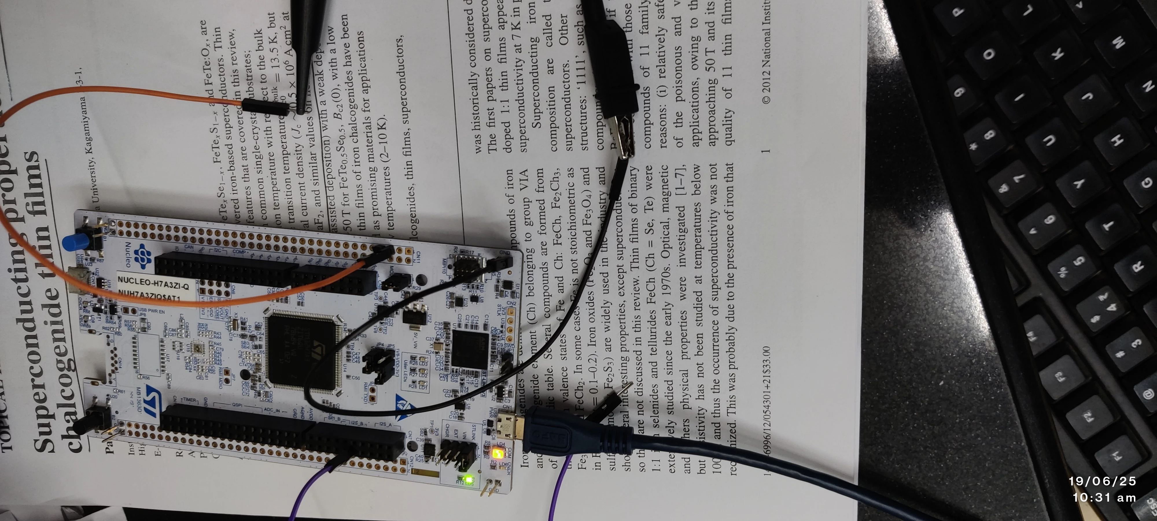

KRISH_Author
Jun 17, 2025 10:57 AM UTC
in CN7 pin no.8 for GND and pin no.10 for DAC (PA5)
waclawek.jan
Jun 18, 2025 6:02 AM UTC
Something is very wrong.
Try to connect the ground clip to the pins in the corners.
Try to connect the probe to GND, still noise?
Do you see this noise also when the processor is held in reset (simply by holding down the reset button)?
And what happens if you set one single voltage level in the DAC (say, 1/3 full scale) and then do nothing in the main loop?
Btw. you have set the oscilloscope to 10x probe but have the probe switched to 1x, so the numbers are off by factor of 10, but still the amplitude of that noise is baffling. There's also seldom any reason to use AC coupling when measuring on mcu pins.

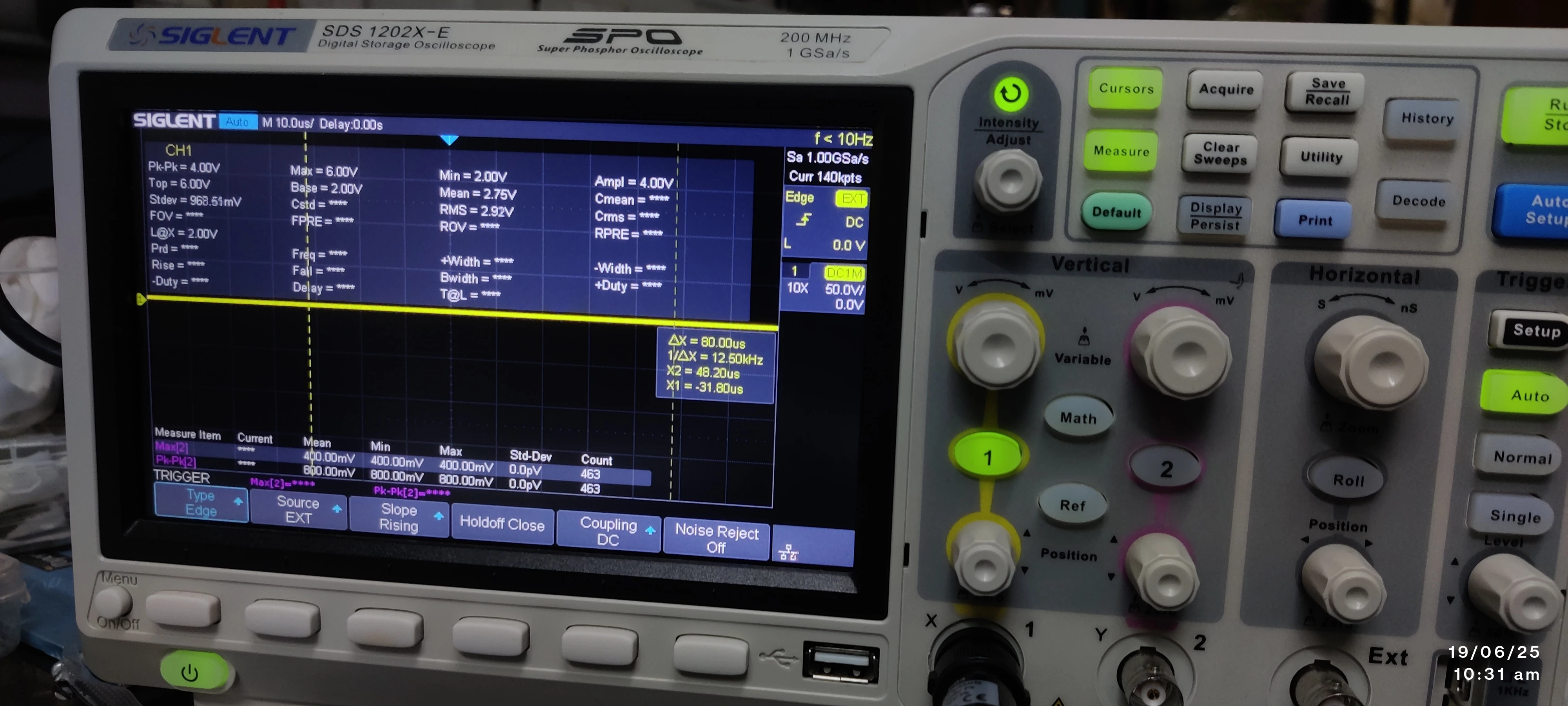

Right now across the VDD pin (CN11) and ground the multimeter shows 3.29V .But the oscilloscope probe in 10x shows 3.29V with the multimeter but the oscilloscope shows pk-pk :4V and max :2V, rms :2.92V.
Before once i had gotten 3.25V in the oscilloscope. I don't know why isn't it showing 3.29V today in the oscilloscope.
KRISH_Author

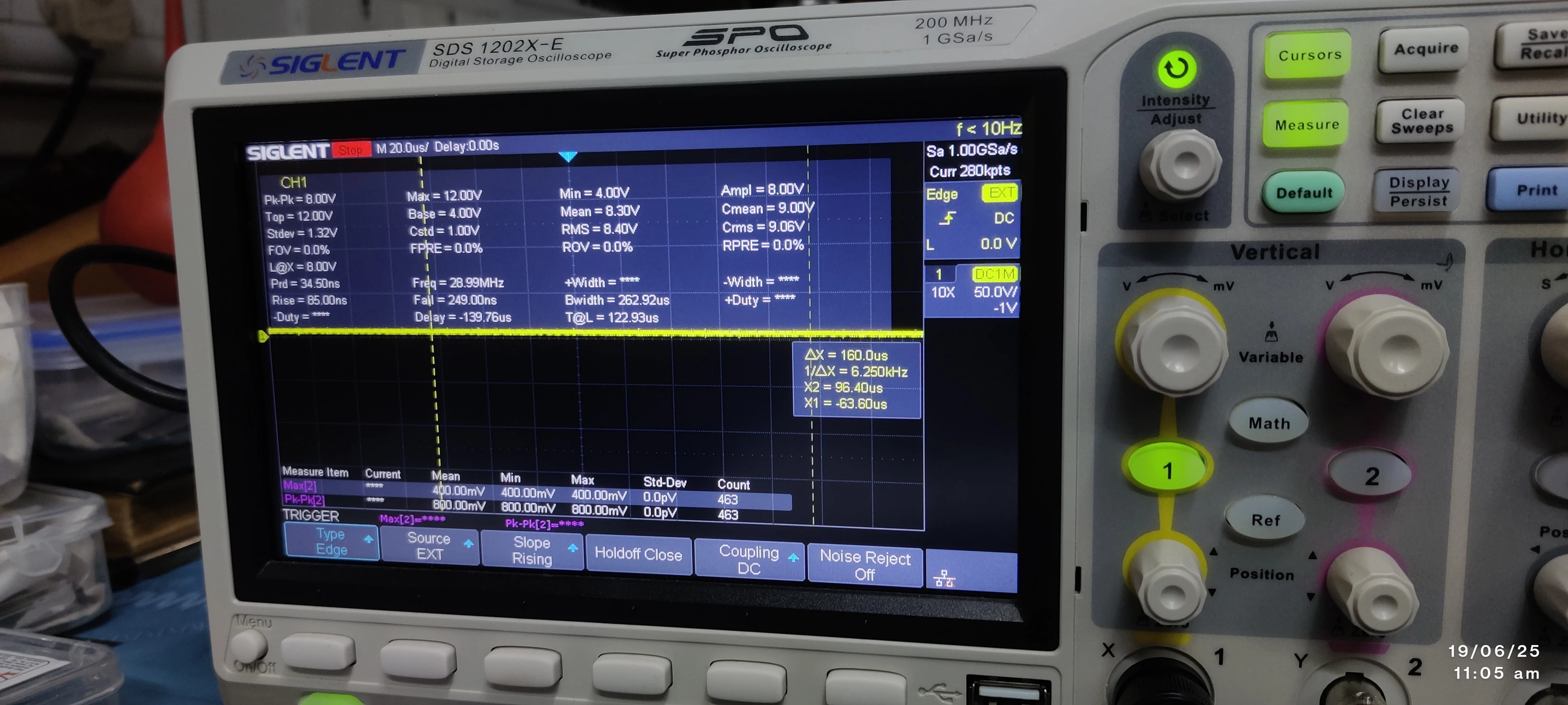

Jun 19, 2025 5:38 AM UTC
The voltage readings from the multimeter (while running the sawtooth code on DAC PA5)
It feels like the board is giving a proper sawtooth .But i am unable to see that wave .The oscilloscope doesn't seem to have any problems either. But it failed to display the proper sawtooth with correct voltage.DAC oscilloscope.jpg There is any other way to verify this without the oscilloscope?
am i right?
waclawek.jan
waclawek.janBest answer
Jun 19, 2025 5:53 AM UTC
You won't see a sawtooth waveform where period is some 10 seconds, on a 20us/div timebase setting of oscilloscope.
You also won't see 3V amplitude with 50V/div vertical setting.
You also may have broken ground pigtail on the probe.
