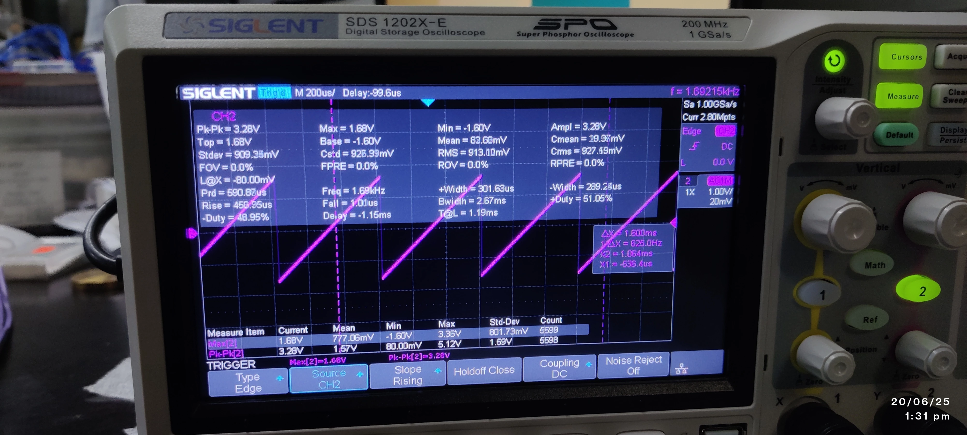

DAC programme - no desired output signal (too much noise)
I am using NUCLEO-H7A3ZI-Q (32 bits) . While Debugging the LED4 starts blinking solid red and never exits debugging,it shows a breaking point at MCU config();.
I was running a program to obtain a sawtooth wave through the DAC pin PA5.

You won't see a sawtooth waveform where period is some 10 seconds, on a 20us/div timebase setting of oscilloscope.
You also won't see 3V amplitude with 50V/div vertical setting.
You also may have broken ground pigtail on the probe.
13 replies
KRISH_Author
Jun 22, 2025 12:14 PM UTC
Thankyou all.Issue is solved. Got a neat noise free sawtooth.
My trigger source was also set to external, so my wave wasn't stabilized.
The GND pin near the PA5 was also not that efficient.But the corner GND worked.
Yes, in my  oscilloscope i had set the wrong period and amplitude.
