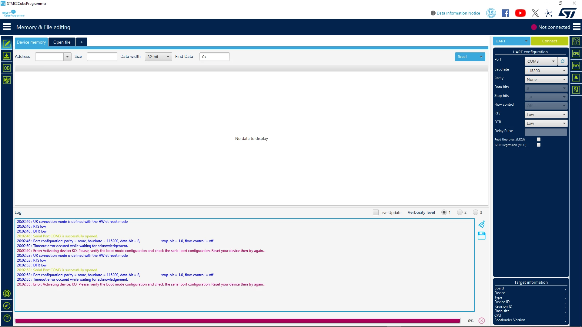

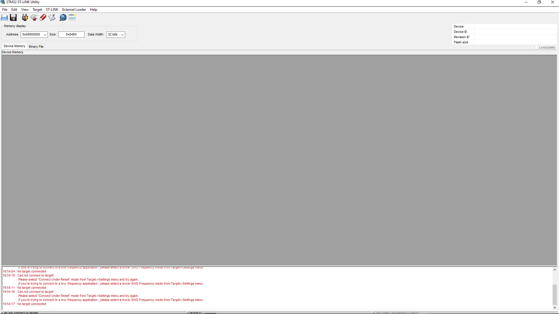

Yesterday, I have flashed faulty code to my STM32, and now I can't connect to it via ST-Link or the UART bootloader. I've tried using STM32 ST-Link Utility and STM32CubeProgrammer, but neither works. How can I erase the flash memory? Do I need to buy a new chip?
i using stm32f103c8t6
TDKBest answer
Apr 29, 2025 1:14 PM UTC
Holding BOOT0 high during reset will let you connect and erase/recover the chip, if it's a genuine ST chip, which it's probably not.

Apr 29, 2025 1:53 PM UTC
I think I'm using a clone STM32 board and a clone ST-Link, but in the past it worked normally. It was only after I uploaded code yesterday that divided a number by zero, and since then the board hasn’t been able to connect. Is there any way to completely erase the code from the chip?
