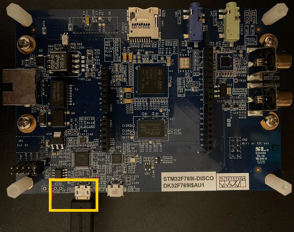

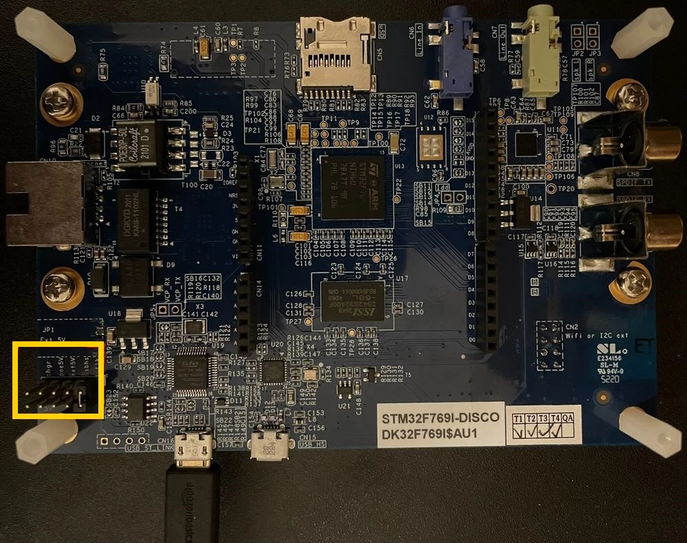

Make sure that all the jumpers on your STM32F769I-DISCO board are in their default position as shown in the below picture. The CN3 jumper should be set to power the board via ST-LINK.
Plug the STM32F769I-DISCO board into your computer using the micro-USB cable. Make sure you plug the micro-USB cable into CN16 on the STM32F769I-DISCO board, which is connected to the on-board ST-LINK debugger/programmer.

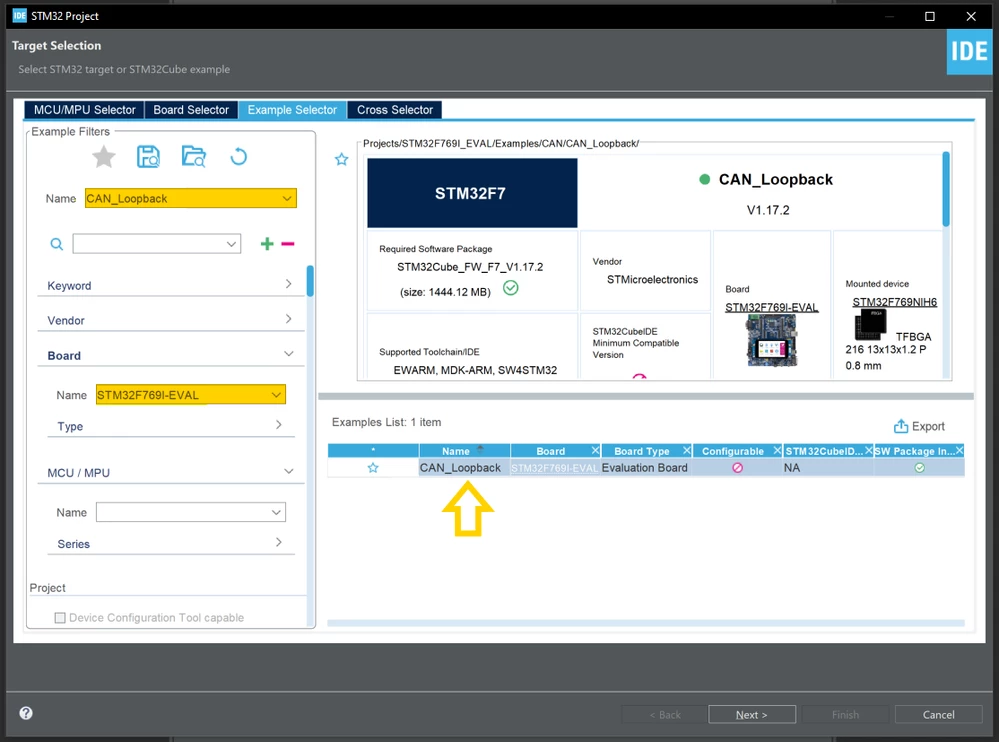

2. Import the example project into STM32CubeIDE
Create a new project in STM32CubeIDE, then use the "Example Selector" tab to search for and select the CAN_Loopback example project for the STM32F769I-EVAL board.
Once the project is imported, click the build icon to compile the project. It is important to verify that the project builds successfully before proceeding.

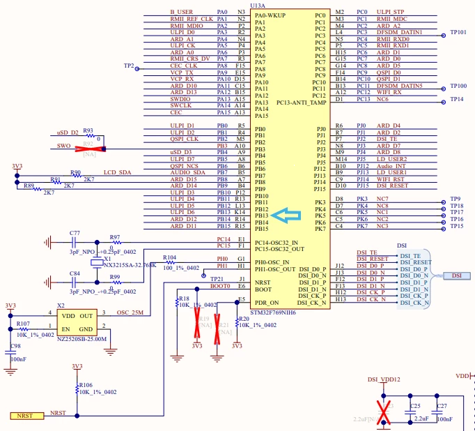

3. Choosing CAN2 pins
You need to check the STM32 MCU’s datasheet to see which GPIO pins can be configured as CAN2 functionality. For the STM32F769I-DISCO board, we have the following pinout options.
Function |
Pinout options |
CAN2_TX |
PB6 or PB13 |
CAN2 _RX |
PB5 or PB12 |
Next, check the board’s schematics to make sure the CAN2 pins are not already reserved for something else. It could be connected to another IC that is being used in the application. For example, in the STM32F769I-DISCO board schematic, PB13 is connected to the ULPI_D6 pin of the USB ULPI transceiver. In this case, you may not want to use pin PB13 for CAN2 purposes if you plan on using the USB ULPI transceiver in your application.
However, for the purposes of this example, it would be ok to use pin PB13 for CAN2 purposes because this CAN_Loopback example project does not use the USB ULPI transceiver.
In this article, we use the following pinout for the STM32F769I-DISCO board.
Function |
Pin |
CAN2_TX |
PB6 |
CAN2 _RX |
PB5 |

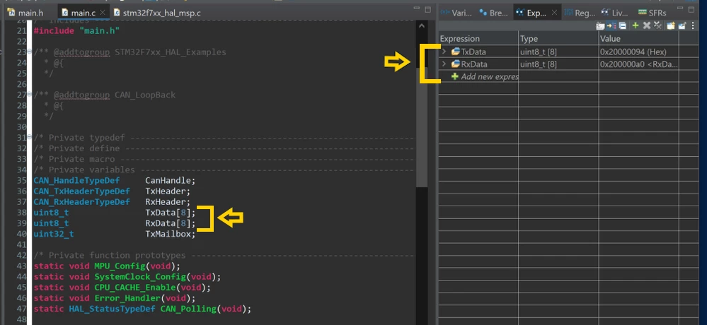

To run the example project, first launch a debug session by clicking the [Debug]
icon.

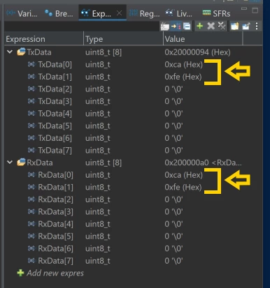

Now, add the CAN2 TxData and RxData variables to the STM32CubeIDE "Expressions" tab so we can see the CAN2 data after it is transmitted.
Run the application by clicking the Run/Resume icon. After a few seconds, click the Pause icon to pause execution of the application so we can view the values of the CAN2 TxData and RxData variables.
Now when we inspect the CAN2 TxData and RxData, we can see that the values ‘0xCA 0xFE‘ were transmitted, and the same ‘0xCA 0xFE‘ values were received. This indicates that the example is working properly on the STM32F769I-DISCO board when using CAN2.
