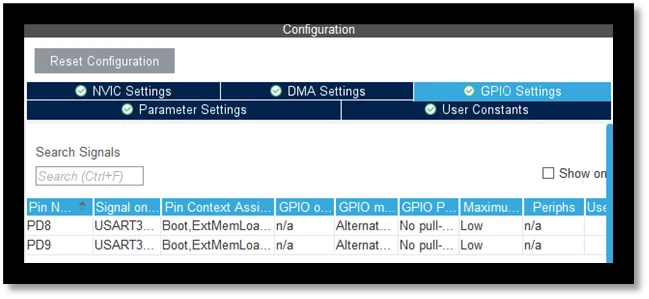

1.2 Pins/alternate function
  • Ensure all relevant GPIOs are set to the correct alternate function and speed.
  • Check for conflicts with other peripherals.

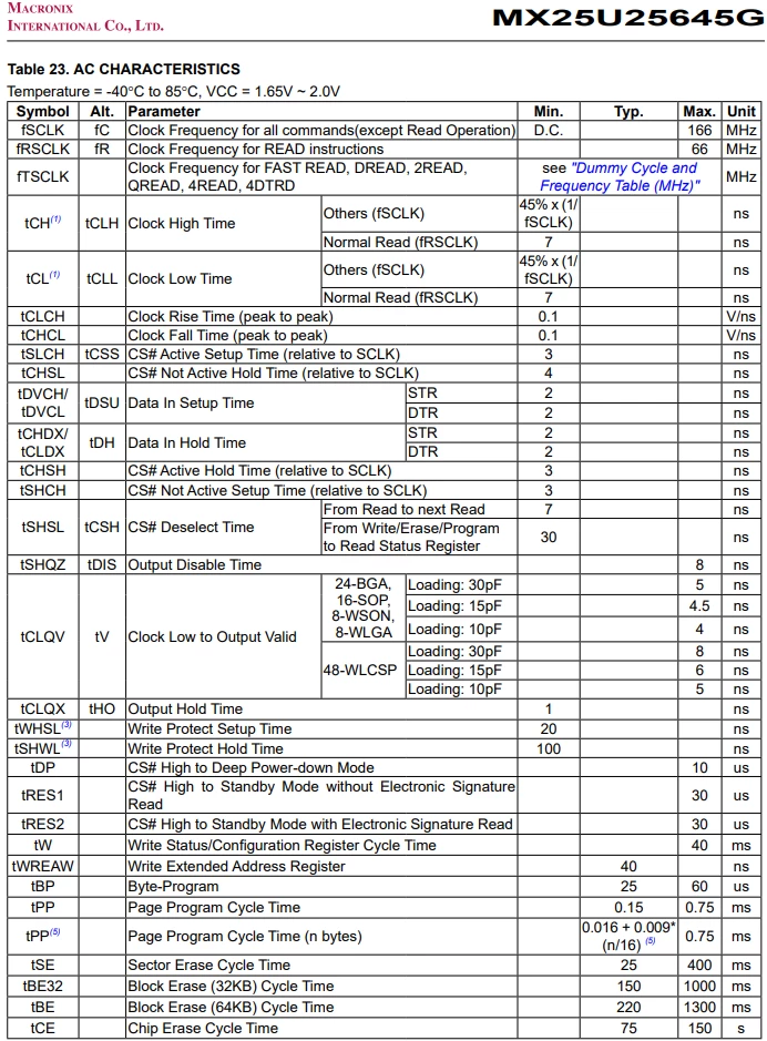

  • Below is an excerpt from the MX25U25645G datasheet (Serial Flash Device) of the AC characteristics (Table 23.) It shows the setup, hold, clock, and data valid times, among others:
1.3.1 Mapping datasheet timing parameters to STM32CubeMX settings

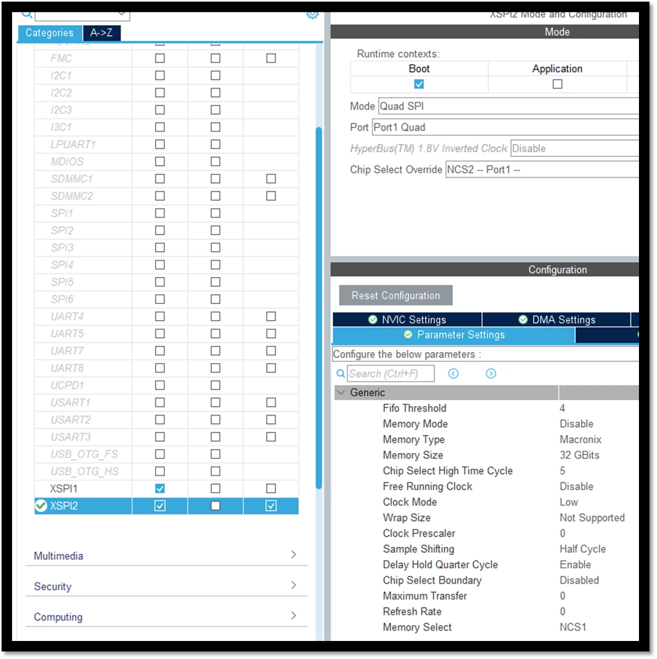

Using the MX25U25645G as an example, here’s a correlation table for NOR FLASH timing parameters and how they map to STM32CubeMX external memory loader, manager, and XSPI settings.
Datasheet parameter
Datasheet symbol/section
Typical value (MX25U25645G)
STM32CubeMX EML/EMM/XSPI setting
Notes
Max SPI clock
fSCLK, Table 23: AC characteristics (see above)
166 MHz
Clock configuration → XSPI
XSPI configuration → clock prescaler
Set XSPI clock ≤ max value. For 133 MHz, prescaler = (kernel clock / 133 MHz) - 1. The XSPI AXI clock (xspi_aclk) has to be greater or equal than the XSPI kernel clock (xspi_ker_ck).

Page program time
tPP, Table 23
Typ 0.15 ms, max 0.75 ms
EML → Program Page Timeout
Set value in STM32CubeMX 1-2ms over the datasheet value for margin. CubeMX default is often much higher (for example, 10 s)
Sector erase time
tSE, Table 23
Typ 25 ms, max 400 ms
EML → Erase Sector Timeout
Set to 500 – 1000 ms for margin. CubeMX default is often much higher (e.g. 6s).
CS# deselect time
tCSH
From Read to next Read 7 ns.
From Write/Erase/Program to Read Status Register 30 ns.
The value depends on your Max SPI Freq; for 166 MHz, set to 5 CLK cycles
XSPI → Chip Select High Time Cycle
CSHT + 1 defines the minimum number of CLK cycles where the chip-select (NCS) must remain high between commands issued to the external device. CS# Deselect time indicates the minimum time CS# must be high between commands.

The XSPIs must provide a clock to the external memory, with a duty cycle distortion generally lower than 5%. To reach this requirement, the kernel clock provided to the XSPIs has a typical duty cycle of 50%.
Data valid after SCK
tV, Clock Low to Output Valid, Table 23
Varies based on memory package and capacitive loading; anywhere from 4 ns to 8 ns
XSPI → Sample Shifting and/or XSPI → Delay Hold Quarter Cycle (DHQC)
In 166 MHz example, Sample Shifting = Half Cycle
DHQC = Enabled
tV tells you how long after the clock edge the NOR Flash guarantees valid data. If the SPI/XSPI clock is fast, you may need to enable Sample Shifting or DHQC in XSPI configuration to delay the sampling point. This ensures the MCU read valid data after tV has elapsed.

XSPI → Mode
EMM → Number of Memory Data Line
XSPI Mode à Quad SPI
EMM à Set to 4 for Quad I/O
SPI mode
Section 1: Features - General
Mode 0 and Mode 3
XSPI → Clock Mode
Low or High
SPI Modes are defined by two parameters, Clock Polarity (CPOL) and Clock Phase (CPHA) that indicate what value means the clock is idle and when data is sampled. Mode 0 has both low, where Mode 3 has both high. As this device supports both, you can use either as long as the master and slave use the same mode.

Find the screenshots of the STM32CubeMX settings for "XSPI", "External Memory Loader", and "External Memory Manager" below:

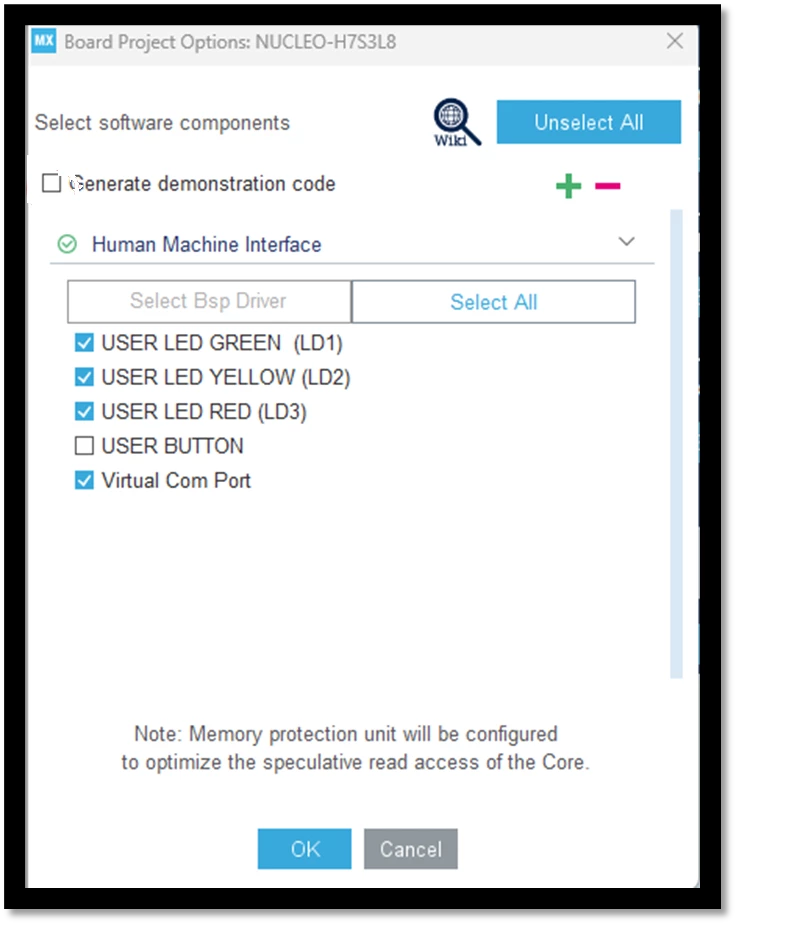

1.7.1 Project setup

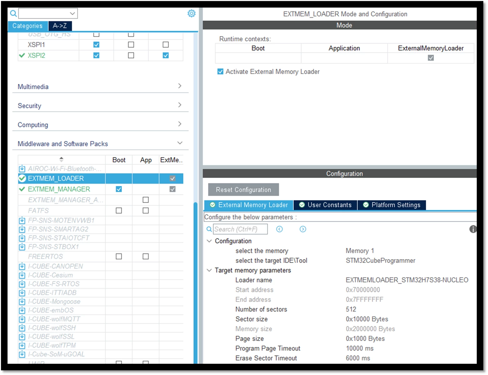

  1. Create a new project in STM32CubeMX for your target board. I chose the NUCLEO-H7S3L8. Ensure the Boot and ExternalMemoryLoader contexts are included in the project.
    Note: Untick "Generate demonstration code" for the Virtual Com Port when given the option.

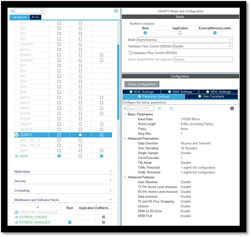

  2. Enable USART3, ensuring the pins are PD8 and PD9 for UART debug output through the Virtual Com Port.EBowdach_5-1765920891588.png EBowdach_6-1765920891591.png

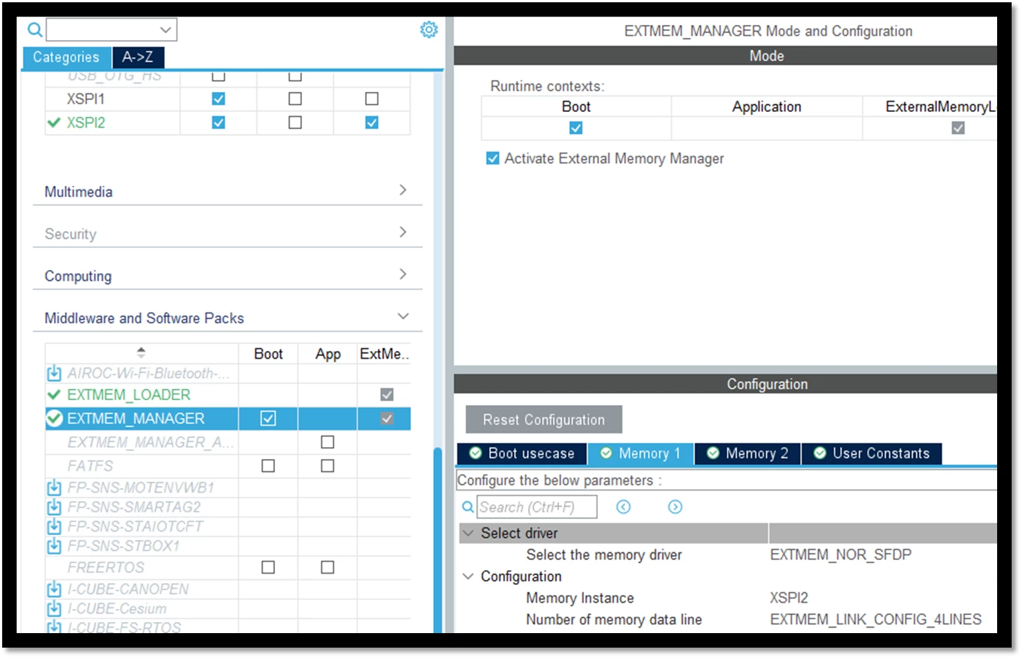

  3. Enable XSPI2 for external memory interface. Refer to the example above, however for the memory on the NUCLEO-H7S3L8, octo-SPI is supported, so update accordingly.
  4. Configure External Memory Manager (EMM), refer to the example above. However, the memory on NUCLEO-H7S3L8 can operate in quad-SPI or octo-SPI, so you can update the lines accordingly.
  5. Enable External Memory Loader. The loader name can be customized to your project.
  6. Generate code for your IDE; I chose STM32CubeIDE.

  1. Confirm USART3 initialization and USART3 GPIO initialization.
  2. Add retargeting function to redirect printf to UART in extmemloader_init.c (ExtMemLoader project Core/Src).

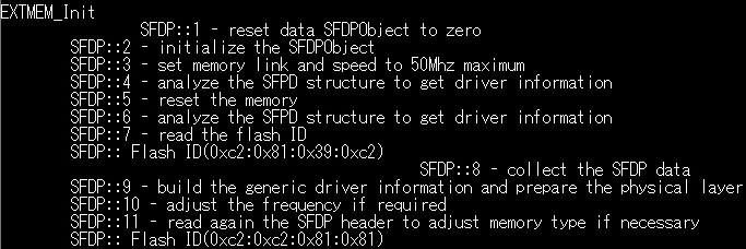

  1. Minimal tests, breakpoints, and verify output in a serial terminal like Tera Term (correct COM port, 115200 baud, 8N1).
  2. Here’s the expected output with the external memory initialization using EXTMEM_MACRO_DEBUG as described above:
Now, you can use this custom external loader for your Boot and Appli projects!
