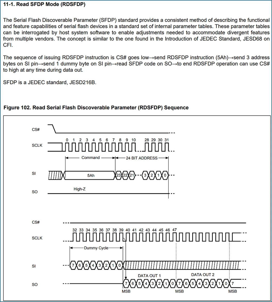

1.2 Industry standards
Industry standards are essential when integrating external memory with STM32 MCUs, ensuring interoperability and simplifying design. They define common interfaces and protocols, enabling confident selection from various vendors. Leveraging these standards allows developers to use robust middleware and reference designs, making integration more reliable and future-proof. Below are some key industry standards that exist today:
- JEDEC SFDP (Serial Flash Discoverable Parameters):
- Standard for NOR flash devices.
- Allows MCUs to automatically detect memory features and supported commands for seamless integration.
- ONFI (Open NAND Flash Interface):
- Common protocol for NAND flash devices.
- Defines command sets, timing, and parameter pages for interoperability across vendors.
- JEDEC SDRAM/PSRAM standards:
- Specifies initialization sequences, timing, and electrical characteristics for SDRAM and PSRAM.
- Ensures compatibility with memory controllers like STM32’s FMC.
- SPI, QSPI, OPI, and HyperBus protocols:
- Standardized serial interfaces for high-speed RAM and flash (e.g., SPI, quad-SPI, Octa SPI, HyperBus).
- Enable efficient communication with MCUs equipped with matching peripherals.
Selecting external memories that comply with these standards ensures broad compatibility, easier debugging, and access to proven software and hardware resources. As an example, here is a link and a snippet from the MX25U25645G datasheet, a 1.8 V, 256M-BIT CMOS NOR Serial Flash Memory, of the memory’s Read SFDP Mode. This memory is similar to the memory used on the NUCLEO-H7S3L8 board, MX25UW25645G. The MX25U25645G memory device complies with JEDEC standards for Serial Flash Discoverable Parameters (SFDP), which provide a standardized method to describe memory characteristics and timings.

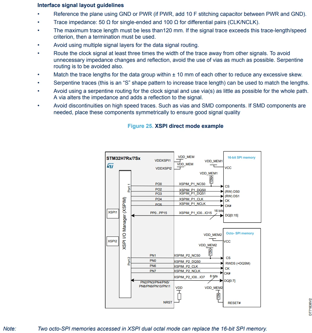

2.6 PCB layout
- Keep high-speed traces short, matched in length, and routed with controlled impedance.
- Avoid stubs, sharp corners, and crossing split ground planes.
- Separate analog and digital grounds.
- AN5935 has more details on PCB layout guidelines for high speed signal layouts for SDMMC, FMC, XSPI in section 10.4 (for the STM32H7R/S), please see XSPI details from section 10.4.3 below:
