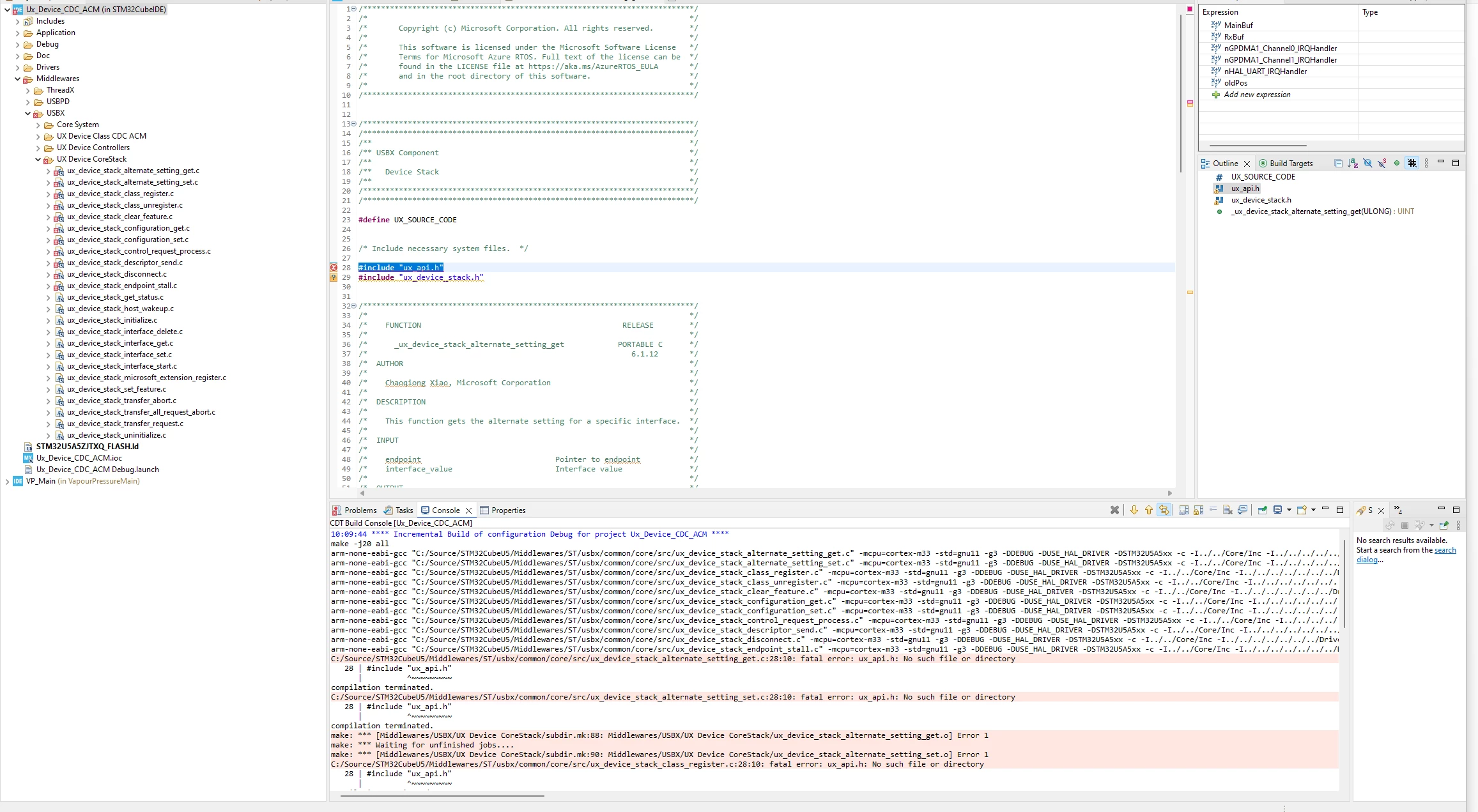

Mar 18, 2025 10:12 AM UTC
This is the result what is wrong?
Regards
David.
D.Botelho

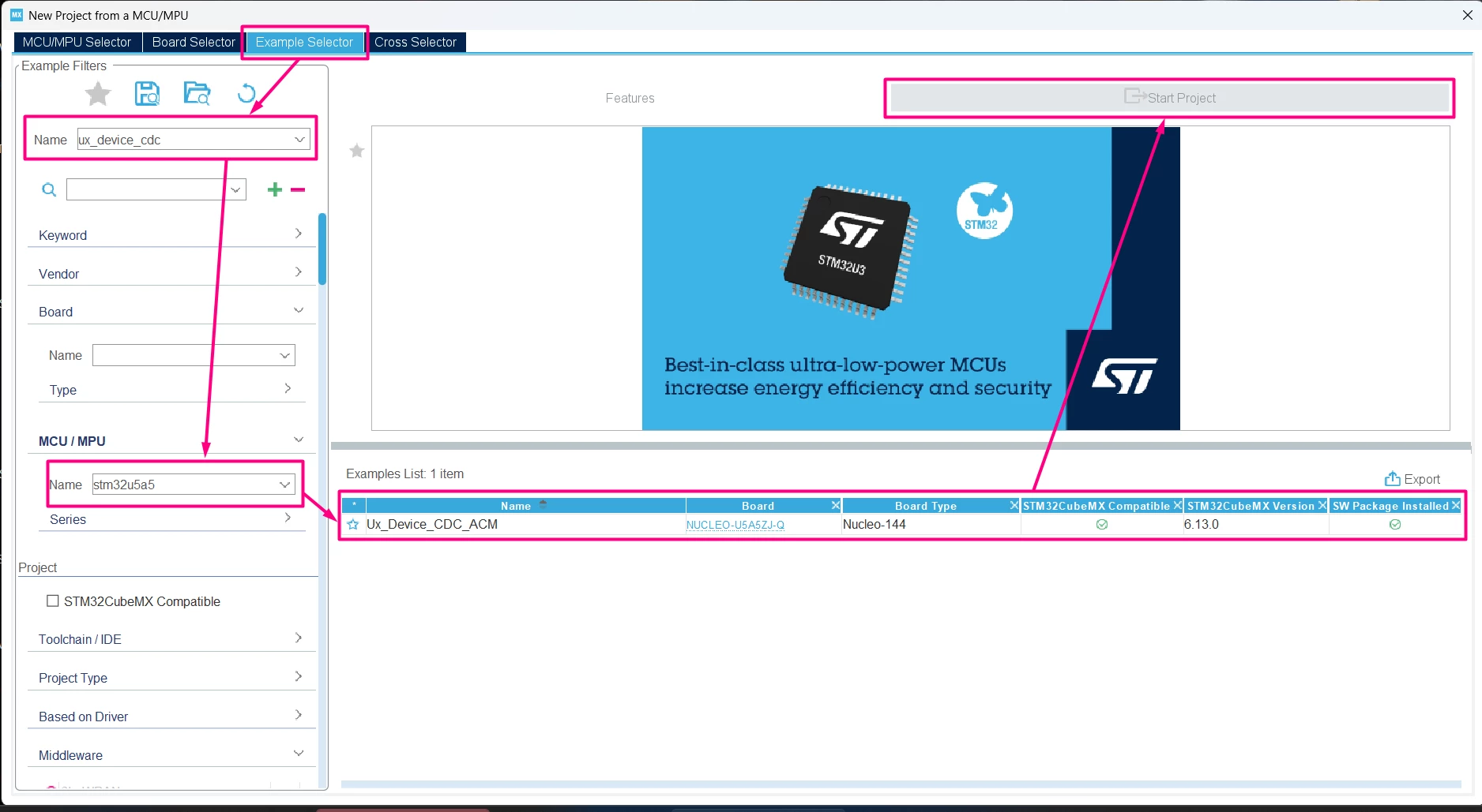

Mar 18, 2025 10:51 AM UTC
Hello @DavidRi,
Let's try importing in a different way. When creating a new project in the STM32CubeIDE, in the MCU selector, navigate to the Example Selector menu, search for the demo and MCU, and finally start the project. It will import the files in the right way, avoiding compilation issues.
Hope it helps!
Best Regards,
Dan

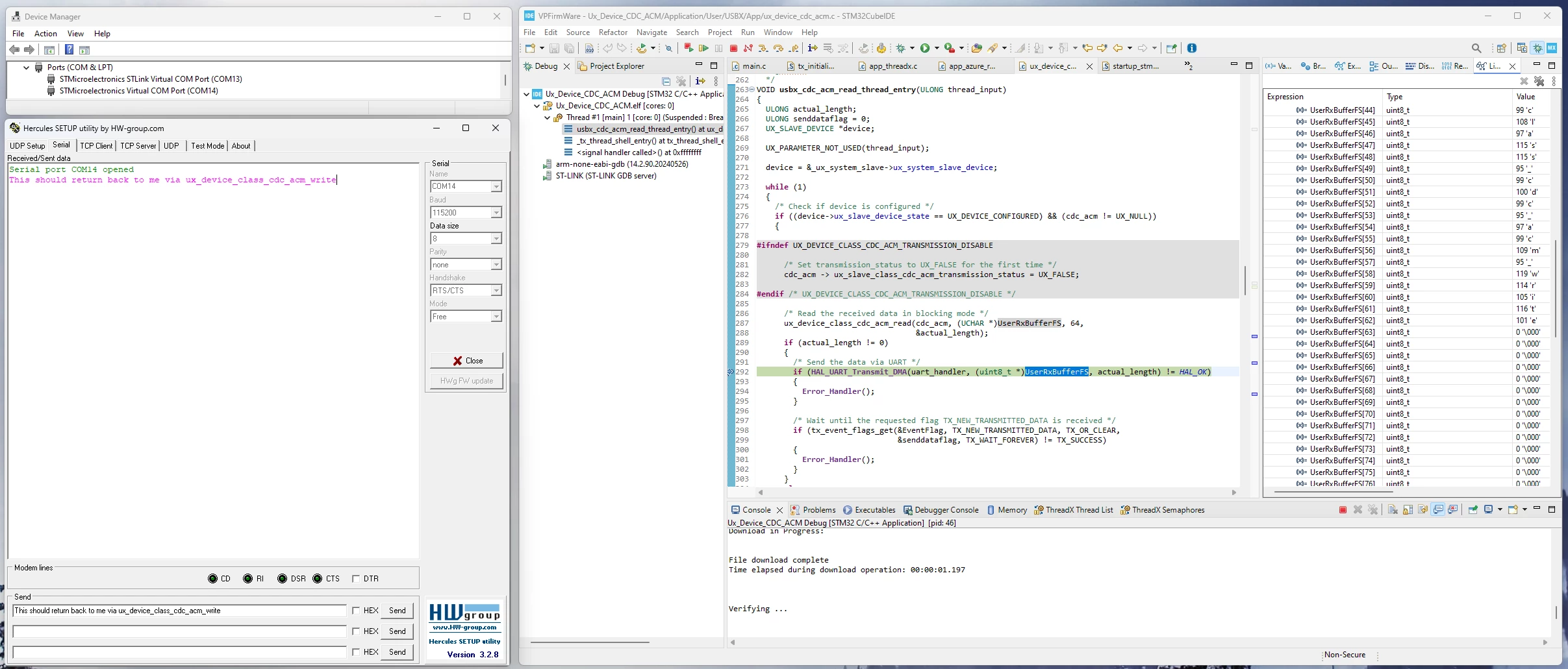

Mar 18, 2025 12:05 PM UTC
Thanks Dan that building and running now.  However it does not transmit back my receive buffer, when sent back from beyond the breakpoint indicated below...
Regards
David.
D.Botelho
Mar 18, 2025 1:11 PM UTC
Hello @DavidRi ,
The purpose of this demo is to act as a UART to USB bridge. So, the data you send through UART will appear in the USB VCom, and the data sent through VCom will appear in the USB. The used UART is connected to the ST-LINK VCom port. Therefore, this demo will use the two VCOM Ports available in your board. The first one is the ST-LINK VCOM Port, and the second one is your USB CDC ACM Application.
To see the complete demo working, you should open two VCom terminals, one for the ST-LINK and the other for the USB CDC ACM. Then, when you send a data through a terminal, this data should be echoed in the second terminal.
Best Regards,
Dan
Mar 18, 2025 1:47 PM UTC
Thanks for this, this is exactly what is happening, however I want to receive and transmit on the virtual com port only (COM 14 in my case).  How would I do this?
Regards
David.
