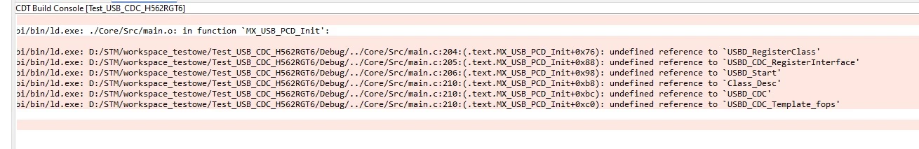

Once the code is generated, create a source folder in your project called USB.
Download the USB Device package from the GitHub (the same link presented in the introduction of this article). Open the software pack folder and import the Core folder into the created ‘USB’ folder.

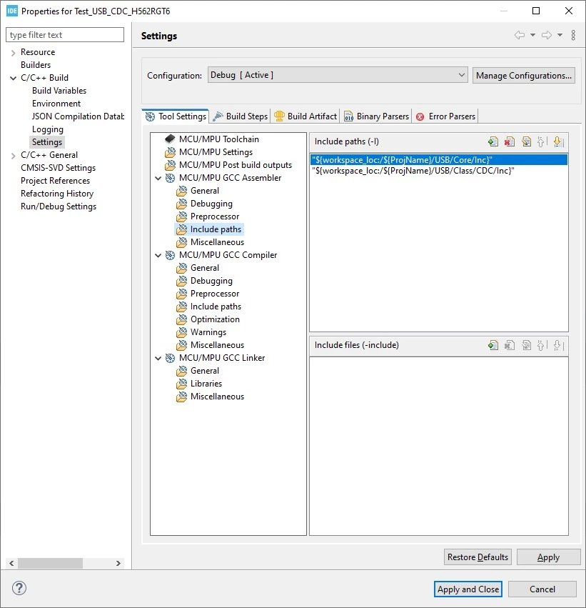

Now, create another folder called ‘Class’ and import the desired classes to your project, in this case, the CDC is the only one selected.
Add the path to the include reference. Right click in the ‘Inc’ folder inside the USB/Class/CDC/.. path, then select `Add/remove include path…` option, and in the pop-up menu, press OK. Perform the same steps for the USB/Core/Inc as well.
Make sure to rename the USB/Core/Inc/usbd_conf_template.h and USB/Core/Src/usbd_conf_template.c files to usbd_conf.h/.c. After doing so, open the usbd_conf.h. In this file, we need to replace the HAL driver header file name according to the MCU Family we are using. In this case, the STM32H503 is being used, so the include is as follows:

Hello everyone,
I'm trying to run the example from this thread, but I'm getting the errors shown in the attachment. I've added the paths to the Inc folders. The processor is H562RGT6, Cube v1.18.1, Repository v1.5.0. What am I doing wrong?error.jpgpaths.jpg
