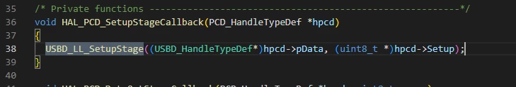

Then, we need to implement the PCD Callbacks and populate as follows:
/* Private functions ---------------------------------------------------------*/
void HAL_PCD_SetupStageCallback(PCD_HandleTypeDef *hpcd)
 USBD_LL_SetupStage((USBD_HandleTypeDef*)hpcd->pData, (uint8_t *)hpcd->Setup);
void HAL_PCD_DataOutStageCallback(PCD_HandleTypeDef *hpcd, uint8_t epnum)
 USBD_LL_DataOutStage((USBD_HandleTypeDef*)hpcd->pData, epnum, hpcd->OUT_ep[epnum].xfer_buff);
void HAL_PCD_DataInStageCallback(PCD_HandleTypeDef *hpcd, uint8_t epnum)
 USBD_LL_DataInStage((USBD_HandleTypeDef*)hpcd->pData, epnum, hpcd->IN_ep[epnum].xfer_buff);
void HAL_PCD_SOFCallback(PCD_HandleTypeDef *hpcd)
 USBD_LL_SOF((USBD_HandleTypeDef*)hpcd->pData);
void HAL_PCD_ResetCallback(PCD_HandleTypeDef *hpcd)
 USBD_SpeedTypeDef speed = USBD_SPEED_FULL;
 if ( hpcd->Init.speed != PCD_SPEED_FULL)
 Error_Handler();
 /* Set Speed. */
 USBD_LL_SetSpeed((USBD_HandleTypeDef*)hpcd->pData, speed);
 /* Reset Device. */
 USBD_LL_Reset((USBD_HandleTypeDef*)hpcd->pData);
void HAL_PCD_ConnectCallback(PCD_HandleTypeDef *hpcd)
 USBD_LL_DevConnected((USBD_HandleTypeDef*)hpcd->pData);
void HAL_PCD_DisconnectCallback(PCD_HandleTypeDef *hpcd)
 USBD_LL_DevDisconnected((USBD_HandleTypeDef*)hpcd->pData);

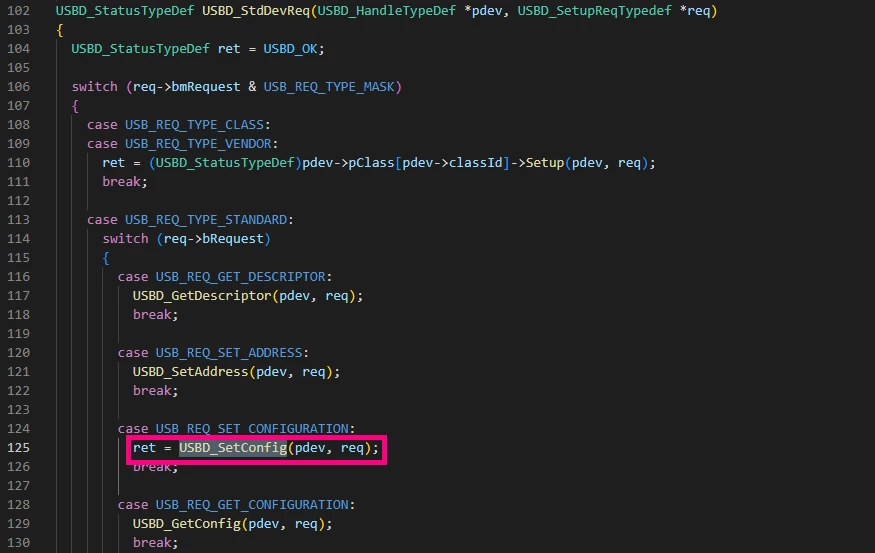

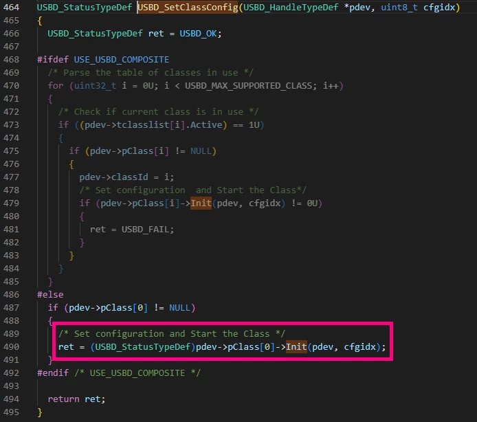

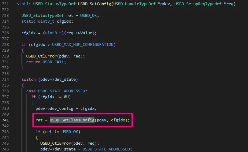

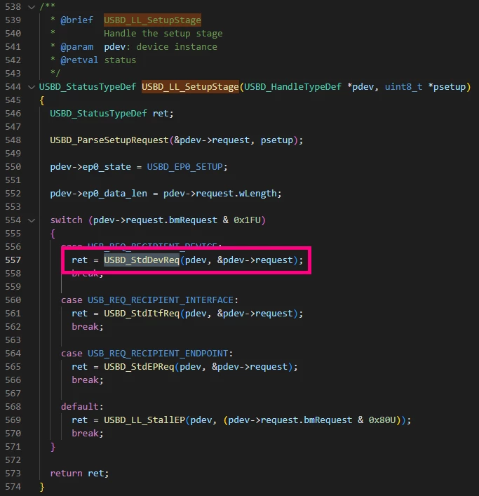

When you connect the USB to your computer, it will start communicating to negotiate all the needed information to stablish the communication. During this phase, a Setup Stage will be issued to the Device side. At this time, the code will fall in the following callback:
Going through:
Again...:
And finally:
At this point, the USBD_CDC_Init(..) function will be called, fill the pClassData information and your application will be ready to go!
Given that, you know all the expected flow to get the communication working and pass through the strange while.

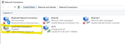

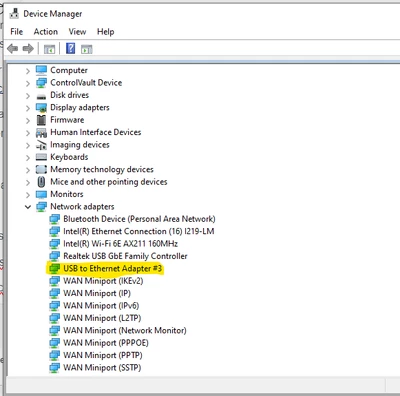

@B.Montanari
I hope this email finds you well. I am reaching out to discuss a technical challenge we are facing with the STM32L072CZY3TR microcontroller. Our goal is to implement Ethernet over USB functionality.
From my research, I understand that the CDC-RNDIS or CDC-ECM protocol can be used to carry Ethernet frames over USB, creating a virtual network connection.
so, for that I used the stack from STM32 GitHub repository. "GitHub - STMicroelectronics/stm32_mw_usb_device at 2022e75b01a499b17acd17d28691b1ed5bbef2dc"
but I landed with an issue where USB port is detecting network adaptor in device manger but disabled in network sharing options.
so please suggest some other approach to meet the ethernet over USB functionality or how to clear the issue.
