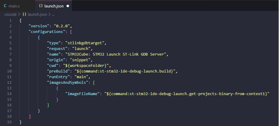

Debug the application:
  • Open the [Run and Debug] panel (Ctrl+Shift+D).
  • Create a new debug configuration by clicking [create a launch.json file.]
  • Select [STM32Cube: STLink GDB Server].
This generates a launch.json file configured for your STM32 project.
  • Start the debug session by pressing F5 or clicking the green [Start Debugging] button.
  • The debugger halts at the reset vector or the first breakpoint.
