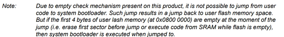

This article will not cover the workaround of erasing the first page, but the code will have all STM32s addresses in it to facilitate the implementation, in case the reader wants to use it. We do suggest reading this article that explains how to execute code from SRAM.

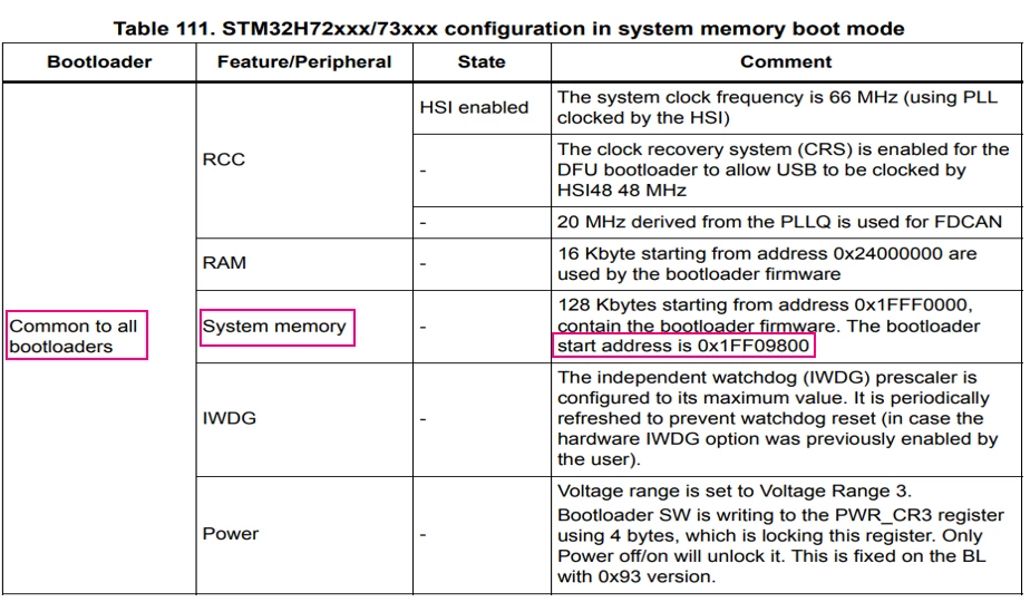

1. How to find System Memory / Bootloader Start Address value:
Refer to AN2606 “Configuration in System Memory Boot Mode” tables. Each device will have a specific System Memory/Bootloader address, and this value must be known to jump to bootloader correctly.
For example, for the STM32H723ZG microcontroller (a quick article showing the code for this series is available here), the Bootloader doesn’t start from the same address as the System Memory, but this is clearly defined in Table 111.

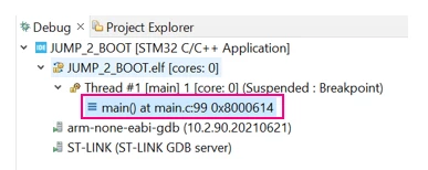

2.1. STM32CubeIDE debugging tab.
You can check whether the PC is set to the Flash or Boot address in the debug tab on the top left corner of the debug perspective. At first, the PC starts in Flash address: 0x08000614 (for this particular demo).
After entering the Bootloader, the PC is now set to an address inside the Boot region: 0x1FF127BC. You can see the tab below after hitting “pause” button.

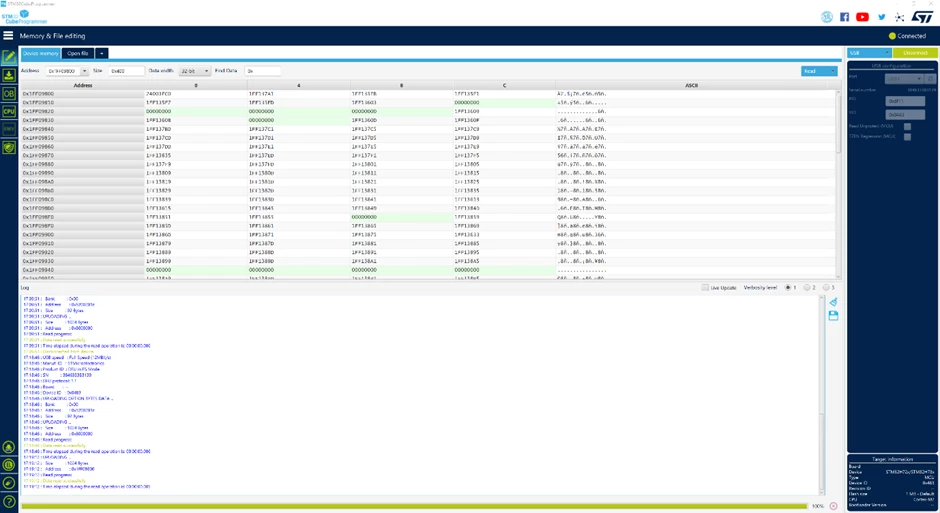

2.2. STM32CubeProgrammer Tool
Once within the Bootloader region, we can use the STM32CubeProg to guarantee that the system is working in system boot mode.
For this tutorial, we will use the USB entry point to perform this, but other interfaces available for the given series could be used as well. Just keep in mind that the USB has higher priority than the others, so if the cable is connected it will be the one selected. The AN2606 covers all of this peripherals and needed settings for all series.
Obs.: Please pay attention to the pins specified in the AN2606, because even if the STM32CubeIDE allows the pin reallocation, to enter in bootloader the pins must be the same as in the Application Note.

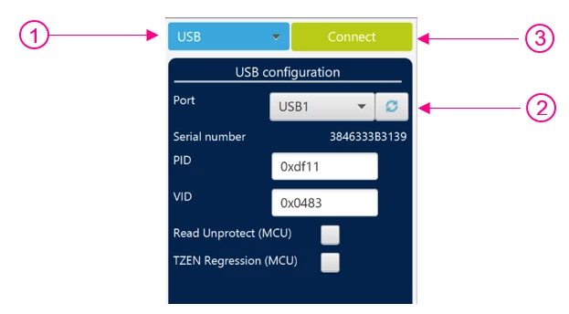

To execute this over USB, connect the USB cable on the User USB connector. After that:
- In the right corner, select USB instead of ST-LINK
- Refresh the Port to recognize the USB
- Hit “Connect”
After connecting,  search for the Bootloader start address and you will see something similar to the following image.
You have now successfully jumped to bootloader from the application. Well done!

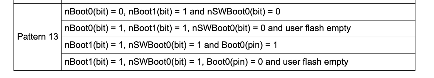

@EThom.3thanks for your answer. So for you if I've not access to BOOT0 pin it's not a problem for jump to bootloader from software ?
Because in AN2606 for my microcontroller, it's say The STM32WLE5xx/55xx bootloader is activated by applying Pattern 13, here is the pattern 13
On this pattern we can see BOOT0...
EThom.3
Senior II
Sep 29, 2023 12:33 PM UTC
@SBaro.11
Yes, the main point of jumping to the bootloader from from software is to avoid the need to use BOOT0. I have both options in my latest board. For my customer, it is much more practical to activate the bootloader from software.
The microcontrollers I use are activated by other patterns in that table. But that doesn't mean that it's the only way to activate the bootloader.
In my version of AN2606 (rev. 56), your microcontroller is listed in chapter 72. The bootloader code starts from address 0x1FFF0000. So I guess that you can use the code example in this post the same way as I did. You just don't need to disable the USB port, as I needed to do.
