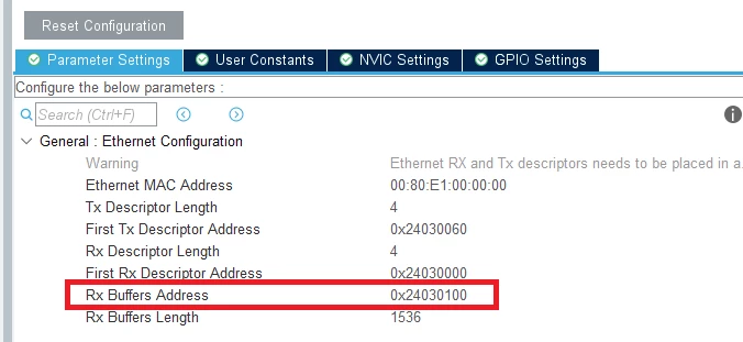

In the connectivity tab, both the Ethernet and USART3 peripherals are used. Ethernet is the focus of this application, and the serial port is used for debug purposes, such as application flow and IP address handling.
RMII Ethernet mode must be enabled. Configure the Rx buffers length to the maximum value and the first descriptor addresses must be set as such:
Figure 5 – Ethernet configurationFigure 5 – Ethernet configuration
Lastly in the Ethernet tab, navigate to the NVIC settings tab and check the Ethernet global interrupt enable box.

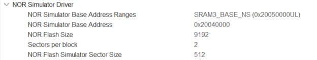

1.1.2.1 LevelX Configuration
LevelX is used in this application to simulate a NOR driver in the microcontroller’s internal memory.
Figure 11 – LevelX ConfigurationFigure 11 – LevelX Configuration
We must configure the base address of the simulated NOR driver to 0x08100000, its size to 1 MB and sectors to two, as the picture shows. The html files are stored at this address.

1.2.6 STM32H753ZITX_FLASH.ld
The last file to be modified is the flash linker descriptor. Before doing that, it's necessary to check the name of the descriptor sections generated by the STM32CubeMX. The STM32CubeMX versions before the v6.13.0 generates the section names with typos (RxDecripSection instead of RxDescripSection, the same for the Tx) that were already corrected in the new releases (equal or higher than v6.13.0) of the STM32CubeMX. Therefore, it's necessary to verify the correct sections names to proper locate the variables into the memories. The correct names are presented in the main.c file.
STM32CubeMX versions before v6.13.0:
Figure 21 - Main.c file with the older version of STM32CubeMXFigure 21 - Main.c file with the older version of STM32CubeMX
STM32CubeMX versions from v6.13.0 onwards:
Figure 22 - Main.c file with the new version of the STM32CubeMXFigure 22 - Main.c file with the new version of the STM32CubeMX
After checking the sections names, paste the following code in linker file at line 165, this code is responsible for creating a few memory locations to hold both descriptors and memory pool sections.
.tcp_sec 0x24030000 (NOLOAD) : {
. = ABSOLUTE(0x24030000);
*(.RxDecripSection)
. = ABSOLUTE(0x24030060);
*(.TxDecripSection)
} >RAM_D1 AT> FLASH
.nx_data 0x24030100 (NOLOAD):
. = ABSOLUTE(0x24030100);
*(.NxServerPoolSection)
. = ABSOLUTE(0x24034100);
*(.NetXPoolSection)
} >RAM_D1 AT >FLASH
*(.RxDescripSection)
*(.TxDescripSection)
} >RAM_D1 AT> FLASH
*(.NetXPoolSection)
} >RAM_D1 AT >FLASH

Mar 6, 2025 2:49 PM UTC
For anyone interested in running this demo in the most recent version of STM32CUBEIDE and STM32CUBEMX, some modifications may be necessary:
The Ethernet Descriptor changed names from RxDecripSection to RxDescripSection and from TxDecripSection to TxDescripSection. Therefore, a modification in the Linker Script is necessary:
} >RAM_D1 AT> FLASH

Finally, it is always recommended to double-check if the Ethernet pins are correctly assigned in the IOC file. Refer to your board schematics to ensure correct assignments.

Trouble 2:
An example of parameters that works differently is the NOR Simulator Driver :
In this case, I am not able to indicate the FLASH base address (0x08000000 or 0x08100000) into NOR Simulator Base Address, to link the binary file stored in the FLASH memory and get stuck with SRAM base addresses. While the binary file of the web content is about 1Mb, I cannot link this file to LEVELX middleware as asked in the tutorial. The STM32H563 has 640kb of SRAM and 2Mb of FLASH.
Thank you in advance for your answer and don't hesitate to ask more informations, if my explanation misses some.
