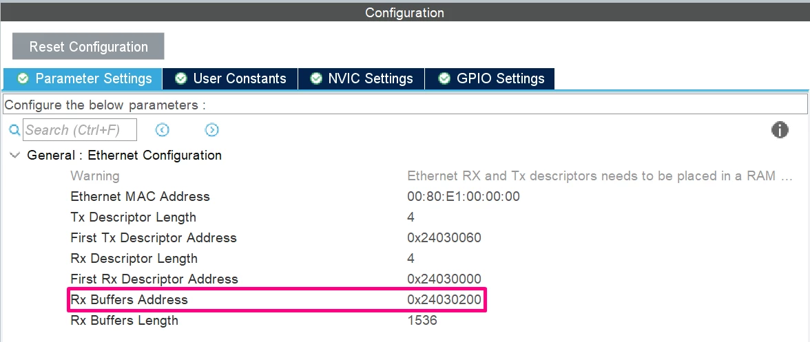

In the connectivity tab, both the Ethernet and USART3 peripherals are used. Ethernet is the focus of this application, and the serial port is used for debug purposes, such as application flow and IP address handling.
RMII Ethernet mode must be enabled. Configure the Rx buffers length to the maximum value and the first descriptor addresses must be set as such:
Figure 5 – Ethernet configurationFigure 5 – Ethernet configuration
Lastly in the Ethernet tab, navigate to the NVIC settings tab and check the Ethernet global interrupt enable box.

1.2.6 STM32H753ZITX_FLASH.ld
The last file to be modified is the flash linker descriptor. Before doing that, it's necessary to check the name of the descriptor sections generated by the STM32CubeMX. The STM32CubeMX versions before the v6.13.0 generates the section names with typos (RxDecripSection instead of RxDescripSection, the same for the Tx) that were already corrected in the new releases (equal or higher than v6.13.0) of the STM32CubeMX. Therefore, it's necessary to verify the correct sections names to proper locate the variables into the memories. The correct names are presented in the main.c file.
STM32CubeMX versions before v6.13.0:
Figure 21 - Main.c file with the older version of STM32CubeMXFigure 21 - Main.c file with the older version of STM32CubeMX
STM32CubeMX versions from v6.13.0 onwards:
Figure 22 - Main.c file with the new version of the STM32CubeMXFigure 22 - Main.c file with the new version of the STM32CubeMX
After checking the sections names, paste the following code in linker file at line 165, this code is responsible for creating a few memory locations to hold both descriptors and memory pool sections.
.tcp_sec 0x24030000 (NOLOAD) : {
. = ABSOLUTE(0x24030000);
*(.RxDecripSection)
. = ABSOLUTE(0x24030060);
*(.TxDecripSection)
} >RAM_D1 AT> FLASH
.nx_data 0x24030100 (NOLOAD):
. = ABSOLUTE(0x24030100);
*(.NxServerPoolSection)
. = ABSOLUTE(0x24034100);
*(.NetXPoolSection)
} >RAM_D1 AT >FLASH
*(.RxDescripSection)
*(.TxDescripSection)
} >RAM_D1 AT> FLASH
*(.NetXPoolSection)
} >RAM_D1 AT >FLASH

Hello @jfresneda and @UnderCaffeinated,
I tested the demo allocating the RX Buffers Address in 0x24030200 and, later in, 0x24030100, the application ran as expected. So long as you leave enough space for the Descriptors the application should work.
Best Regards

At this point, I feel very dumb. I have spent an incredible amount of time trying to get this to work.
Currently my setup is  NUCLEO-H753ZI using Cube MX version 6.16, STM32Cube_FW_H7_V1.12.1, and configured the xcube-azrtos-h7 with V3.1.0
I was unable to get the example configuration working with the memory pointing to D1 and eventually managed to get the DHCP to work by changing it to D2. As a newbie, setting up all the memory settings is really a challenge, and it's even more so when an example from you doesn't work out of the box...
Now I can consistently have the DCHP working (I can also ping the device in case I remove some functions that don't go to the error handler.
The issue I'm facing now is:
FX media opening failed : 0x03
 I agree with @Mikey that, considering the rather complex configuration, it would be nice to have a working example.
Any suggestion is welcome :)
