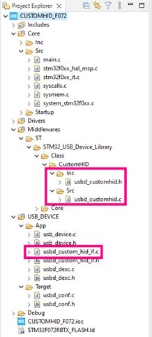

Among the several files created automatically, the highlighted ones are modified during this tutorial, so you might want to open them preemptively:

Open the usbd_customhid.c file and modify the following functions:

          Open the usbd_custom_hid_if.c and add the following information in Usb HID report descriptor (if you need more information regarding the report descriptor, refer the documentation available in Information for Developers | USB-IF:(

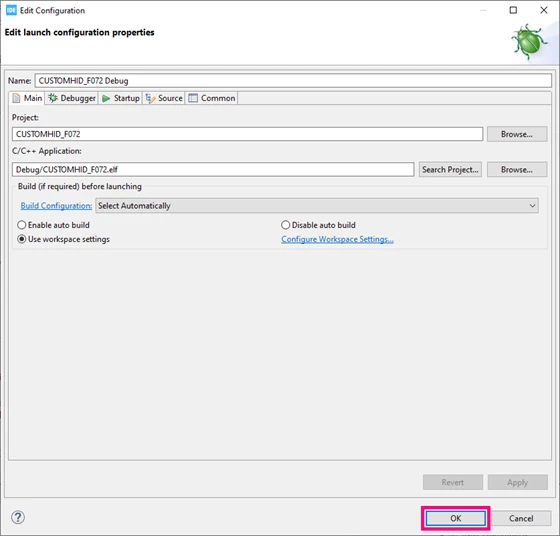

2. Validation

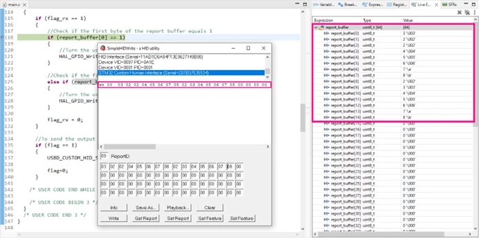

Start a debug session with the created project with STM32CubeIDE by clicking in the Debug button:
A window may appear to ask for some settings about the Debugger, for this example the standard settings work well. So, just click on Ok:
Run the execution clicking Resume button or pressing F8:

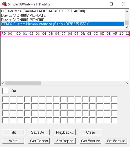

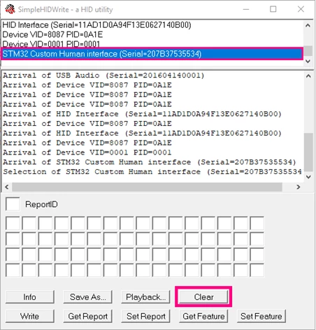

Open the SimpleHIDWrite software, select the STM32 Custom Human interface in the list, then click on Clear button to clear the terminal:
Press the User Button on the Discovery Board and check that the buffer sent to host on terminal. It is the buffer with the sequence from 0 to 63U (0x3F):

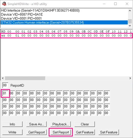

Fill the first field with the value 1, click on Set Report button and check that the Red LED turned ON (change the first value to 2 and send the report again to turn OFF the LED):533.png
Finally, insert a breakpoint on some line between the if statement of main.c that checks the flag_rx, fill the fields of the SimpleHIDWrite with random data, set a report and check the value of the report_buffer on STM32CubeIDE:
