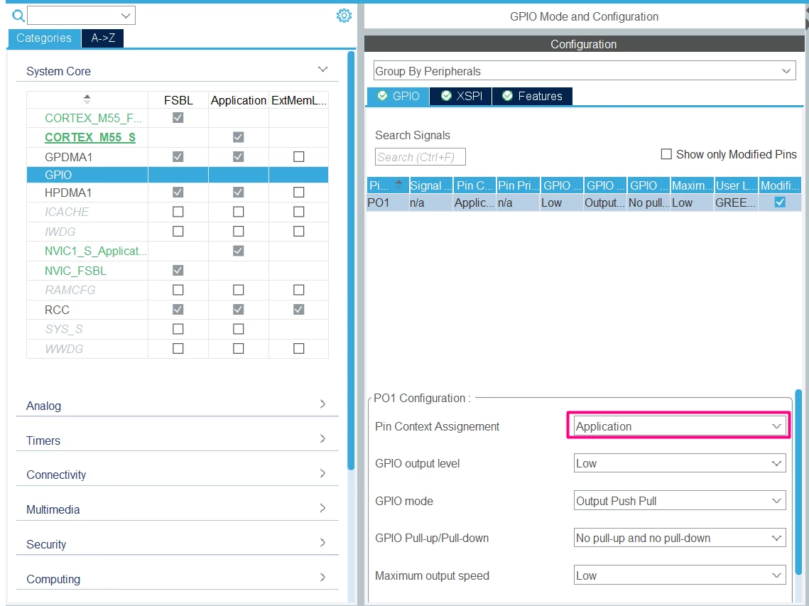

2.1.1 Configure the LED pin
The project needs to configure a few peripherals to work properly, including the green LED, associated with the PO1 and its active HIGH and the external memory connected to XSPI2.
Start by creating a new project using the STM32CubeMX and select the [STM32N657X0H3Q]. Select the option to use the [Secure Domain only].
Locate the PO1 and configure it as GPIO_Output and use the label to name it [GREEN_LED].
We need to assign the GPIO to be used by the application.

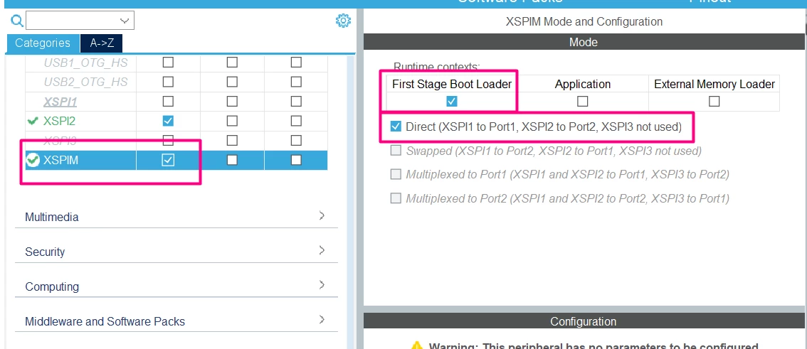

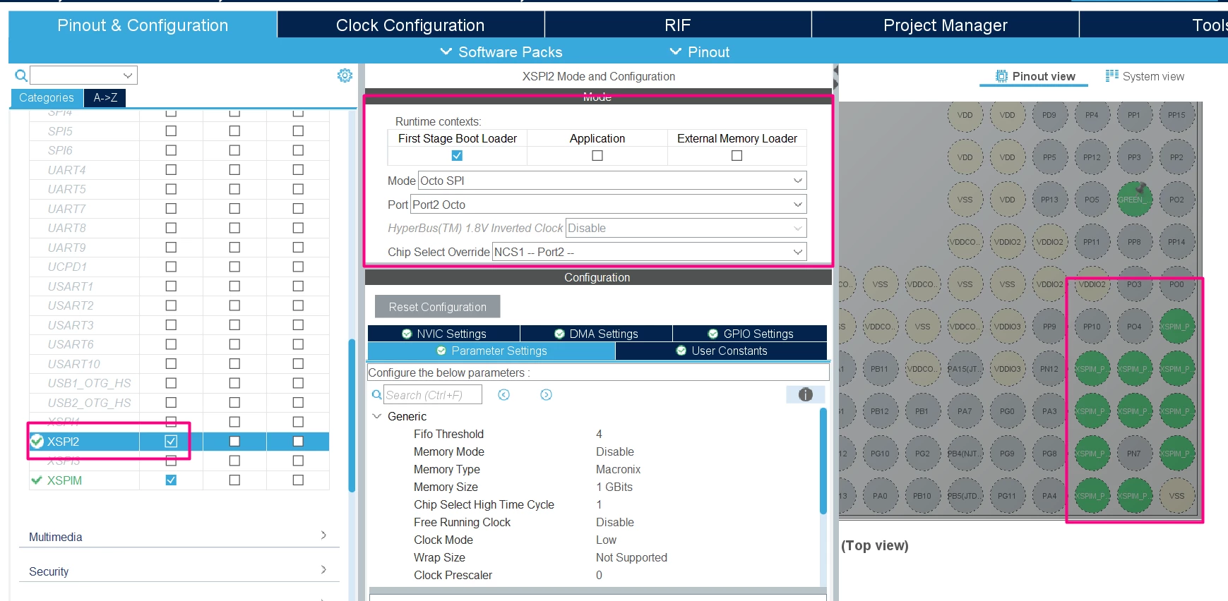

2.1.2 Configure the XSPI and XSPIM
Locate the [XSPIM] on the left side under the "Connectivity" menu, and select it to run during the [First Stage Boot Loader] and have the [Direct] mode selected:

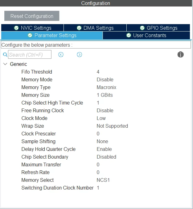

The Octo‑SPI flash memory has the following characteristics: 1 Gbit, 1.8 V, 200 MHz, DTR, read while writing. It’s connected to the OCTOSPI interface of the STM32N657X0H3Q microcontroller on the STM32N6570-DK board on XSPI2. With that information, go to XSPI2 to configure the peripheral according to the hardware available:
As for the [Parameter Settings], look carefully at the image below:

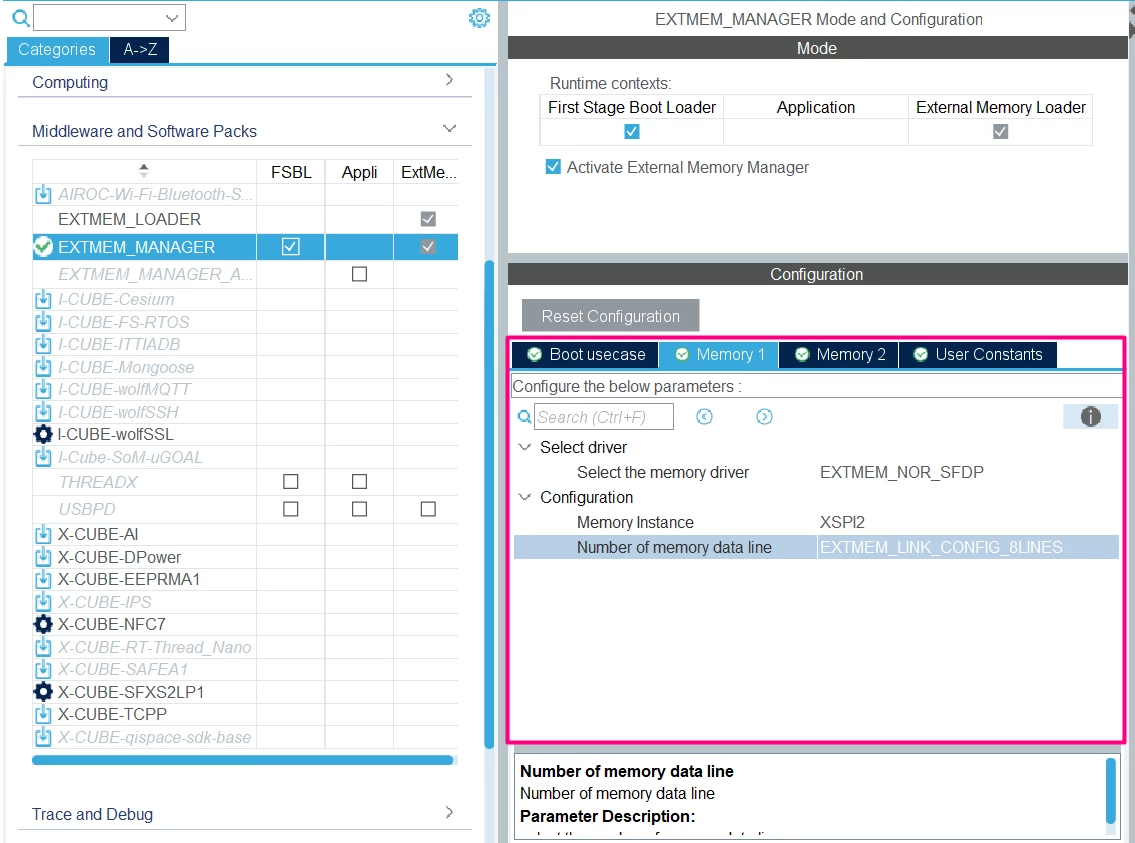

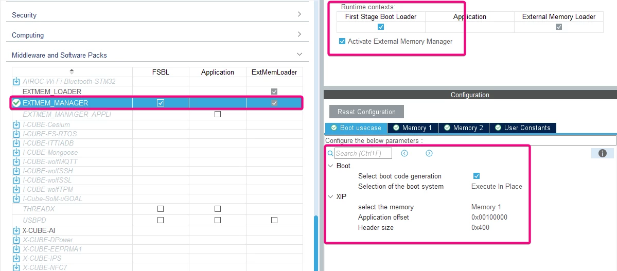

2.1.3 Configure the EXTMEM_MANAGER
The next step is locating the [Middleware and Software Packs] in the [Categories] and expand the [EXTMEM_MANAGER]. Add the [First Stage Boot Loader] and the [Activate External Memory Manager] checkbox, using the following settings:
[XiP Application offset] = 0x00100000
[XiP Header size] = 0x400
In the [Memory 1] tab, ensure that the configuration is as follows:

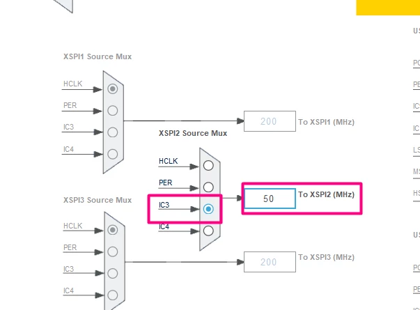

2.1.4 Configure the XSPI clock
The last step for the XSPI is to configure its clock. We set the XPI clock to 50 MHz for this example. To achieve higher speeds up to the 200 MHz supported by this serial NOR FLASH, you need to make changes to OTP for I/O speed optimization. This isn’t covered in this article. Go to the [Clock Configuration] tab and have the IC3 as the source for the XSPI2 and type 50 and press enter for the clock to be automatically adjusted:
Proceed with the code generation for both projects.

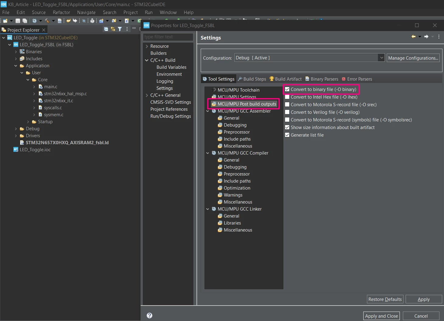

Make sure that your project settings are configured to generate the *.bin as well, since we’ll use it to run the scripts:

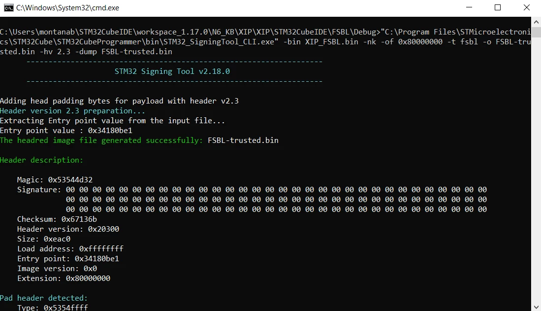

2.1.6 Adding the header
We need to add the FSBL header to ensure that the boot ROM is capable of reading and copying it from the external memory. Also, that the same header is added for the application. To do this, we use the STM32CubeProgrammer’s CLI. The next assumes the STM32CubeProgrammer was installed in the default path, if not, make sure to adjust it accordingly.
To facilitate the process, it’s possible to type “cmd” in the binary folder, for example  ..\XIP\XIP\STM32CubeIDE\Appli\Debug. This will pop up the cmd in the selected path.
Note that this process needs to be performed on the appli and the FSBL, so here are the commands for each one, assuming the project name is XIP:
Build both projects, making sure the *.bin file is created for both the _Appli and the _FSBL projects. Once the build is done successfully, we’ll perform the same step of calling the STM32CubeProgarmmer’s CLI in each of the binaries respective folder to perform the signing. Starting from STM32CubeProgrammer version 2.21.0, a new parameter is needed at the end "-align". Please make sure you use the updated command, as follows:
FSBL:
"C:\Program Files\STMicroelectronics\STM32Cube\STM32CubeProgrammer\bin\STM32_SigningTool_CLI.exe" -bin XIP_FSBL.bin -nk -of 0x80000000 -t fsbl -o FSBL-trusted.bin -hv 2.3 -dump FSBL-trusted.bin -align
Application:
"C:\Program Files\STMicroelectronics\STM32Cube\STM32CubeProgrammer\bin\STM32_SigningTool_CLI.exe" -bin XIP_Appli.bin -nk -of 0x80000000 -t fsbl -o Appli-trusted.bin -hv 2.3 -dump Appli-trusted.bin -align
When issued, this is the expected output:
This will create the header for the binary, which can now be loaded into the external FLASH using STM32CubeProgrammer.

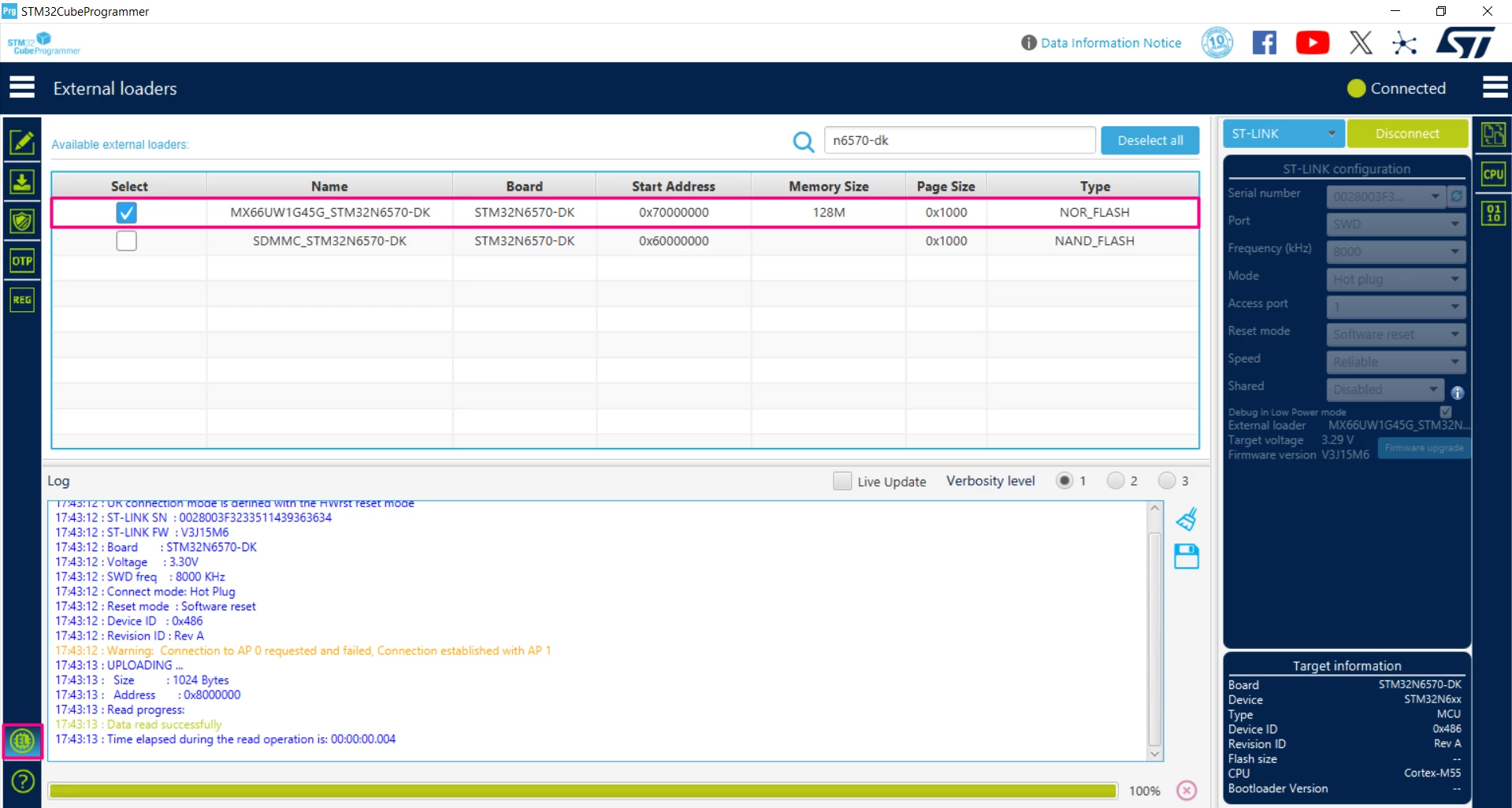

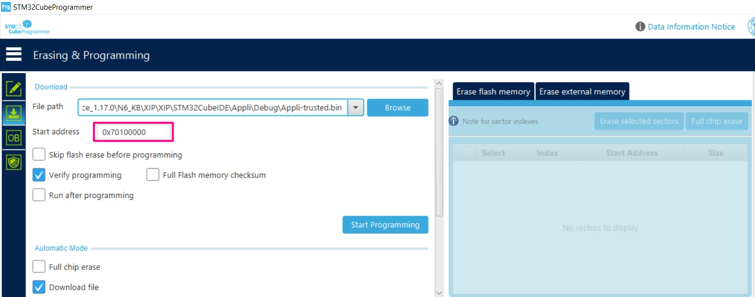

2.1.7 Programming the binaries
Make sure the external loader for the flash enabled:
And use the address [0x7000 0000] to program the FSBL binary and the [0x7010 0000] to program the application binary:
TIP: you might need to power cycle the board in case a failure message appears when clicking [Start Programming] and ensure it’s positioned in DEV boot mode.
