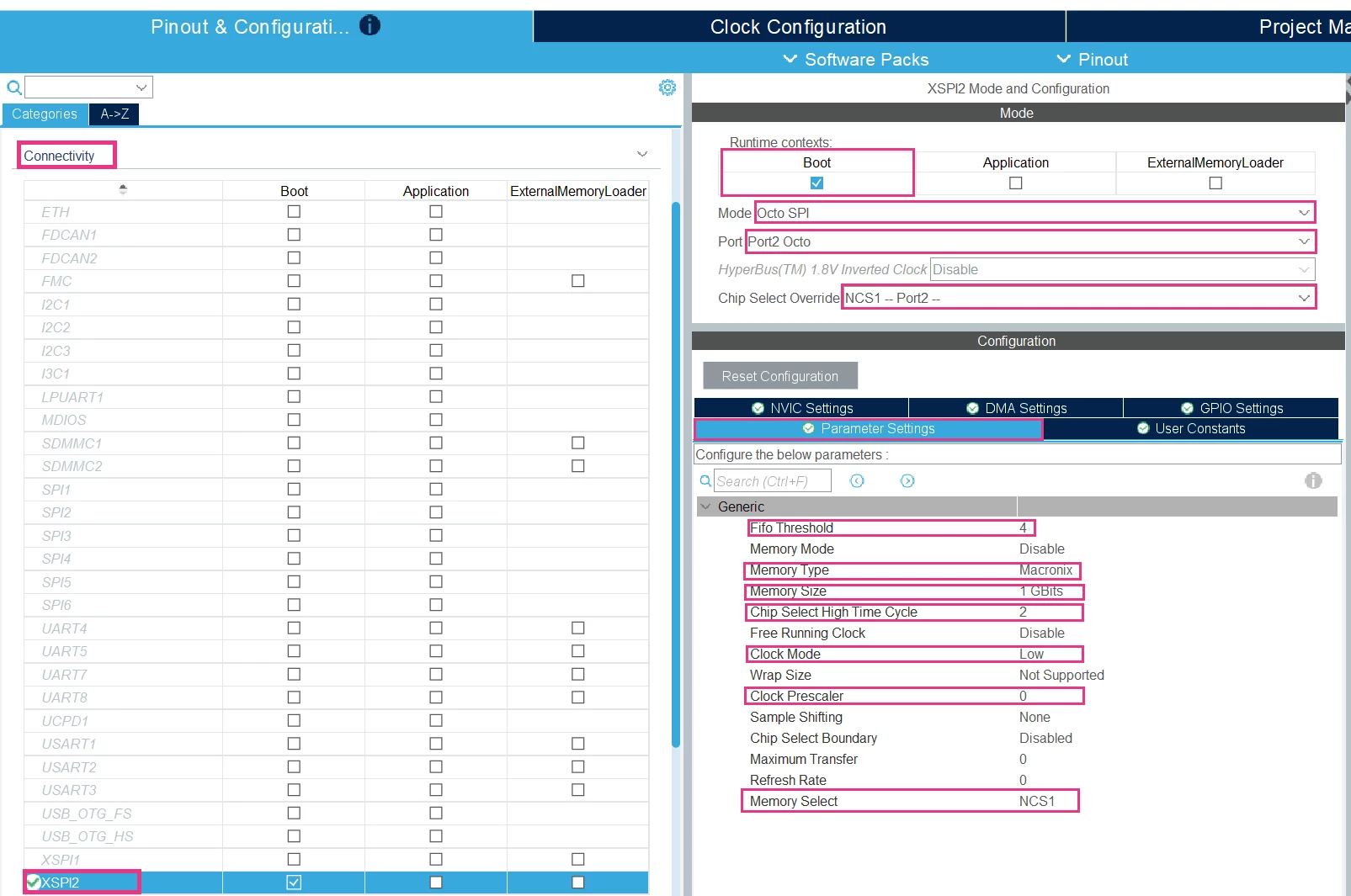

Step 4: XSPI Mode and configuration
To identify which XSPI interface is used to connect and communicate with the external flash memory on the STM32H7S78-DK board, refer to the user manual UM3289, as shown in the screenshot below.
To identify the memory type on the STM32H7S78-DK, refer to the schematic MB1736 of the board, as shown in the screenshot below.
The XSPI interface used is XSPI2, and the memory type is MX66UW1G45GXDI00. Therefore, follow the configuration associated with this interface, as shown in the screenshot below.
• Runtime contexts = Boot
• Mode = Octo SPI → The external flash memory MX66UW1G45G supports the Octaflash interface.
• Fifo Threshold = 4 → Defines the number of bytes in the FIFO required to trigger certain transfer operations. A value of 4 bytes provides a good compromise between processing speed and transfer efficiency.
• Memory Mode = Disable → Identifies that a single memory is used, it is enabled when using dual memory.
• Memory Type = Macronix → Means that the OCTOSPI interface is configured according to the Macronix protocol used by the external flash memory MX66UW1G45G. It uses a specific bit ordering (D1/D0) on the Serial Input/Output (SIO) lines required.
• Memory Size = 1 GBits → The memory size of MX66UW1G45G is 1 GBits.
• Chip Select High Time (tCSH) = 2 → Defines the chip-select minimum high time in number of clock cycles, configured depending on the memory datasheet, (refer to the MX66UW1G45G Memory Datasheet, specifically in AC CHARACTERISTICS table)
• Free Running Clock = Disable → The clock is not kept running continuously, which reduces power consumption.
• Clock Mode = Low → The clock must stay low while chip select is high (refer to the reference manual RM0477, specifically the NCS behavior section).
• Wrap Size = Not Supported → The automatic wrap-around read mode is not used, because this feature is not needed in our example.
• Clock Prescaler = 0 → The prescaler is used to divide the source clock of the XSPI peripheral (f_) to obtain a frequency compatible with the external flash.
The formula is: f_CLK = f_Kernel/Prescaler+1
Where:
  • f_CLK = frequency applied to the memory on the XSPI lines
  • f_ Kernel= clock frequency provided to the XSPI peripheral by the MCU
To choose the correct prescaler value, we must verify that the XSPI frequency is supported by both the MCU and the memory.
For  f_Kernel = 200 MHz & f_CLK = 200 MHz → therefore, the prescaler value is 0.
• Sample Shifting = 0 → Sample shifting (SSHT) is recommended as enabled in STR mode and disabled in DTR mode.
• Chip Select Boundary = Disabled → Configured depending on the memory datasheet. The chip select must go high when crossing the page boundary (2^CSBOUND bytes defines the page size).
• Maximum transfer = 0 → No specific maximum transfer size is imposed.
• Refresh rate = 0 → Required for PSRAMs memories, NOR flash does not require periodic refresh.
• Memory Select = NCS1 → Selects the CS#1 line for the external memory, because the external flash memory MX66UW1G45G is connected to this line on the STM32H7S78-DK board.
Note: For more details about the configuration of these parameters as shown in the screenshot above, users can refer to the application note AN5050. Specifically, the "STM32CubeMX - Configuration of OCTOSPI parameters" section and the "MX66UW1G45G Memory Datasheet".
