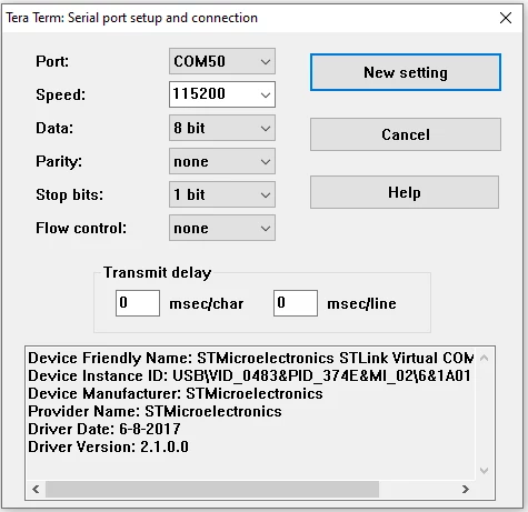

The main objective of this article is to provide a step-by-step guide on how to calibrate the delay block using a fast tuning method. This demo example implementation uses a STM32U5A9J-DK and OCTOSPI interface, but it can be easily tailored for other microcontrollers and memory types.
If you want to have the results of the edited files at hand immediately, then you can download the extractable file attached at the bottom of the article.

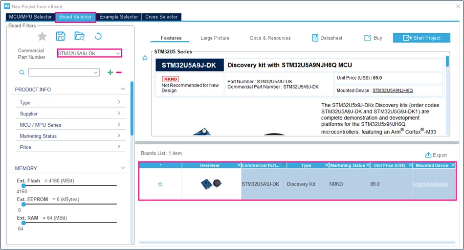

1. Open STM32CubeMX
2. Create a new project using the STM32U5A9J-DK board

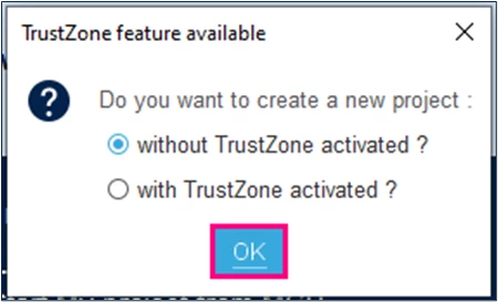

4. Do you want to create a new project?
Click [without TrustZone activated] and then click [OK].

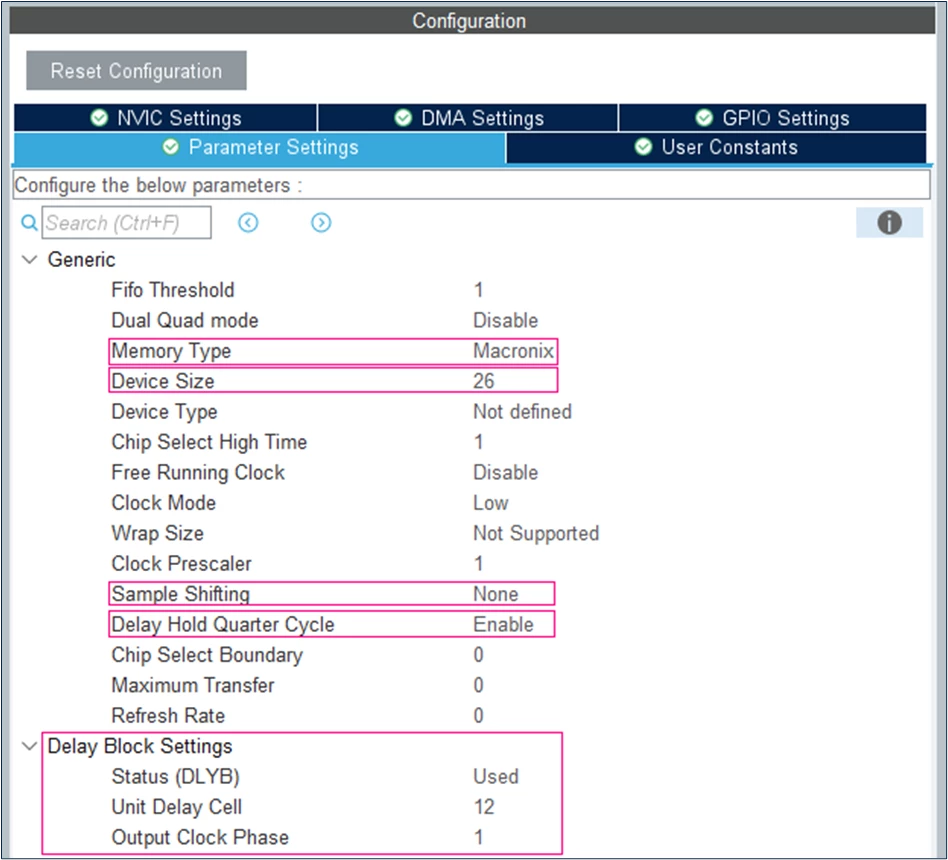

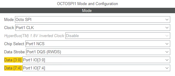

5. OCTOSPI1 Mode and configuration
For more details about this step, users can refer to section 7.2.4 "OCTOSPI Configuration and Parameter Settings" of AN5050 or this FAQ and memory datasheet.

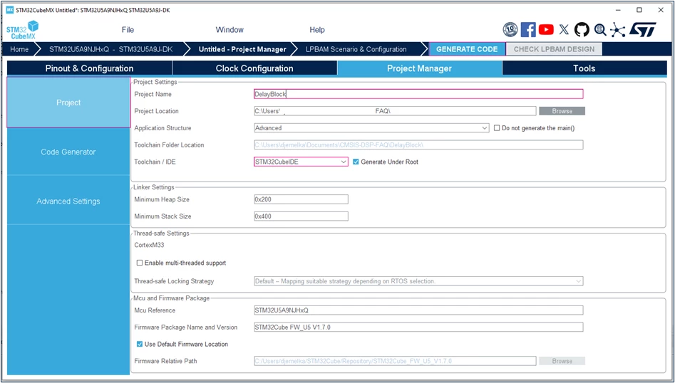

6. Generate code

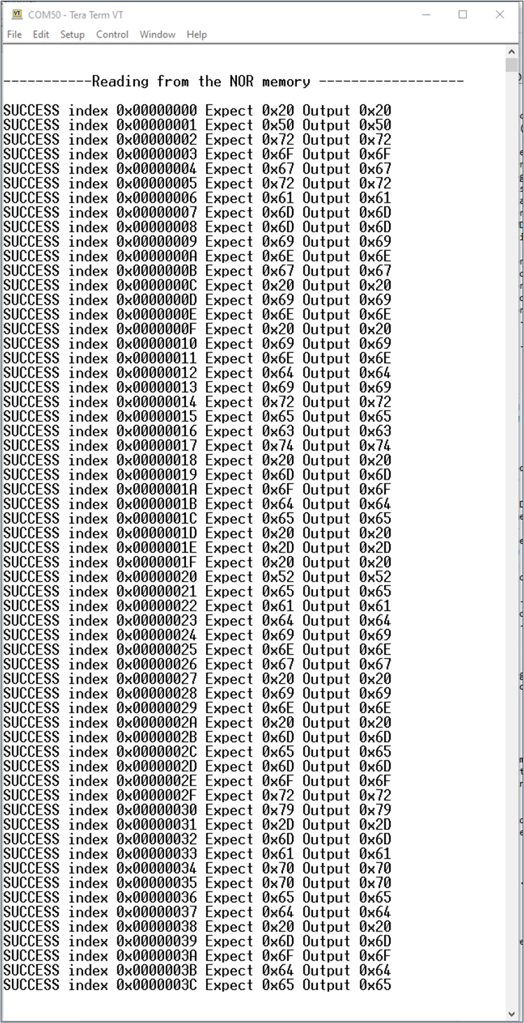

 printf("\r\n\r\n-----------Reading from the NOR memory ------------------\r\n");
 for(index = 0; index < BUFFERSIZE; index++)
	 /* Reading back the written aTxBuffer in memory-mapped mode */
	 aRxBuffer[index] = *nor_memaddr;
	 if(aRxBuffer[index] != aTxBuffer[index])
		 printf("\r\nFAILURE index 0x%08X Expect 0x%X Output 0x%X", index, aTxBuffer[index], aRxBuffer[index]);
	 } else {
		 printf("\r\nSUCCESS index 0x%08X Expect 0x%X Output 0x%X", index, aTxBuffer[index], aRxBuffer[index]);
	 nor_memaddr++;

9. Compile and flash
  • Click on "build" button
  • Open a console emulator such as Tera Term. Configure the console baud rate. The COM port name may differ on your PC.
  •  Tera Term displays that the results are successful.
After following this guide, you should now be able to calibrate the delay block. If you encounter any issues, we suggest that you create a post in the ST community for further assistance.
