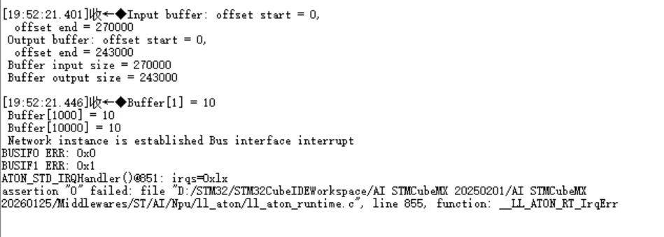

	LL_ATON_RT_RetValues_t ll_aton_rt_ret = LL_ATON_RT_DONE;
	const LL_Buffer_InfoTypeDef * ibuffersInfos = NN_Interface_Default.input_buffers_info();
	const LL_Buffer_InfoTypeDef * obuffersInfos = NN_Interface_Default.output_buffers_info();
	buffer_in = (uint8_t *)LL_Buffer_addr_start(&ibuffersInfos[0]);
	buffer_out = (uint8_t *)LL_Buffer_addr_start(&obuffersInfos[0]);
	// Printing buffer start and end addresses.
	printf("Input buffer: offset start = %lu, \n \r offset end = %lu \n \r",ibuffersInfos->offset_start,ibuffersInfos->offset_end);
	printf("Output buffer: offset start = %lu, \n \r offset end = %lu \n \r",obuffersInfos->offset_start,obuffersInfos->offset_end);
	// Getting buffer size and printing it.
	buff_in_len = ibuffersInfos->offset_end - ibuffersInfos->offset_start;
	buff_out_len = obuffersInfos->offset_end - obuffersInfos->offset_start;
	printf("Buffer input size = %lu \n\r Buffer output size = %lu \n\r", buff_in_len, buff_out_len);

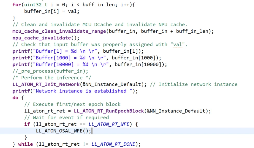

	uint8_t val = 10;
	LL_ATON_RT_RuntimeInit();
	// Run 10 inferences
	for (int inferenceNb = 0; inferenceNb < 10; ++inferenceNb) {
		/* - Inference - */
		/* Pre-process and fill the input buffer */
		// Fill input buffer with constant data.
		for(uint32_t i = 0; i < buff_in_len; i++){
			buffer_in[i] = val;
		// Clean and invalidate MCU DCache and invalidate NPU cache.
		mcu_cache_clean_invalidate_range(buffer_in, buffer_in + buff_in_len);
		npu_cache_invalidate();
		// Check that input buffer was properly assigned with "val".
		printf("Buffer[1] = %d \n \r", buffer_in[1]);
		printf("Buffer[1000] = %d \n \r", buffer_in[1000]);
		printf("Buffer[10000] = %d \n \r", buffer_in[10000]);
		//_pre_process(buffer_in);
		/* Perform the inference */
		LL_ATON_RT_Init_Network(&NN_Instance_Default); // Initialize network instance
		do {
			// Execute first/next epoch block
			ll_aton_rt_ret = LL_ATON_RT_RunEpochBlock(&NN_Instance_Default);
			// Wait for event if required
			if (ll_aton_rt_ret == LL_ATON_RT_WFE) {
				LL_ATON_OSAL_WFE();
		} while (ll_aton_rt_ret != LL_ATON_RT_DONE);
		// Post-process the output buffer
		// Invalidate CPU cache if needed
		// Convert int8 to float. Buffer is int8, but model's output is float.
		uint8_t aux[4];
		float_t *conver;
		for(uint32_t i = 0; i < buff_out_len; i += 4){
			aux[0] = buffer_out[i];
			aux[1] = buffer_out[i+1];
			aux[2] = buffer_out[i+2];
			aux[3] = buffer_out[i+3];
			conver = (float_t *)aux;

Feb 3, 2026 2:33 AM UTC
@Julian E.  Thank you for your tutorial, which has been very helpful for me.
However, I encountered an issue after programming and running it. As shown in the figure, after successfully establishing the NN instance, a bus error occurred.
Does anything wrong about the BUS or the configurations?
The relevant code  is shown below. Apart from adding printf("Network instance is established ");, no other modifications were made.
BTW,the model I used now is the ONNX format of ssdlite_mobilenetv2_pt_coco_300_qdq_int8,which is provided in the model-zoo version 4.0.
Thanks very much!
