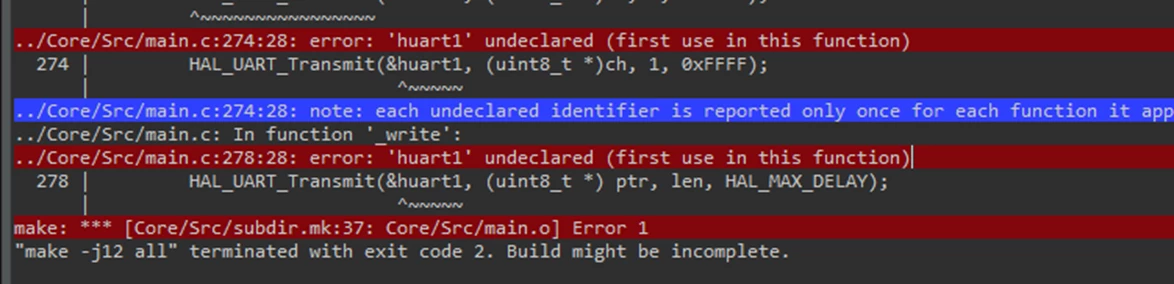

3.2.5.2 Configure serial communication for debugging
The serial interface USART1 (PE5/PE6), which supports the bootloader, is directly accessible as a Virtual COM port on the PC when connected via the STLINK-V3EC USB connector (CN6). We use this interface to redirect the ‘printf‘ output, enabling easy debugging through a serial terminal. Enable USART1 for the Application runtime context, set the mode to "Asynchronous", and configure the baud rate to 115200 bit/s
As you can see below, there is a conflict shown in orange. To fix it, change the pin PA11 to USART1_CTS:
To redirect ‘printf‘, additional code needs to be added to your project. This is done later.

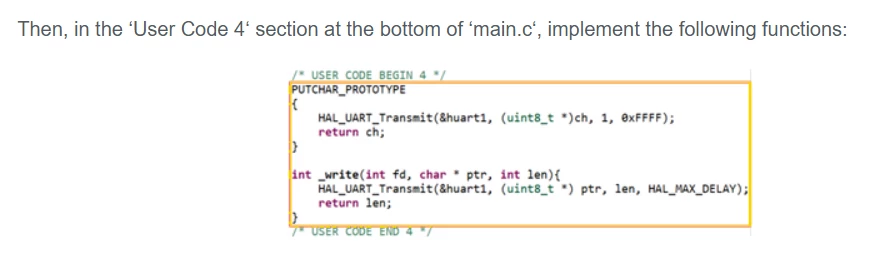

4.2 Add code in Appli
Next, go to the Appli project. At the top of ‘main.c‘, in the private define section, declare the following macro for the ‘put_char‘ function.
#define PUTCHAR_PROTOTYPE int __io_putchar(int ch)
Then, in the ‘User Code 4‘ section at the bottom of ‘main.c‘, implement the following functions:
PUTCHAR_PROTOTYPE
HAL_UART_Transmit(&huart1, (uint8_t *)ch, 1, 0xFFFF);
return ch;
int _write(int fd, char * ptr, int len){
HAL_UART_Transmit(&huart1, (uint8_t *) ptr, len, HAL_MAX_DELAY);
return len;

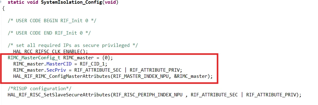

Add the following line to the RIF (SystemIsolation_Config) function to complete the slave configuration:
HAL_RIF_RISC_SetSlaveSecureAttributes(RIF_RISC_PERIPH_INDEX_NPU, RIF_ATTRIBUTE_PRIV | RIF_ATTRIBUTE_SEC);
Important note 2: Make sure that the part of the code above the line we add is present in the generated code. If not, it may indicate an issue in the RIF configuration. Make sure to look back at the Security configuration in CubeMX and that the NPU is selected in the RIF tab of CubeMX.

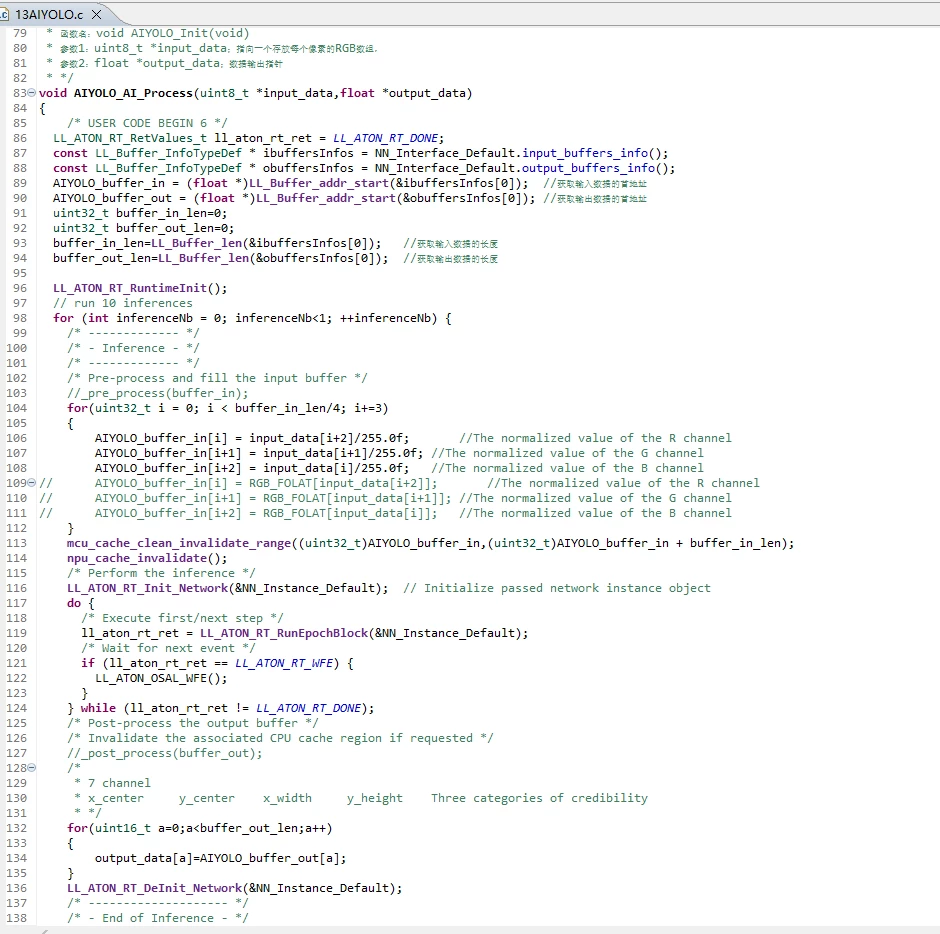

Finally, you need to handle the input and output buffers to feed your neural network and retrieve the inferred results. Since both the NPU and MCU have their own cache memories, these must be properly managed before invoking the low-level inference function to ensure that both units access up-to-date data in memory and that any results are stored in a mutually accessible region. Therefore, you must perform a cache clean and invalidate operations.
The ‘MX_X_CUBE_AI_Process‘ function below implements the following features:
  • Calculating buffer sizes.
  • Filling the input buffer with constant values.

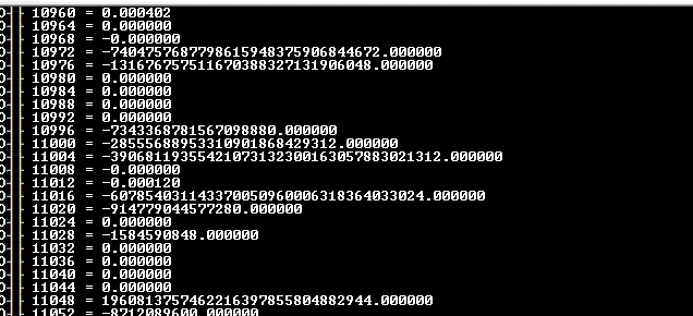

  • Cleaning and invalidating the MCU DCACHE and invalidating the NPU cache prior to inference.
  • Converting integer table values to float and printing them via UART.
The last functionality is implemented because memory is always allocated as an int table, but for this model, the output format is float. An int is 8 bits, and a float is 32 bits. Therefore, reading a single element from the array does not yield 19 valid values. Instead, four consecutive 8-bit values must be concatenated and interpreted as a single 32-bit float. You can copy the ‘MX_X_CUBE_AI_Process‘ function from the script below. After pasting it, press [Ctrl+I] to autoindent the code properly.
// Initialize these 2 variables at the begining of the file
uint32_t buff_in_len, buff_out_len;
void MX_X_CUBE_AI_Process(void)
 /* USER CODE BEGIN 6 */
	LL_ATON_RT_RetValues_t ll_aton_rt_ret = LL_ATON_RT_DONE;
	const LL_Buffer_InfoTypeDef * ibuffersInfos = NN_Interface_Default.input_buffers_info();
	const LL_Buffer_InfoTypeDef * obuffersInfos = NN_Interface_Default.output_buffers_info();
	buffer_in = (uint8_t *)LL_Buffer_addr_start(&ibuffersInfos[0]);
	buffer_out = (uint8_t *)LL_Buffer_addr_start(&obuffersInfos[0]);
	// Printing buffer start and end addresses.
	printf("Input buffer: offset start = %lu, \n \r offset end = %lu \n \r",ibuffersInfos->offset_start,ibuffersInfos->offset_end);
	printf("Output buffer: offset start = %lu, \n \r offset end = %lu \n \r",obuffersInfos->offset_start,obuffersInfos->offset_end);
	// Getting buffer size and printing it.
	buff_in_len = ibuffersInfos->offset_end - ibuffersInfos->offset_start;
	buff_out_len = obuffersInfos->offset_end - obuffersInfos->offset_start;
	printf("Buffer input size = %lu \n\r Buffer output size = %lu \n\r", buff_in_len, buff_out_len);
	uint8_t val = 10;
	LL_ATON_RT_RuntimeInit();
	// Run 10 inferences
	for (int inferenceNb = 0; inferenceNb < 10; ++inferenceNb) {
		/* - Inference - */
		/* Pre-process and fill the input buffer */
		// Fill input buffer with constant data.
		for(uint32_t i = 0; i < buff_in_len; i++){
			buffer_in[i] = val;
		// Clean and invalidate MCU DCache and invalidate NPU cache.
		mcu_cache_clean_invalidate_range(buffer_in, buffer_in + buff_in_len);
		npu_cache_invalidate();
		// Check that input buffer was properly assigned with "val".
		printf("Buffer[1] = %d \n \r", buffer_in[1]);
		printf("Buffer[1000] = %d \n \r", buffer_in[1000]);
		printf("Buffer[10000] = %d \n \r", buffer_in[10000]);
		//_pre_process(buffer_in);
		/* Perform the inference */
		LL_ATON_RT_Init_Network(&NN_Instance_Default); // Initialize network instance
		do {
			// Execute first/next epoch block
			ll_aton_rt_ret = LL_ATON_RT_RunEpochBlock(&NN_Instance_Default);
			// Wait for event if required
			if (ll_aton_rt_ret == LL_ATON_RT_WFE) {
				LL_ATON_OSAL_WFE();
		} while (ll_aton_rt_ret != LL_ATON_RT_DONE);
		// Post-process the output buffer
		// Invalidate CPU cache if needed

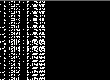

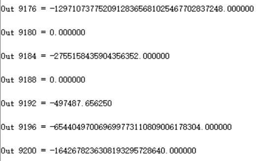

		// Convert int8 to float. Buffer is int8, but model's output is float.
		uint8_t aux[4];
		float_t *conver;
		for(uint32_t i = 0; i < buff_out_len; i += 4){
			aux[0] = buffer_out[i];
			aux[1] = buffer_out[i+1];
			aux[2] = buffer_out[i+2];
			aux[3] = buffer_out[i+3];
			conver = (float_t *)aux;

Nov 20, 2025 19:47 UTC
Hi @Julian E.
From your tutorial
How should we define "huart1"? Otherwise, the error message as shown below.
Thanks
Julian E.
Julian E.Author
Nov 21, 2025 08:40 UTC
Hi @Xiaoping,
In main.c of the application (not FSBL), you need to add this at the begining of your code
 and in User Code 4, add this:
PUTCHAR_PROTOTYPE
return ch;
return len;
Make also sure to have set correctly the uart1 as explained in part
Have a good day,
Julian

Dec 2, 2025 06:42 UTC
Hello, I wonder why following the steps outlined in the blog results in such an exception with float-type outputs. Similarly, when deploying the YOLOv8n model, I also encounter this output exception.
Jan 9, 2026 07:19 UTC
Hello, I have followed all the steps and I am getting above output. Can you let me know what could be the issue? Is it either external nor flash not accessible from application or RIF or clock issues?
Jan 13, 2026 03:32 UTC
Hi @Xiaopingavinashmm,
This situation you described has occurred to me before. My solution is to first verify the exported model on the PC. It is essential to clearly understand the input and output of the model. This can be achieved by analyzing the input and output data of the model. For example, generating a table file through Python. Example: The size of the image is: 256x192x3; The model can detect three categories. The model input is (256, 192, 3), and the model output is (1, 7, 1008). The input and output of the model are of float type. The model input occupies 256x192x3x4 bytes of memory. This is because the RGB values of each pixel need to be normalized, that is, each pixel's RGB value is divided by 255. The model output occupies 1x7x1008x4 bytes of memory. When obtaining, a float type array with a size of 7x1008 can be defined. Array 0-1007 represents the width of the detection box, and 1008-2015 represents the height of the detection box. 2016-3023 represent the center coordinates of the width, and 3024-4031 represent the center coordinates of the height. The following three 1008 values correspond to the detection confidence levels of three different categories. These are mainly related to the output of your model and require detailed understanding.It is particularly important to understand the relationship between the model's output and input, and to conduct a thorough analysis by creating a table.20260113112618.png
Jan 13, 2026 11:47 UTC
Hi @The-Big-Monster ,
 Thanks for the detailed insights. I will certainly consider all your insights when I start using custom models. Right now, the issue is due to RIF initialization. I am using STM32CubeIDE: Version 1.19.0, as against the version used in tutorial (v 1.18.1). The issue was the below lines of code missing in SystemIsolation_Config. This is not getting generated in v1.19.0. I had to manually add this code. Only the SetSlaveSecureAttribute was getting generated.
Now, I am getting perfect float output values.
