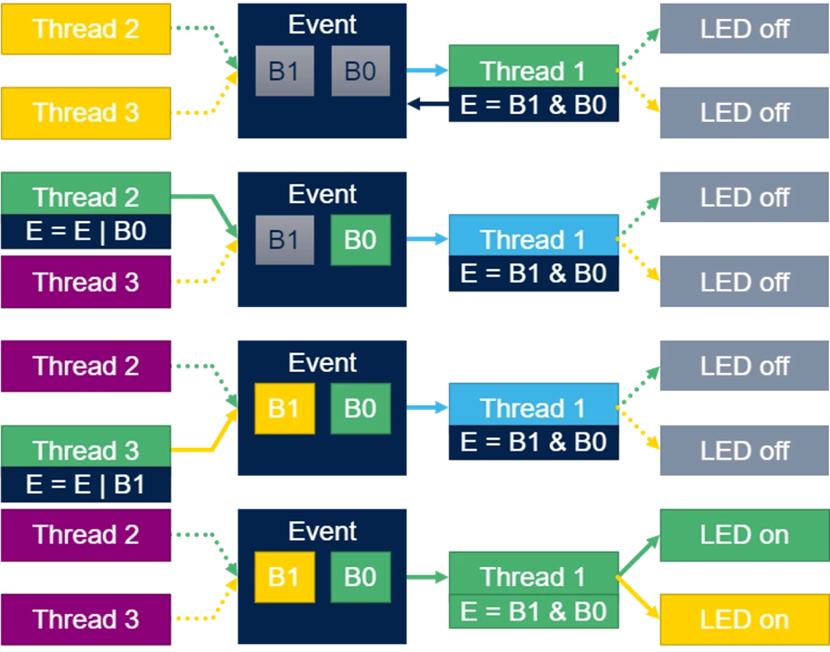

Event flags are a very useful extension to semaphores and mutexes and provide a powerful tool for thread synchronization. Upon creation using the tx_event_flags_create() call, 32 event flags in the group are initialized with zero. Each event flag is represented by a single bit, thus the event has 32 bits. Threads can ask to watch specific bits by OR or AND and they can operate on all 32 event flags in a group at the same time. If these bits are set, the thread is informed and this can be used to synchronize multiple threads.
The image below shows a quick flowchart of the possible and most typical combinations of OR and AND.

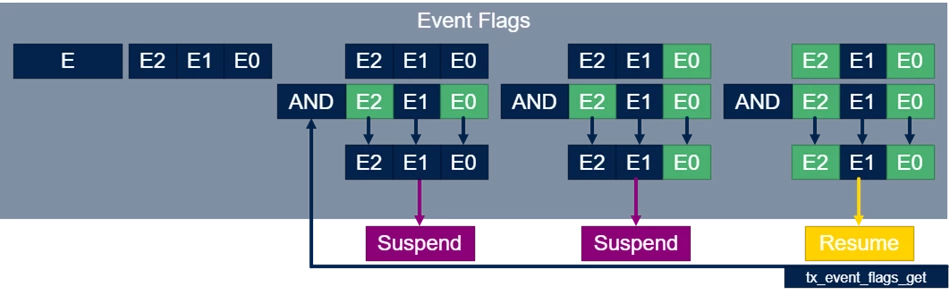

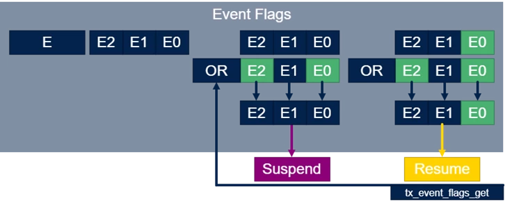

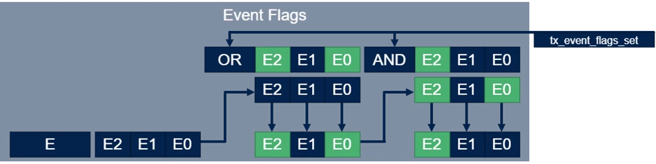

1.2 Event flag get

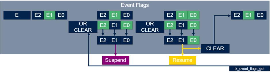

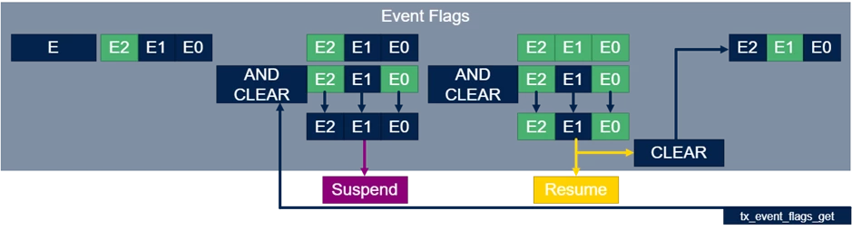

For a thread to check if a flag is set or not, we can use a function called tx_event_flags_get.
tx_event_flags_get(&event_ptr, 0x3, TX_AND_CLEAR ,&events, TX_WAIT_FOREVER);
The first argument is the event flag handle event_ptr. The second argument is flags positions desired 0x3 (11b). The third argument is how to get the flags: TX_AND, TX_OR, TX_OR_CLEAR, TX_AND_CLEAR. The fourth argument is a  pointer to grab the flag result. The fifty and last argument is the waiting time, ranging from: TX_NO_WAIT (0x00) to TX_WAIT_FOREVER (0xFFFFFFFF). Event flags get with OR:
Event flags get with AND:
Event flags get with OR CLEAR:
Event flags get with AND CLEAR:

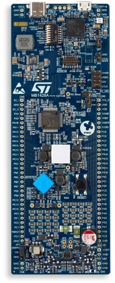

To show an implementation of the EF (Event Flag) resource, this article uses the RGB LED and joystick buttons available on the STM32G474 Discovery kit. Hence, an event flag group is created, where each bit is associated with a joystick button. The flags are set by the EXTI (External Interrupt) callback function, which checks which button has been pressed. To manage the LED color, three timer channels in PWM mode are associated with each signal LED pin.
According to the flag set, two threads manage the PWM timers changing the timer capture compare registers, and the following functions are implemented:

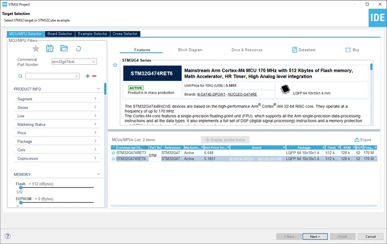

Let us start creating a new STM32 Project on STM32CubeIDE for the STM32G474RET microcontroller.
Name your project, remember to avoid space and special characters. The name used in this article is “EV_FLAG_G474”.

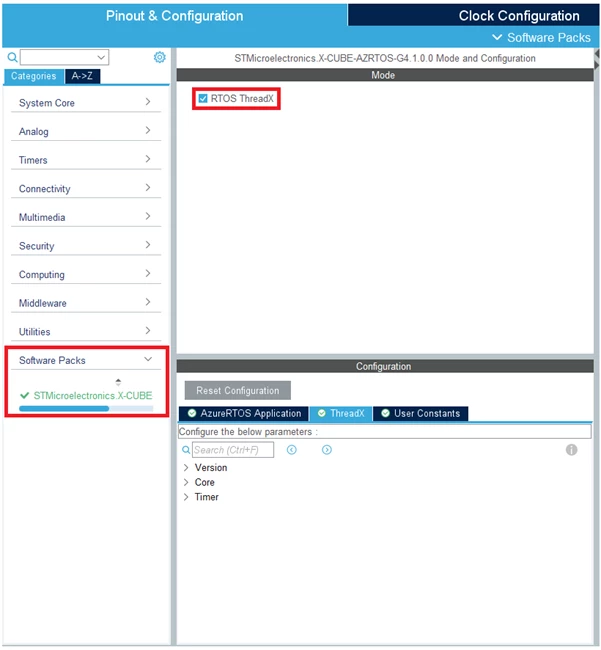

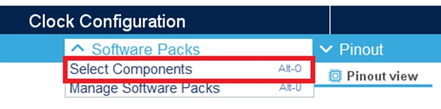

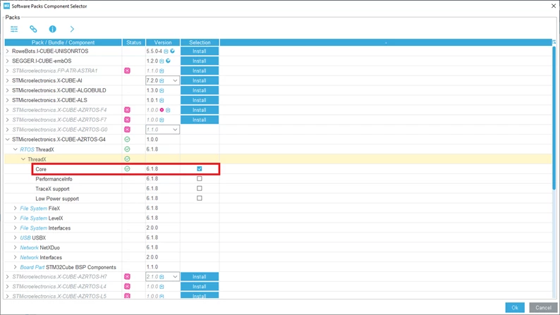

To import the Azure RTOS to the project, click on “Software Packs”, and then “Select Components”.
In the “Software Packs Component Selector” menu, locate STMicroelectronics.X-CUBE-AZRTOS-G4 → RTOS ThreadX → ThreadX, check the “Core” box and click OK.
Add the Azure RTOS ThreadX checking the box inside Software Packs → STMicroelectronics.X-CUBE-AZRTOS-G4. As this demo is just meant to create small timers and GPIOs managements according to the event flags, the default settings are fine.

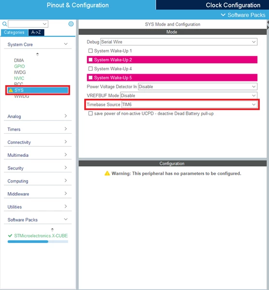

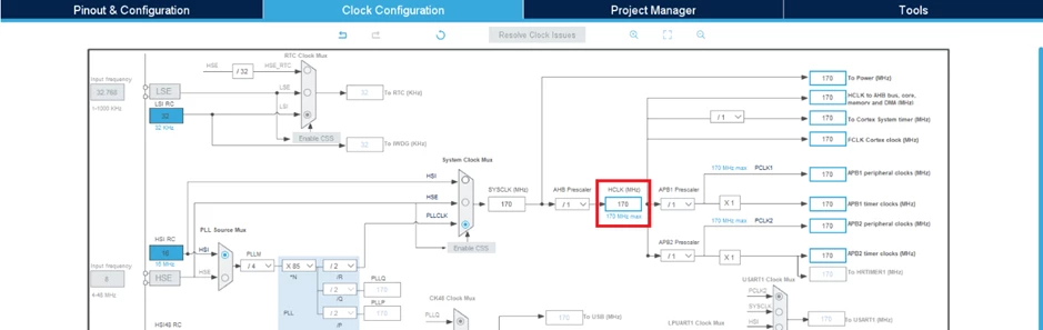

By default, the HAL driver uses the SysTick as its primary time base, but this timer should be left to the AzureRTOS only. If the HAL library does not have a separate time source, the compilation and code execution might fail because both libraries want to use the SysTick_Handler interrupt. To prevent this, we can simply select a different time base for the HAL by clicking in the System Core → SYS and selecting the time base Source as TIM6:
Go to clock configurations and adjust the settings as shown in the image to achieve the HLCK at 170 MHz.

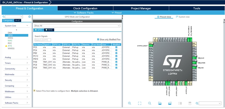

Configure the following pins as table shown:
Component Pin Configuration Label
Joystick Select PC13 GPIO External Interrupt mode with Falling Edge trigger detection and pull-up JOYSTICK_SELECT
Joystick Up PB10 JOYSTICK_UP
Joystick Right PB2 JOYSTICK_RIGHT
Joystick Down PC5 JOYSTICK_DOWN
Joystick Left PC4 JOYSTICK_LEFT
RGB LED Red PC6 TIM3_CH1 PWM_RED
RGB LED GREEN PC8 TIM3_CH3 PWM_GREEN
RGB LED BLUE PA8 TIM1_CH1 PWM_BLUE

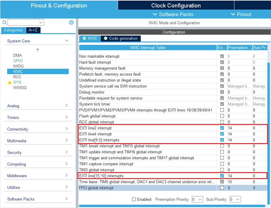

Enable the GPIO External interrupts on NVIC tab and give them a 14 Preemption Priority (this priority will be 1 level lower than thread priorities).

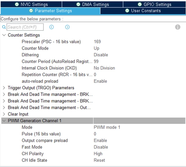

Set timer 1 and 3 configurations as the following settings:
  • TIM1_CHANNEL1: PWM Generation CH1.
  • TIM3_CHANNEL1: PWM Generation CH1.
  • TIM3_CHANNEL3: PWM Generation CH3.
  • Prescaler: 169, that sets the timer frequency to 1 MHz = 170 Mhz/(169 + 1).
  • Counter Period: 99, which sets the PWM frequency to 100 KHz = 1 MHz/(99 + 1) and a resolution of 1%.
  • Auto-reload preload: Enable.
The other settings are default values.

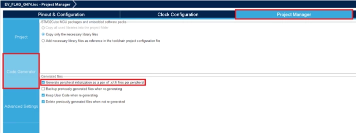

The last step before the code generation is to enable the “Generate peripheral initialization as a pair of ‘.c/.h’ files per peripheral” in Project Manager → Code Generator. This should be helpful to HAL functions and resources management.
All set, we can press Alt+K to generate the code or click on the following button.

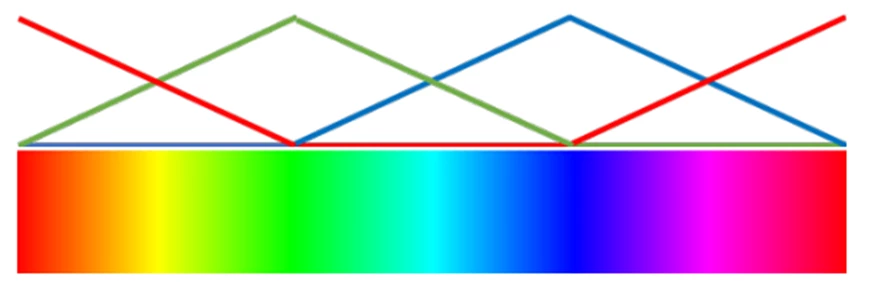

The RainbowThread function it is a thread that manages the colors when the LED is set to a rainbow mode. This thread runs while the SELECT event button is set because this flag is not cleared in the get function. To change the color, add a counter and use this as the index of the lookup table to send the parameters to the RGBColorChange function. Finally, add a logic to give a phase between the LED signals as the following code:

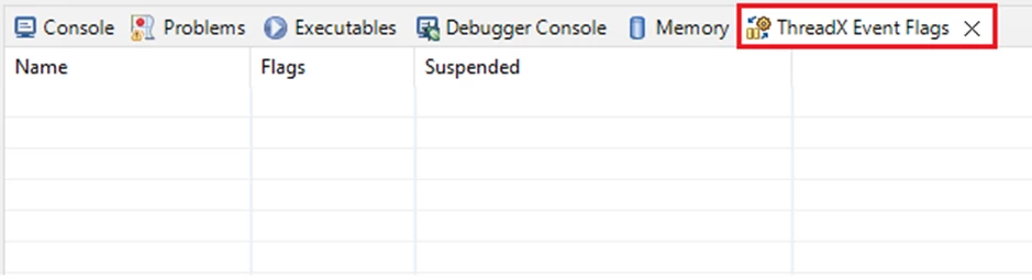

In the Debug Configurations menu, let the standard settings and then click on debug. Once in the Debug perspective, click on “Window → Show view → ThreadX → ThreadX Event Flags”.
It should open a tab at a bottom window group of STM32CubeIDE.Laurids_PETERSEN_14-1750949093693.png

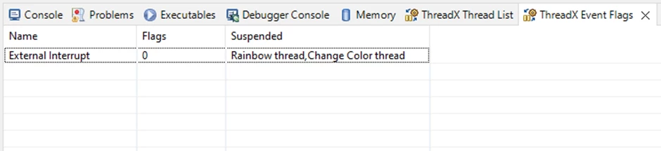

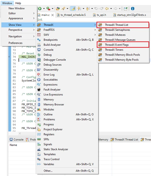

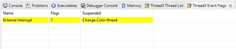

Run the code, test the demo by pressing the buttons and enjoy the RGB LED behavior. Pause the code in the Debug, and check the ThreadX event flags tab. In this tab, you can see the created event groups, their actual flags counting, and the threads that interact with that. Since this code clears the flag after the color update, the flag should be zero if you pause the code when the LED is not in rainbow mode. Furthermore, the threads are suspended because these are waiting for an event.Laurids_PETERSEN_15-1750949093903.png
If you pause the code during the rainbow mode, you see a flag set. The Change Color thread is suspended and the Rainbow thread runs continuously, updating the LED color.

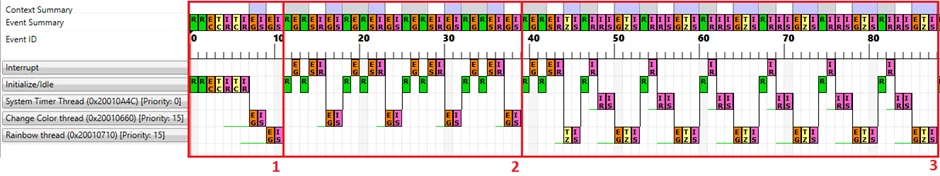

The following image shows the behavior of the OS, it is possible to check how the application works.
In the first block, we have the kernel initialization, the Event Creation (EC), two Thread Creations (TC) and after their first Event Gets (EG) as programmed.
The second block, we can see an EG at the interrupt level (it is the event get inside the EXTI callback function, that is, a button was pressed), then an ES that set a flag bit (also inside the EXTI callback). After the flag is set, the Change Color Thread runs, gets and clears the flag, changes the LED color, and then enters in suspend mode waiting for a new Event. This cycle occurs four times, the same as shown in the previous image.
The third block shows the AzureRTOS kernel behavior when the LED is in Rainbow mode. At the beginning of the block, we have an event get and set (in the EXTI) and then the Rainbow thread starts to run. As we can see, this thread runs continuously because it does not clear the flag to keep the thread running and updating the color of the LED.
This graph was made by the TraceX feature. If you need more information about TraceX and a tutorial showing how to implement this, refer to: How can I add TraceX support in STM32CubeIDE?
