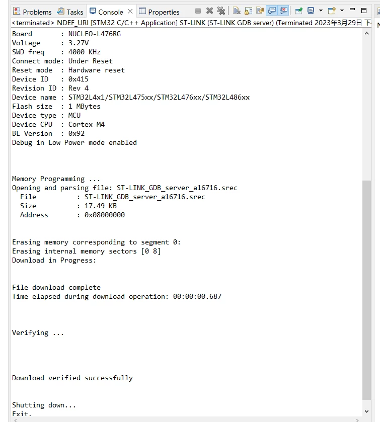

I used code from X-CUBE-NFC7 - Dynamic NFC/RFID tag IC software expansion for STM32Cube - STMicroelectronics,and I run the  NDEF_URI successfully. Here are the results of the run,My ST25 Tap still doesn't have any NDEF messages.0693W00000aPNq4QAG.png

Hi @帅罗.1 (Community Member)​,
This is not result of the run but result of the flash programming, which mean the binary has been correctly programmed.
Could you share the memory content of your tag.
The correct content is the following:
E1 40 40 05
03 15 D1 01
11 55 01 73
74 2E 63 6F
6D 2F 73 74
32 35 2D 64
65 6D 6f FE
This correspond to an NDEF message of type URI with an URL record that point to www.st.com/st25-demo (data after last byte 0xFE are not used). If your tag memory isn't filled with those data, please use the debug mode to understand what and where is the error. Without this information it will be hard to help you.
