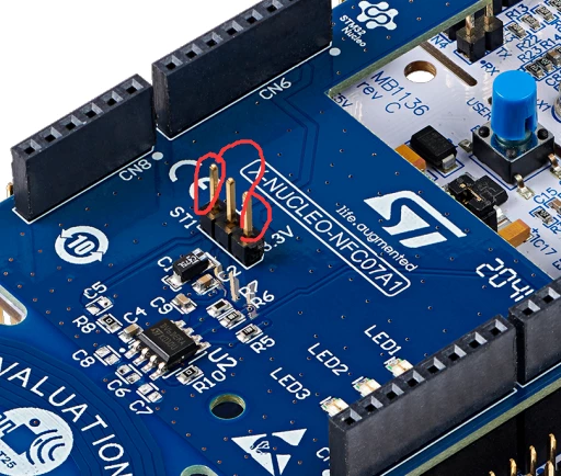

Hi,@Rene Lenerve​
I use the NDEF.URI sample code, but the memory for the tag is empty. I found my problem. I did not connect ST1 to the 3.3v position correctly,whether I need to do this in order to read NDEF messages correctly.0693W00000bhCtMQAU.png

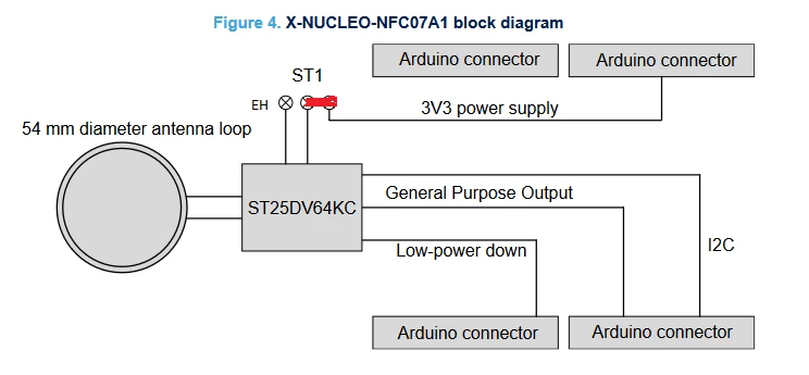

Hi @帅罗.1 (Community Member)​,
Great that you found the issue for the NFC7. This ST1 connector is used to select power for the ST25DVxxKC (3.3V comming from the nucleo MB1136C or Energy Harvesting coming from the RF Field). Be careful, regarding your screenshot you need to shunt the centered pin with the right-pin (3.3V), otherwise ST25DVxxKC will not be powered (and you will redirect both power supplies, the EH pin to the 3.3V).
I'm not sure to understand your point and I'm not sure you have understood correctly my explanation. You only need to connect the jumper ST1 as per the picture I shared previously. This will powered the ST25DVxxKC to allow I²C communication (ST25DVxxKC Vcc connected to 3.3V). The RF communication is always available as it is powered by the RF Field. The EH pin is an output and used to power another small device by harvesting energy from the field. You can found more information in the DataSheet of the ST25DVxxKC.

Schuyler
March 31, 2023
Hi,@Rene Lenerve​
Thank you for your help, I have successfully solved the problem, wish you a happy life!
