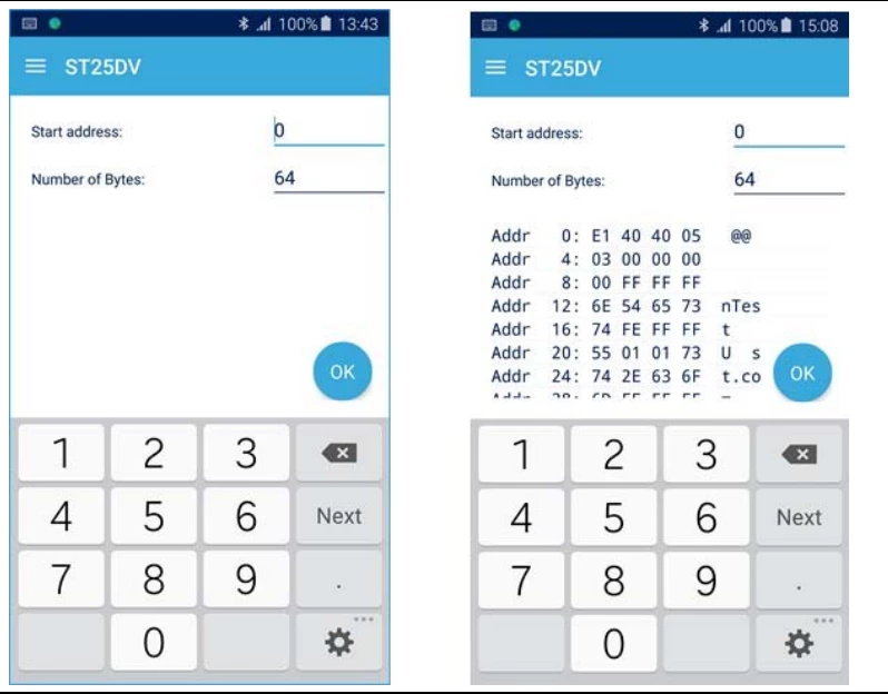

Hi @帅罗.1 (Community Member)​,
I suggest you to erase the tag memory because if the CC file is already written it will not be updated with the code used above, and it is probably why you are not seeing the NDEF Text message in ST25 NFC App. By erasing the tag memory and use the code above it will automatically rewrite the CC file and the NDEF Text message. You are free to manage this part as you want.
Kind Regards

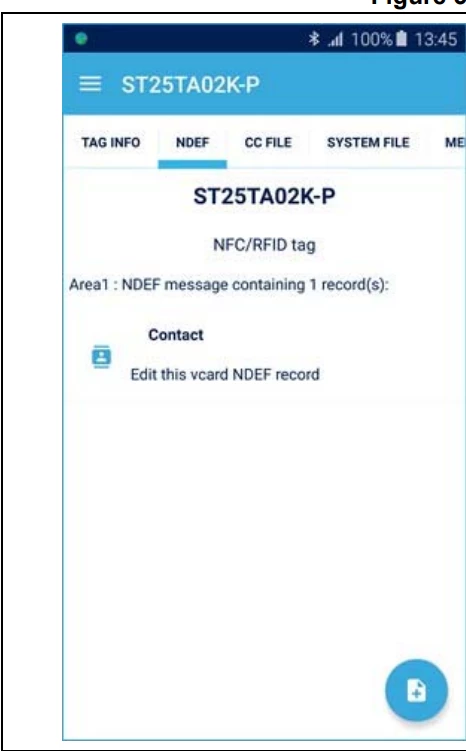

Your screenshots are not displaying same tag content ST25DV vs ST25TA02K-P.
For the ST25DV the CCFile has been correctly filled with expected values, the rest of the memory indicates that an empty message is stored. So now the NDEF Text message can be correctly written and then you should see it on the App.
Kind Regards.

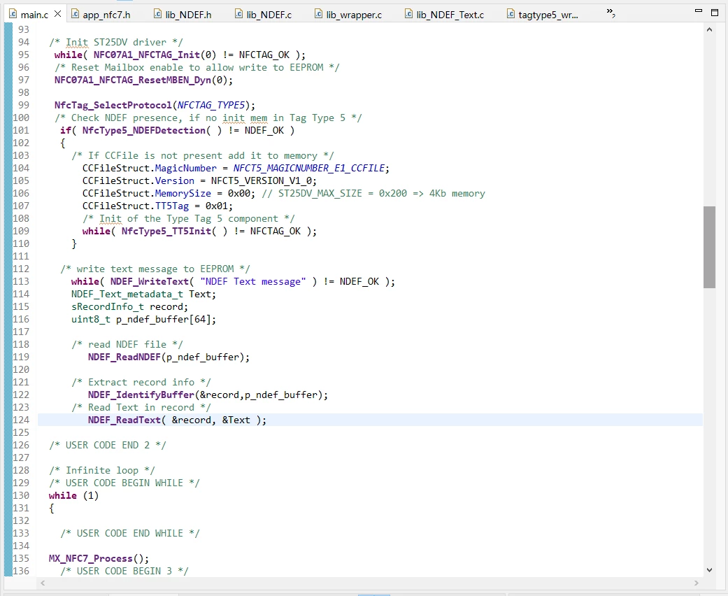

Hi,@Rene Lenerve​
I used the sample code called “NDEF_URI�? in X-CUBE-NFC7. But the phone still hasn't read the URL in the code, what should I do? 0693W00000aJr14QAC.png0693W00000aJr1JQAS.jpg
Schuyler
March 28, 2023

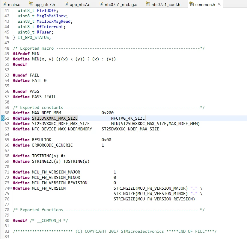

 I have changed “MemorySize = 0x00�? to “CCFileStruct.MemorySize = (ST25DVXXKC_MAX_SIZE / 8) & 0xFF;�?

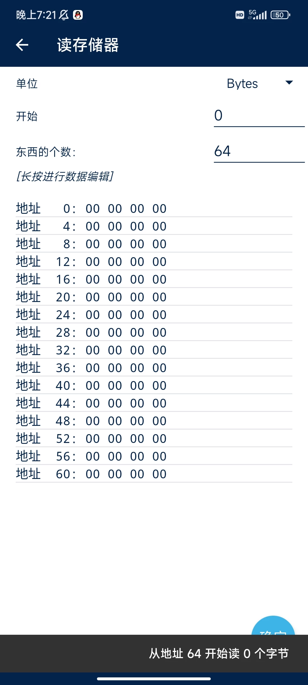

Rene Lenerve
March 28, 2023
I'm sorry, I'm not able to translate your screenshot.
But the memory seems to be empty, if you have played the firmware it should have filled it with CCFile and NDEF message. This may be an issue with the NFC07A1_NFCTAG_Init function which checks that the connected component is an ST25DVxxKC. Are you sure that the chip is a ST25DVxxKC and not a ST25DVxxK?

March 28, 2023
Hi,@Rene Lenerve​
Yes,  the memory is empty, I can write to and read from memory from my phone,but the above code does not display the information correctly. I have checked ST25DVXXKC according to your prompt and found no problem,The memory read by the phone is always empty. Do you have a better suggestion0693W00000aJrmeQAC.png
