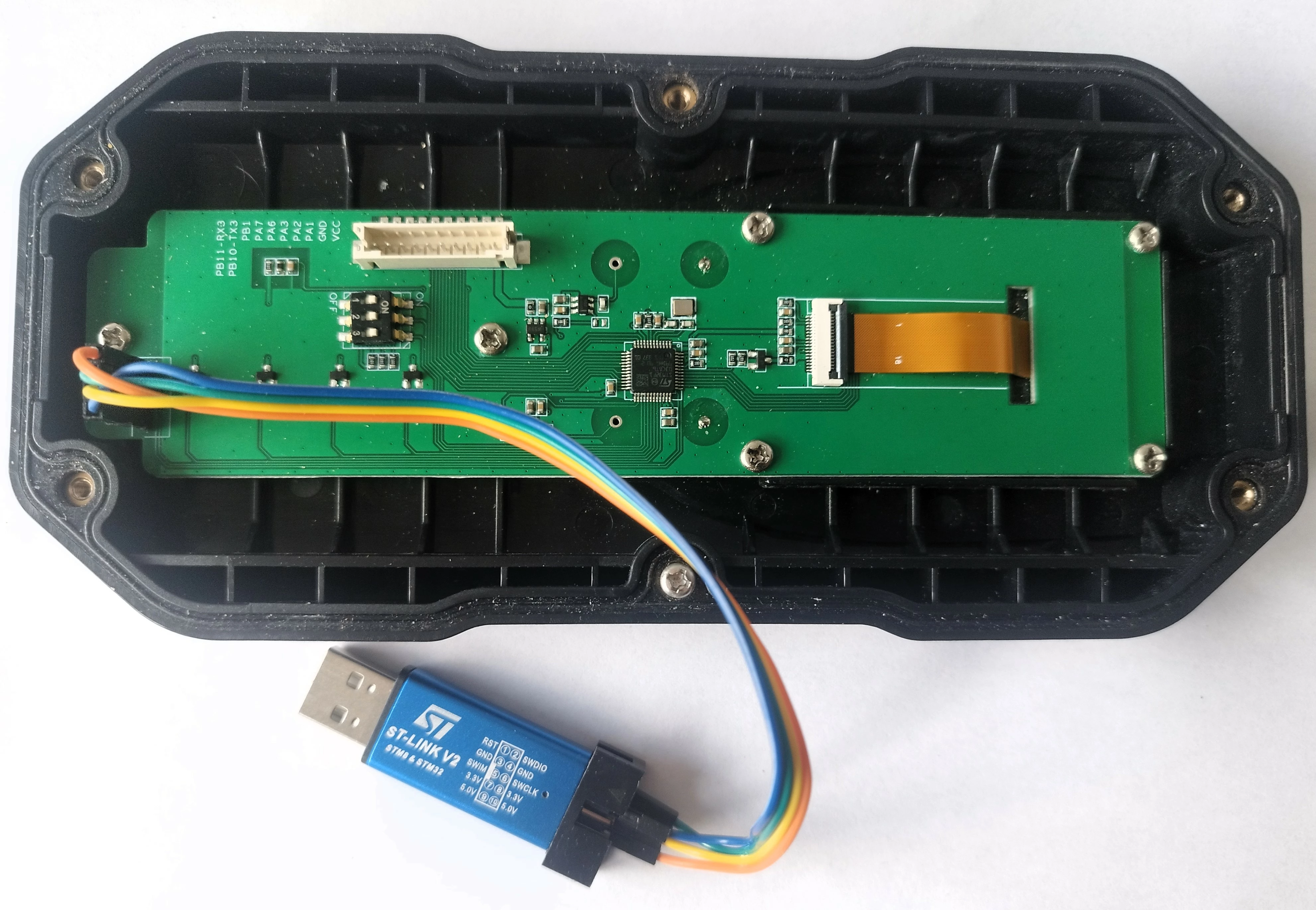

Using ST-Link v2 and Utility I've been trying to read and save a hex file from a EVSE device that uses a STM32F1 microprocessor to control and display functions. I thought that it was just a matter of connecting via the  debug/program interface and then saving the result, but unfortunately I seem to have erased everything and now the memory is displayed as empty.
My experience on this sort of thing is limited so can anyone help and possibly comment on what I'm doing wrong?

ludemonAuthor
July 8, 2025
I'm not using a Blue Pill board. I thought that was for development purposes.
The photo shows my ST-Link connected to the existing board via GND CLK DIO VCC port.
mƎALLEm
July 8, 2025
That’s unfortunately not a genuine STLINK.
