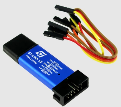

chriskuku
Senior II
Feb 9, 2026 2:51 PM UTC
Error: Data read failed - when connecting to STM32F103C8BT6 Blue Pill
Title edited to flag that this relates to a Blue Pill
I'm trying to connect an STM32-STLink-V2 with three wires via SWD (GND, SCLK,SDIO). Was able to run a firmware upgrade, now V2J46S7.
Clicking on Connect gives:

9 replies
Feb 9, 2026 2:55 PM UTC
> What's wrong?
You probably have a counterfeit chip and/or programmer.
Programmer reports a voltage despite no VCC connected, so maybe you're using this?
Non-ST tools often don't work will with newer software.

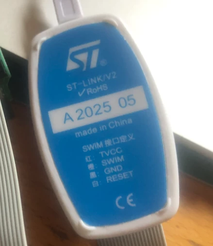

chriskuku
chriskukuAuthor
Senior II
Feb 9, 2026 3:12 PM UTC
I'm using this:
Andrew Neil
Feb 9, 2026 4:41 PM UTC
@chriskuku Note that you can put the image directly in the post - then we can see it:
That's a fake - see this post by @mƎALLEm
You still haven't said what board you're using

As @TDK said, the STM32F103C8BT6 is widely cloned, and there are many fake ST-Links out there.
This was discussed at length recently in this thread
And this thread
And this thread
See also: How to recognize a genuine ST-LINK/V2 versus a cloned one.
Feb 9, 2026 3:34 PM UTC
That one looks counterfeit as well, unless the markings have changed.
How to recognize a genuine ST-LINK/V2 versus a clo... - STMicroelectronics Community
Plus the board is likely counterfeit.
