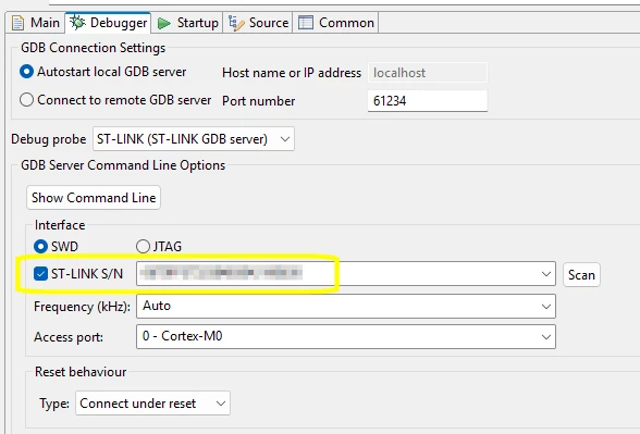

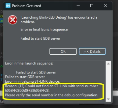

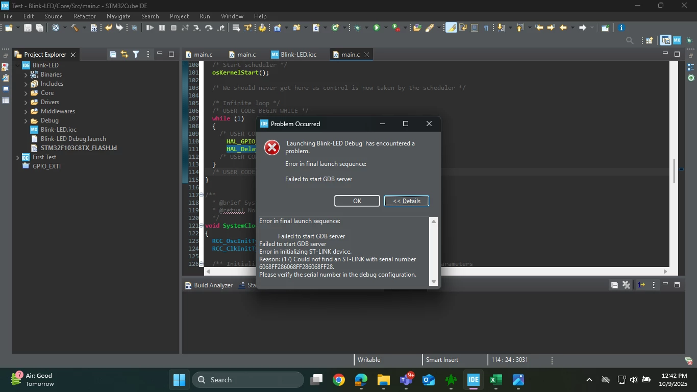

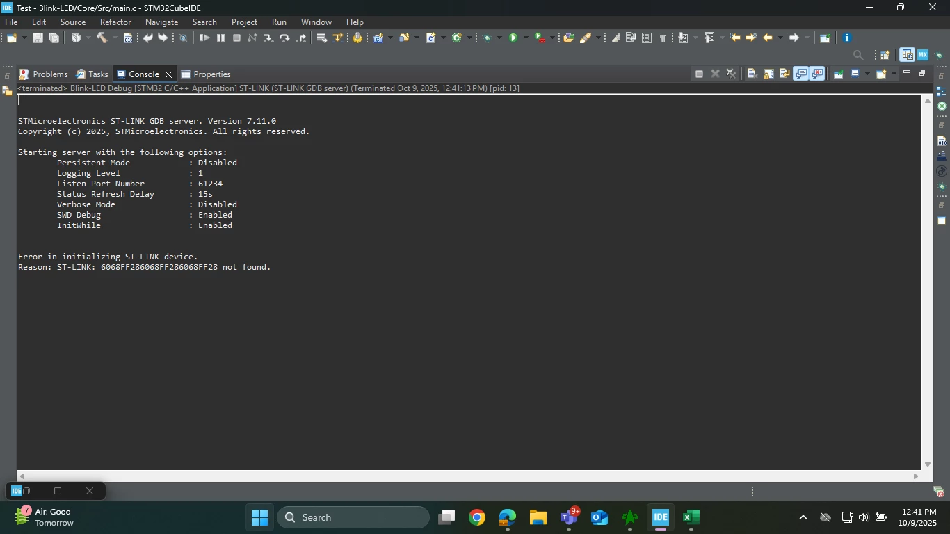

I'm using the stm32 board (STM32F103C8T6) the blue pill for testing. I'm just flashing a blinking led code but getting an error Target not found: No stm board found and also getting ST-Link not found after that. Can anyone help me to resolve this issue. -Screenshot (18).pngScreenshot (19).png Attaching the screenshots for your reference.

@sambanerjee wrote:
This happens when you have specified a specific ST-Link (by serial number) in your debug setup, and that particular ST-Link is not found.
Uncheck that box.

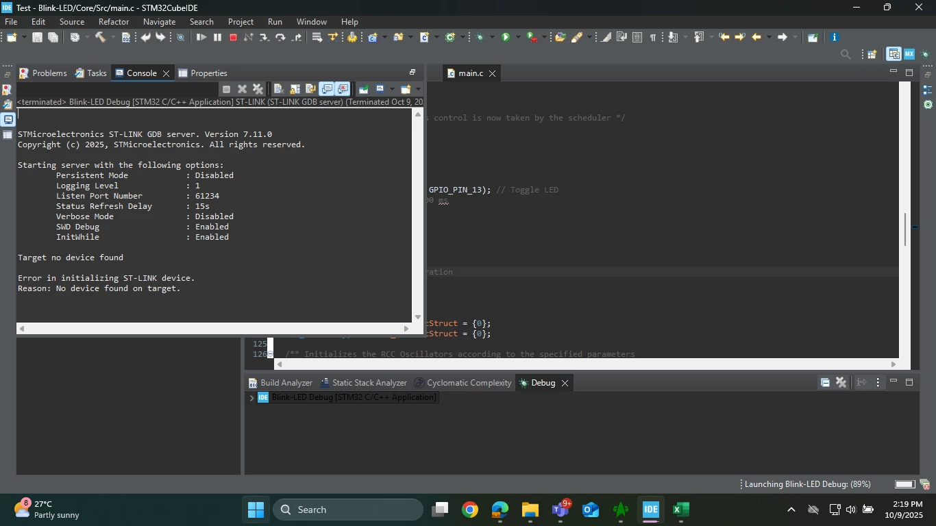

Oct 9, 2025 8:52 AM UTC
Hi Andrew,
Thanks for your reply. As you mentioned, I unchecked that box and tried again. Now I'm getting an error as Target no device found. Screenshot (20).png

Oct 9, 2025 9:07 AM UTC
so at first get CubeProgrammer, and connect then with the blue pill.
Show screen...what its telling.
Then we go on, to get it working.
