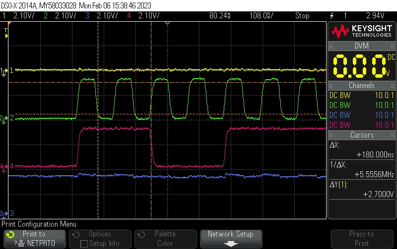

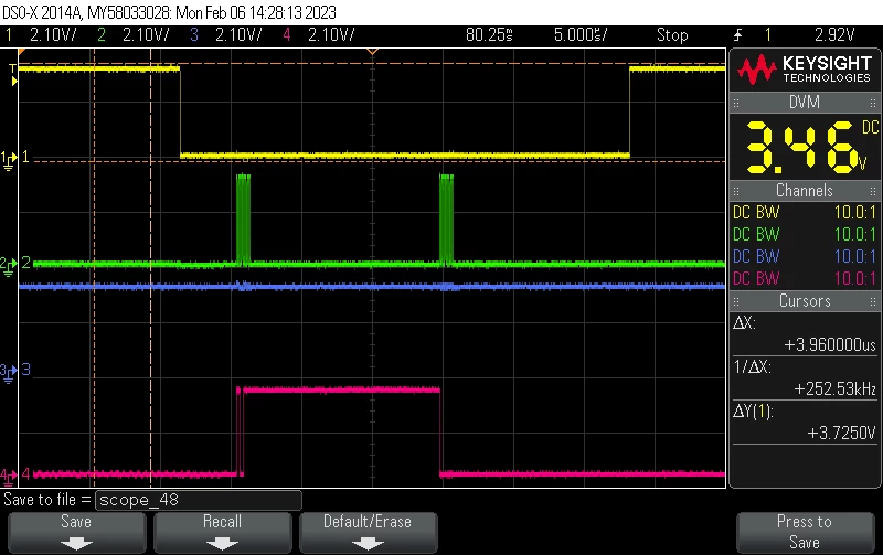

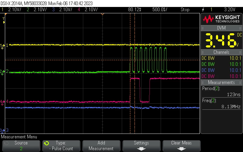

I am using LIS2DH12TR through SPI but I am not able to operate it on greater than 2.8V. On greater than 2.8V I am not able to read the device ID. But according to the datasheet, it is able to operate up to 3.6 V. SO how can I use this ic greater than 2.8V?
Any help would be appreciable

    I'm report here for simplicity:
    Hello Sarthak,
    There's no issue for LIS2DH12 to operate from 1.71V to 3.6V. For your particular issue, I suggest to look into:
    1) The logic voltage level of the GPIO(SPI) of the host controller meets the VHL level of LIS2DH12 (Section 2.3). Please share the SCH to us to review.
    2) Please make sure the CS, SPC, SDI/SDO are comply with the timing spec as listed in Section 2.4.1. Please let us know the clock frequency you are running too.
    Thanks
    HS
    ST Customer Support
    I suggest you to directly reply to that email for further support.
    -Eleon

    Please find the attached output .
    Please let us know the clock frequency you are running too --> We are ruuning on clock frequency 2 Mhz.
    Please let me know if you need any other information.0693W00000YAsRvQAL.png0693W00000YAsRlQAL.png0693W00000YAsT3QAL.png
