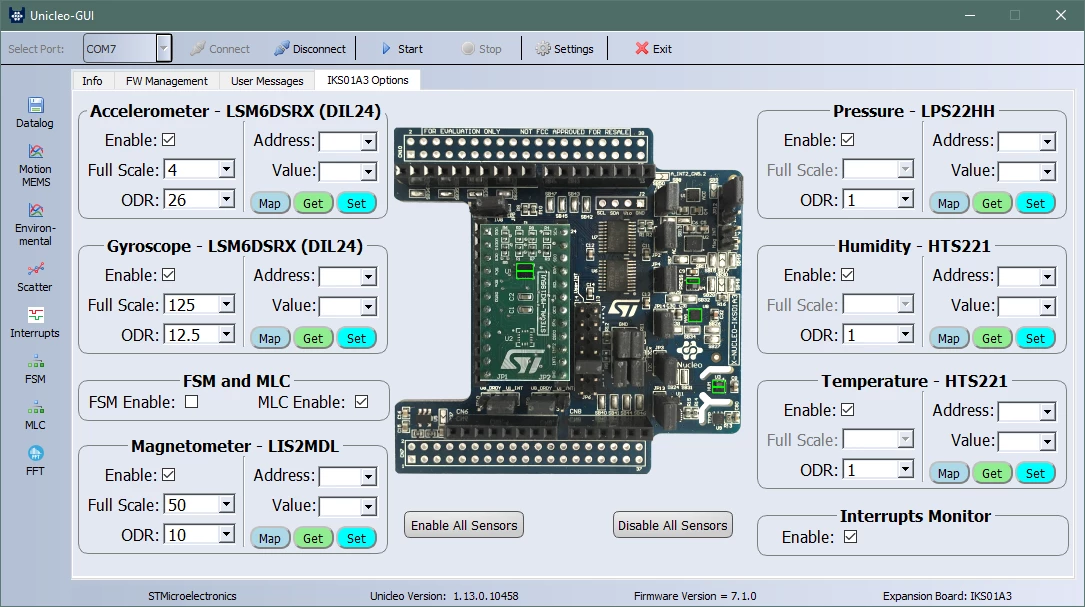

Among the onboard sensor, the accelerometer is configured with ±16 g full-scale and 26 Hz output data rate in low-power mode. Sensor orientation is set as for the ENU convention (with Z-axis pointing up) in order to properly work.

Another possibility for data collection, though less "IoT style", would be to use the X-NUCLEO-IKS01A3 board with Unicleo-GUI, configured as shown in the picture below:

Both the MLC and FSM are configured to process the accelerometer data at 26 Hz in low-power mode:

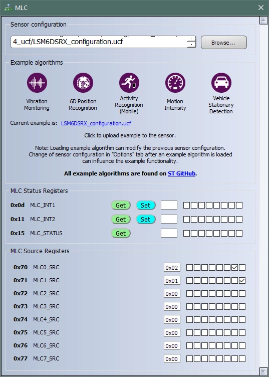

To test the decision tree and the FSM outputs, Unicleo-GUI PC app visualization method has been preferred. The value of the Decision Tree: 1 varies according to the class label described in the previous paragraphs.
  1. Put the SensorTile.Box in DFU mode (Direct Firmware Upgrade): disconnect the battery and unplug the USB cable, press and hold the "DFU boot" button, connect the USB cable then release the button.
  2. Run STM32CubeProgrammer, select "USB" from the pull-down menu on the right, then press "Connect". Click on the Menu button in the top-left corner. Optionally perform a full chip erase. Select "Erase & Programming", browse to select the DataLogExtended binary that can be found in the FP-SNS-STBOX1 function pack, set the address to 0x800 0000, check "Run after Programming", then click "Start Programming".
  3. Run Unicleo GUI, connect to the device, click the checkbox to enable the MLC, then click on the MLC button in the left panel, browse and load the .ucf file, finally click the Start button.

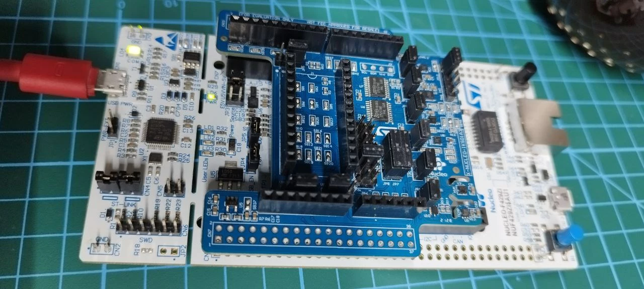

    I'm currently working with NUCLEO-F429ZI + IKS01A3 and I can't seem to connect them to see the data in the Unicleo-GUI.
    I do everything as in the ST video (the 476 controller is used there) I copy the bin file to the folder of my 429 controller, but the Uncleo-GUI does not see my board. What am I doing wrong ? How can I build IKS01A3 support for my controller and view the data through the Unicleo-GUI.

    Same problem with IKS4A1 unicleo-GUI does not connect.
    Jan 29, 2024 5:50 PM UTC
    Hello @MRaff.1,
    I'm not sure what is you HW configuration except you are using X-NUCLEO-IKS4A1. You need to program your STM32 NUCLEO board with DatalogExtended firmware for particular STM32. The DatalogExtended is available in X-CUBE-MEMS1 package.

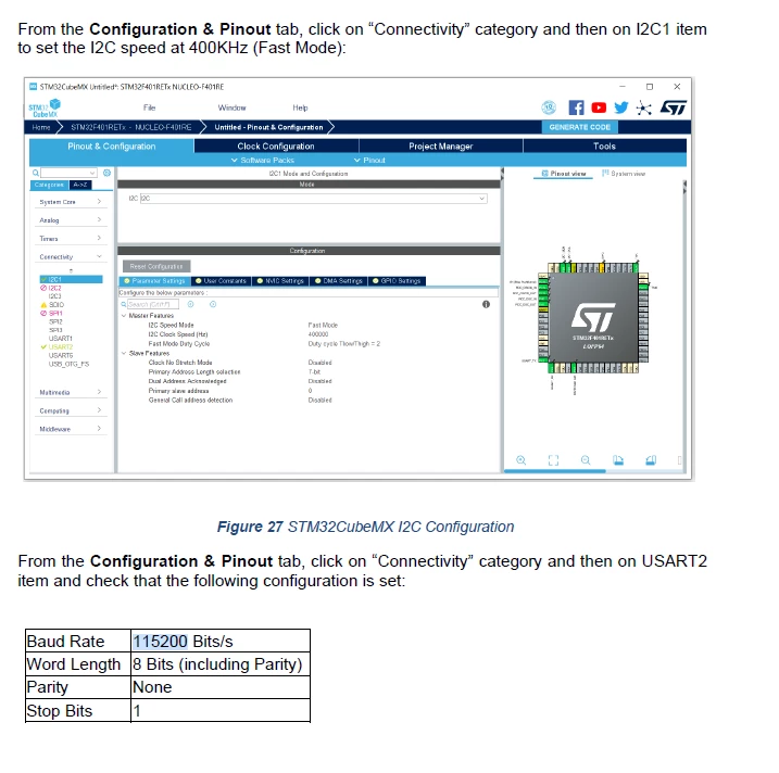

    Thank you Miroslav, now I can connect, I had to set the Uart speed at 961600 as suggested by Federica Bossi  despite the IKS4A1 "Getting started guide", and the CubeMX+X-CUBE_MEMS affirms to set the UART at 115200.
    Jan 30, 2024 8:41 AM UTC
    It is good that you make it functional. Indeed 921600 baud rate is need for communication with Unicleo-GUI.
    Could you please send me a link where you have find the information about 115200? Thank you.
    MRaff.1
    Jan 30, 2024 9:45 AM UTC
    Hello Miroslav, I followed the instructions provided on the document "Getting started with the STMicroelectronics X-CUBE-MEMS1 software package for STM32MX". It is inside the directory \en.x-cube-mems1\Documentation. At page 53 and 60 it is said to set the UART at 115200.
    On the contrary I have not found a document in which it said to set 921600, maybe I am missing some documentation. In particular I am not able to use the IKS4A1 compass, the unicleo-gui highlight the sensor on a further expansion board I don't have.
