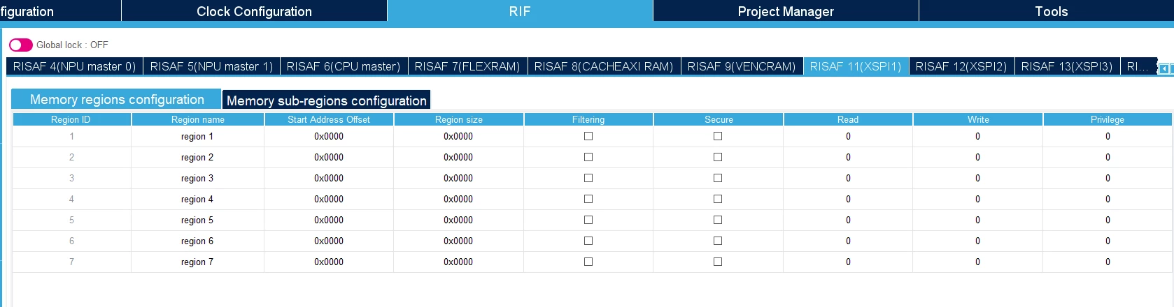

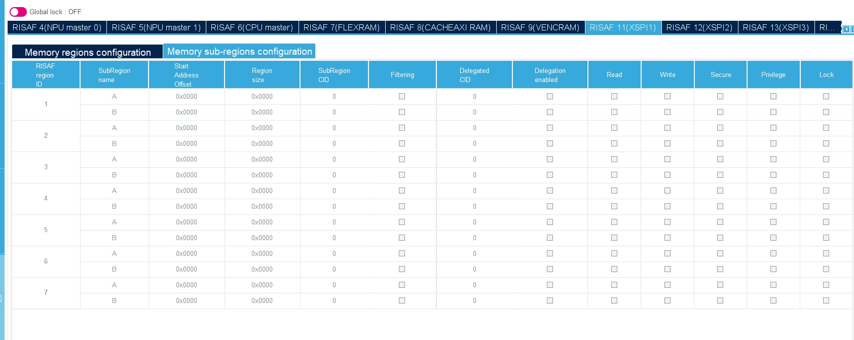

May 26, 2025 3:37 PM UTC
Hello @SlothGrill!
I checked and there was an entry in the memory pool related to the xSPI1, moreover its use was enabled in the memory ram tab. I removed the entry and disabled its use but nothing changed. I also checked if in the generated code there was some line in which the program tried to R/W the external memory but I found nothing.
As for the RISAF, it is configured as in the pictures:
I'm attaching the code, the ioc project and generated binaries if it could be of help.
Question #1: Am I supposed to flash something in the NPURAMs ? As I am flashing the network weights at 0x71000000 which corresponds to the initial address of the octoFlash but from the generated report I can see that also part of the NPU RAMs are allocated and the application binary is just 152 KB...
Question #2: As you can see from the UART output in the previous page, input and output buffers seems to be mapped at the same address (0x342e0000), it is normal ?
Question #3: From the UART output I can see "params: n.a." is it normal ?
SlothGrill
May 27, 2025 11:24 AM UTC
@Dresult ,
I tested your project, and end up with the same behaviour as you: the inference seems stuck in the first epoch executed. There may be a bug somewhere, would it be possible for you to share your original model with us ? (so i can try it with our new versions, that may have fixed that)
Thanks.
Q#1: What do you mean by " from the generated report I can see that also part of the NPU RAMs are allocated" ?
From what i see in your config, no weight/param should end up in NPURams, so there should be no need to initialize them. (if an initializer file is generated, then you can check if it is only zeros). If the NPURams are used only for activations computations, then it should be ok without initing it.
Q#2: Yes this is normal, input is placed in 0x342e0000, then there is no guarantee that the data at this address will be kept intact during inference. This address slot is used during inference to store activations. Outputs are a special kind of activation. So input is at 0x342e0000 before inference (and is then lost during inference) and output is at 0x342e0000 after inference.
Q#3: This is normal, tweaking the code i can print  params : 1077 KiB Printing such info requires you to set the following define LL_ATON_DBG_BUFFER_INFO_EXCLUDED=0 (which will make the codesize grow) + fix an issue in aiValidation_ATON.c:600 -> #if (LL_ATON_DBG_BUFFER_INFO_EXCLUDED == 0)
