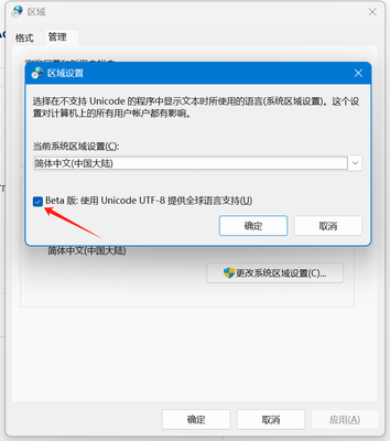

This works fine, but he doesn't feel very well.
And I tried to use utf-8 encoding format, but it's still garbled.

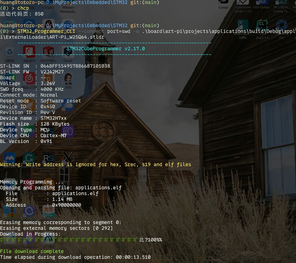

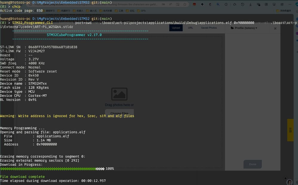

Hello @totoro
I don't think this is a bug since STM32_Programmer_CLI is normally used in cmd shell on Windows or Terminals on MAC or Linux (With the default encoding (IBM850), the progress bar is displayed as expected).
Could you specify what you're using exactly ?
As I see it, this is most certainly a Terminal encoding issue. Could you try the following :
>chcp 850
Let me know if it solves the issue,
Aziz
Andrew Neil
October 24, 2024
I agree with @Aziz BRIGUI - the problem there is the configuration of your terminal: it's not correctly displaying the graphic characters used by CubeProgrammer to display the progress bar.
