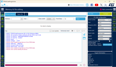

I am programming my STM32F423RHT6. But due to some reason, suddenly I am unable to code the MCU. The connection is getting lost for some reason. I don't know what is the reason for this behavior.  I am attaching my code along with this message. The debugger which I use is an external debugger of stm32. I tried changing TCXO, tried changing the same CHIP. Voltage levels are as per the data sheet. For the 1st few times of programming, am able to flash the code. But after couple of times, facing this issue.
Note:
I kept programming for peripheral by peripheral and this issue happened suddenly all at once. After finalizing the product and manufacturing parts and soldering, I am facing this issue. Kindly help me out.
Is my chip being dead after few instances of programming?

Set CubeProgrammer to mode: normal and reset: software or hardware (try both).
Then show, what it tells.

@AScha.3 It is giving ST-LINK Error. (DEV_TARGET_CMD_ERROR)

First you would need to de-brick your board. I suppose you know how that works, ST has some application notes regarding the ROM bootloader, required applications, and supported interfaces per device.
I cannot provide extensive code reviews for free, but tell you how I would proceed.
I suppose it is not the initial version flashed onto the board, and earlier iterations didn't cause this problem.
In this case, carefully review all changes you made. If necessary, singe-step through the code, starting from the reset vector, not main().
Re-check with the datasheet that you did not reuse the JTAG/SWD interface pins of the MCU. Symptoms would look exactly like that.
Other often-occuring problems are in the startup code, both with memory (RAM) initialisation, external parallel bus interfaces (ext. RAM or Flash), and the clock setup. In combination with faulty/non-existing fault handlers, those can brick the board.
As a side note - from the parts of the schematics provided, it seems to be a custom board, and I can't make out a quartz or another external clock generator for the MCU. If that is true, check your startup code that it does not try to switch to a nonexisting external clock source.

@vbk22398 Also, if it's the first-produced of a new board, consider manufacturing errors.

So what did you add/change between it last working, and it "suddenly" not working?
eg, did you disable the any/all of the SWD pins ?

@Andrew Neil Sir added UART Interrupts for UART4 and UART 5. And added an external GPIO Interrupt. Added few mathematical formulas. The ADC was very random and to reduce the fluctuations, wrote some code using math libraries available by default. I did not enable the floating point in MCU/MPU Settings in STM32 Cube IDE even though I used floating point values. But I did all at once without checking it peripheral by peripheral.

You didn't use one of the GPIOs used by the SWD ?
