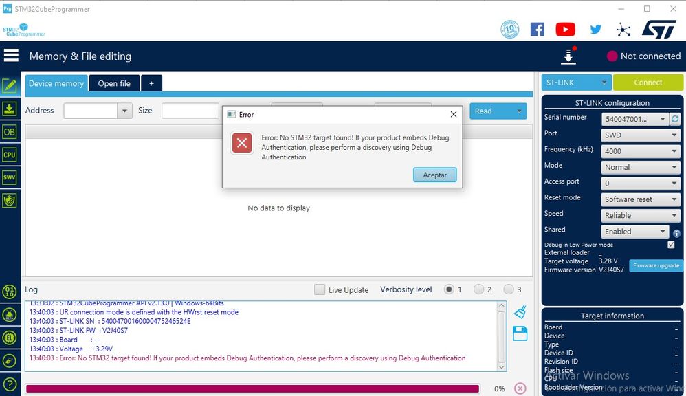

I have the same error: "Error: No STM32 target found! If your product embeds Debug Authentication, please perform a discovery using Debug Authentication"
I did a manual connect (wire) with ST and ST link, and there was no change.
could you guide me?Screenshot 2025-02-14 183959.pngScreenshot 2025-02-10 123154.png

Feb 16, 2025 2:42 PM UTC
Perhaps start by describing YOUR hardware and what's wired to what.
If using a NUCLEO to connect to external board disconnect SWD jumpers to the local target.
