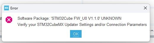

I'm unable to use the STM32Cube FW_U0 V1.1.0.
I have downloaded the package in Cube MX - Version 6.11.1 however when trying to create a project using the
"Start My project from Example - ACCESS TO EXAMPLE PROJECT SELECTOR" i get the following dialogue:

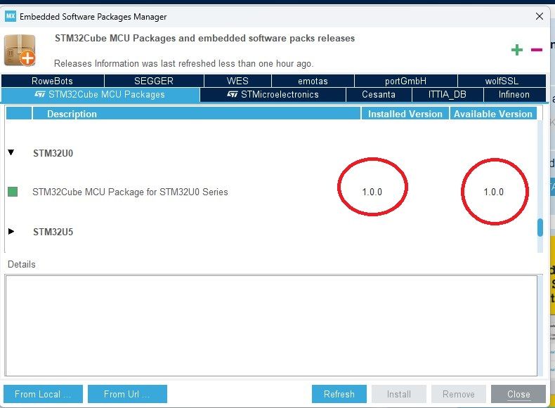

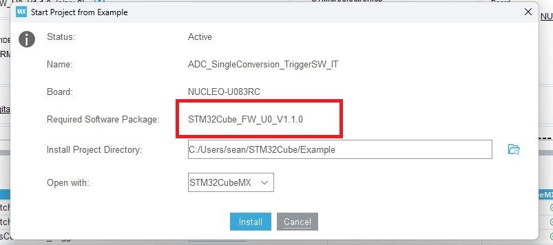

2024-06-16 4:08 PM
I have tried that and I believe that there is something else amiss.
The version of the package that is available is 1.0.0 where as the required version is 1.1.0.
See the following images, I assume this means there is a configuration management issue:
2024-06-18 6:50 AM - edited 2024-06-20 12:19 AM
Hello @Jorgie
Update, I've been able to reproduce this issue on my side and I've escalated this to the concerned team for more investigations and correction (under internal ticket number 184426). As a temporary workaround, you can use the IDE directly to import the project from the repository.
Best Regards.
STTwo-32
2024-06-21 12:09 AM
Hello @Jorgie
The issue has been fixed. Please try again on your side (don't forget to login to Your CubeMX so it can update his files).
Best Regards.
STTwo-32
