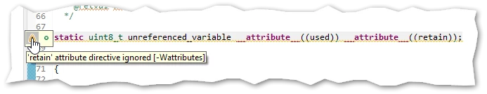

static uint8_t unreferenced_variable __attribute__((used));
There's no warning from the compiler.
  1. Is 'used' supported in principle please?
  2. Is there a problem with the syntax?

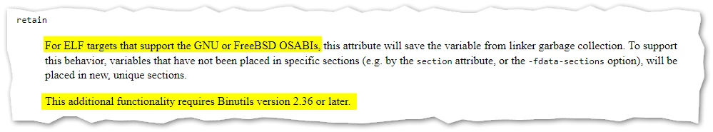

Unfortunately it's a non starter because 'retain' is not supported in the compiler that comes with STM32CubeIDE.
Presumably this is because the conditions mentioned here are not met.

The binutils version for my old(er) CubeIDE is 2.38.20220708, so that's not the issue.
It must be the ABI requirement that's not met.

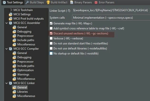

The 'used` attribute is working exactly as intended. If you remove the  "--gc-sections" linker options, the variable will appear in the output.
The default linker options for Cube projects (helpfully) include "--gc-sections". Which means you've asked (*) the linker to prune the variable (to the linker, this is just an unused section). This also, is exactly as intended.

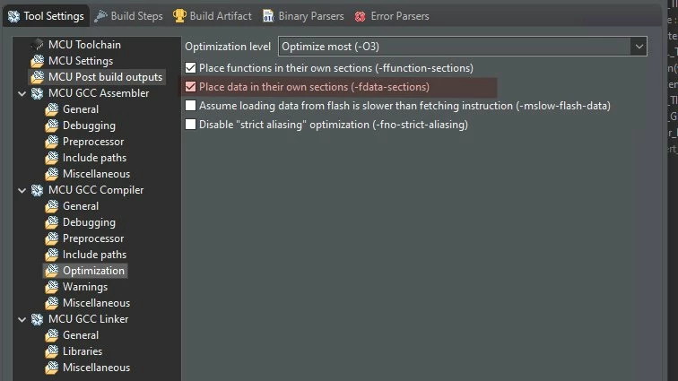

- remove "-fdata-sections" from the compilation flags. Be aware that this may result in a larger final binary (**).
