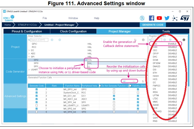

Hi all,
I'd like to register some user defined callbacks using the HAL_***_RegisterCallback() functions.
I understood that first I need to define the compilation flag USE_HAL_***_REGISTER_CALLBACKS but where should I put it? Looking through the various examples I stepped into F4-Discovery DMA_FLASHtoRAM example and its stm32fxxx_hal_conf.h, copied below, which (hopefully) provides the answer.
Considering that i don't want to manually modify this file in my project (nor there is a user code section in it), how can i set the code generator to automatically insert the required defines?
Thanks,
Lorenzo

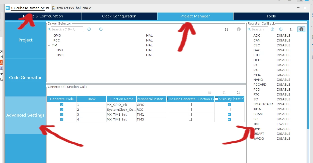

In CubeIDE 1.5.1 in ioc device configuration tool select tab Progect Manager, sub Advansed setting on left side, on rigt side You will see register callback list.
Choose what You need

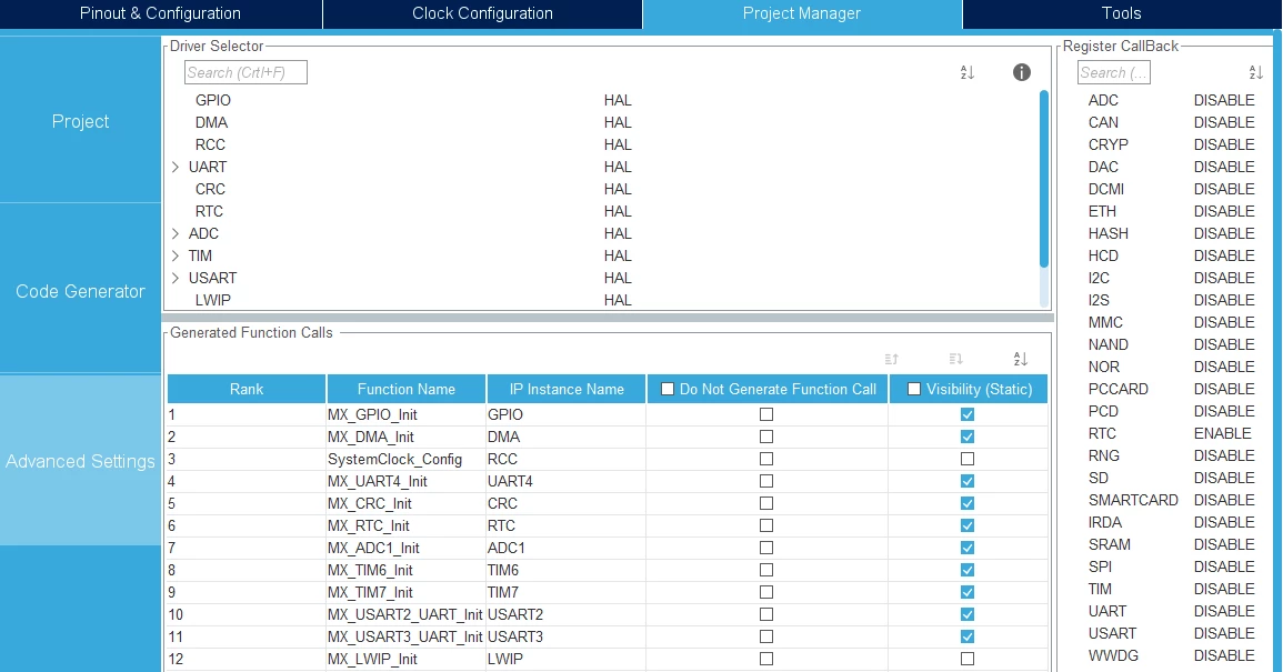

The cleanest solution I could find is to modify it using CubeMX.
Select Project Manager->Advanced settings (Also mentioned in the help pdf)

Hello, i found your awnser.
In CubeMX, go to "Project manager", in the left side you will see "Advanced Settings".
if you go over there, you can see all Register Callbacks on the right side. They are all disabled my default, you can eable them there.
GL ^^

You can set the register callback manually in CubeMx via Project Manager -> Advanced Settings -> Register Callbacks (right-hand site). There you can enable/disable register callbacks for each peripheral individually.
