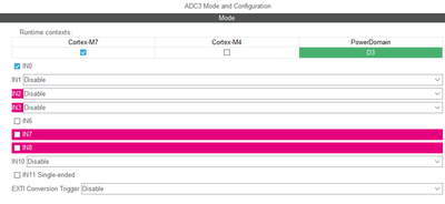

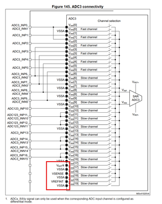

Hi Guys,
In datasheet, there are 20 channels, inlcluding Vbat, Vsense, Vrefint. But I can not find them in CUBEMX configuation page, why?
Regards
Peter

Hello @Peter3718
Think you for reporting this issue that I've reproduced. I will escalate it to the concerned team for more investigation and correction on the coming versions.

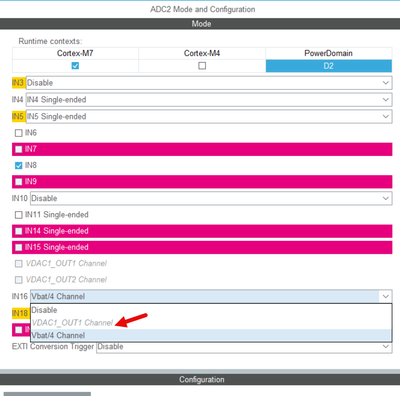

By the way, I found Vbat in ADC2 page, which is not supposed to be here according to datasheet.  Others still can't be found.
Peter
Hello @Peter3718
For ADC3 This is a known issue already raised in this thread and already escalated for fix in the internal ticket 176638.
STTwo-32
@Peter3718 Can you tell me what MCU are you using and update your CubeMX to the version V6.11.1.
Best Regards.
