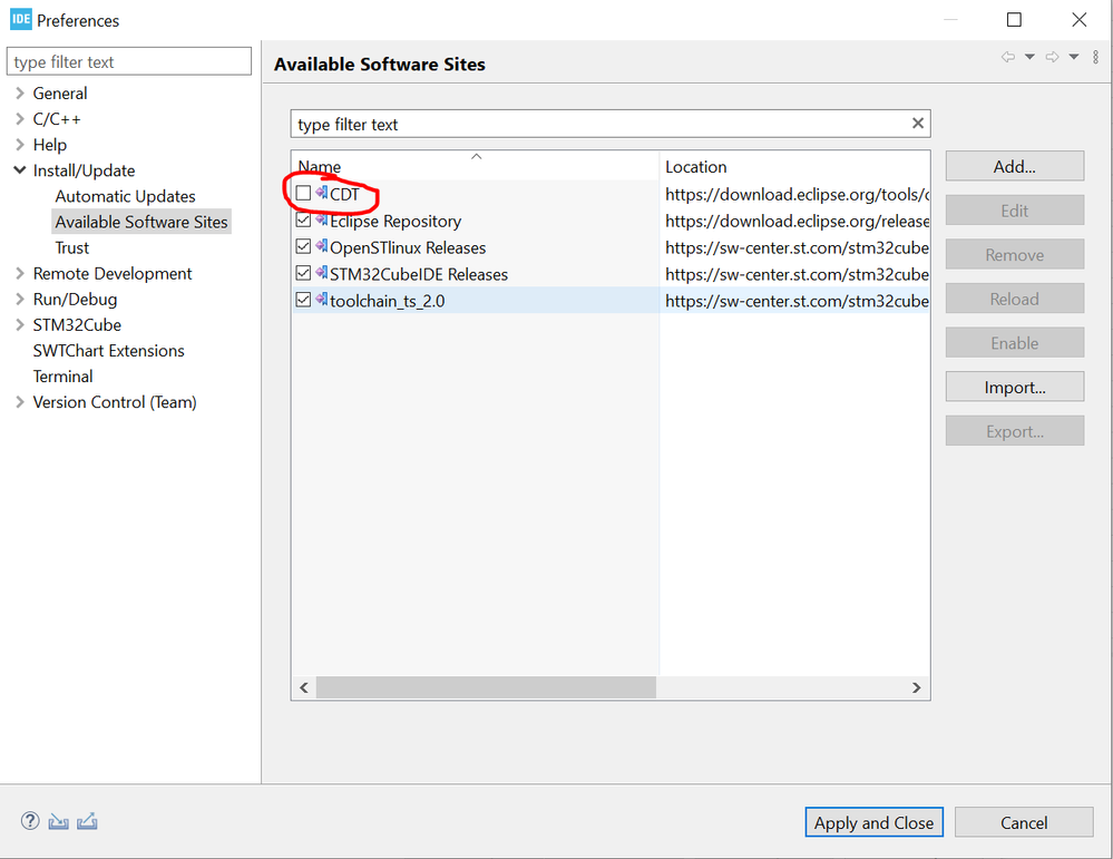

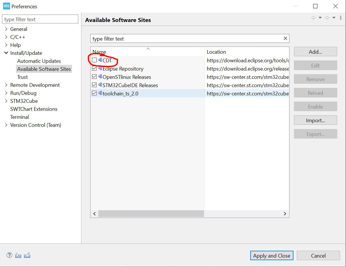

2022-12-13 1:25 AM
Copy-pasted from another thread:
Hello there!
I'm fairly certain that you are facing the new issue that my colleague Mattias is mentioning in this thread:
https://community.st.com/s/question/0D53W00001zeSZcSAM/stm32cubeide-intool-update-issue
It might work if you remove CDT from the available software sites:
We are currently investigating this issue further!
