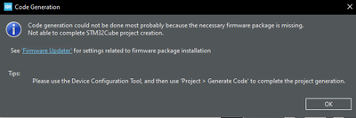

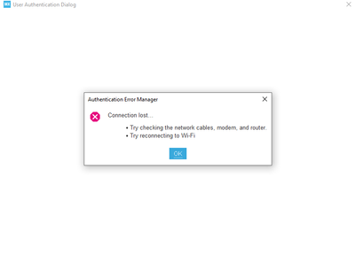

I downloaded version 1.15.1 of the STM32 IDE, but when I start a new project and select the STM32F103C8T6 as the MCU, the first image appears. However, when I try to update the firmware, it asks for a login, and the second image appears. I have searched in several places and realized that this is an error that can occur since versions 1.12/1.13. I have tried changing the network connections to active provider (native, manual, and direct), but it doesn't work. (I'm not sure how the manual one works, but I also saw that it's not good to keep using manual mode). Does anyone have any suggestions? The same problem occurs in STM32MX, and I have also tried changing the internet connection.

Dear all,
This is an issue some CubeMx/CubeIDE users are facing since yesterday and the issue was escalated internally to be fixed asap. Dedicated teams are working on it.

I too faced this issue yesterday and filed a ticket, they asked me to update or re-install. Not even asked for any additional debug info. Looks very casual and they know there are issues with login....

Been down for two days now... I can log in through the web site, but the CubeIDE will not log in. It hangs and says the network is down. I have no proxy, VPN, or firewall blocks. I am working on a new design and can't generate code from the ioc file if not logged in. I would strongly recommend making login optional for critical tasks and just keep retrying in the background.
NOTE: I had another system that was logging in on its own at startup just fine. I stupily logged out to see if the problem was machine specific and now that system won't log in either.
workaround: install CubeIDE 1.12.1
It has no login functionnality and use latest packages.
