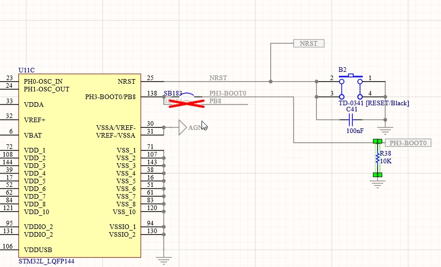

Hardware:
MCU: STM32L4R9ZGJ6 (Custom board)
OSPI mapped to address 0x90000000
ST-Link V2
PH3-BOOT0 pin pulled to ground with 10k Ohm resistor.

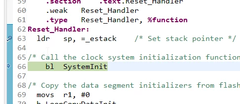

I generated the default project for nucleo L4R5ZI with "new project" from CubeIDE TargetBoardSelector and compiled it without and changes. (linked to Flash)
I started a debug session with a breakpoint directly on the reset-Handler.
"bl SystemInit" in startup_stm32l4r5zitx.s line 66
Pin PH3 (Boot) is wired with 10k to GND on Nucleo Board. The device should start from Flash. Flash-Memory (0x08000000) should be mirrored to address 0
Vector table should be at address 0 being the same as at 0x080000000
So I stopped with a breakpoint at "bl systemInit"

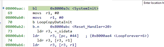

0693W00000D1dGqQAJ.pngWhen looking at the disassembler window, this is at location 0x08000aac (flash memory). This is fine

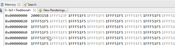

When I open a memory window, I can see, that at address 0x0 there is a bootloader vector table
0693W00000D1d7aQAB.pngWhen reading the Register "VTOR", it says 0
so the vector table is still mapped to 0x0, but the flash memory is NOT mapped to 0x0
As soon, as I let the debugger run the code and the software engages any IRQ, the cpu will jump into the bootloader, because the vector table is not mapped to 0x0

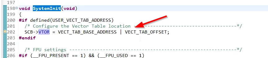

possible workaround:
enable this line in code by defining a global "#define USER_VECT_TAB_ADDRESS"
Now the code sets the VTOR register to 0x0800 0000 pointing into flash code.
