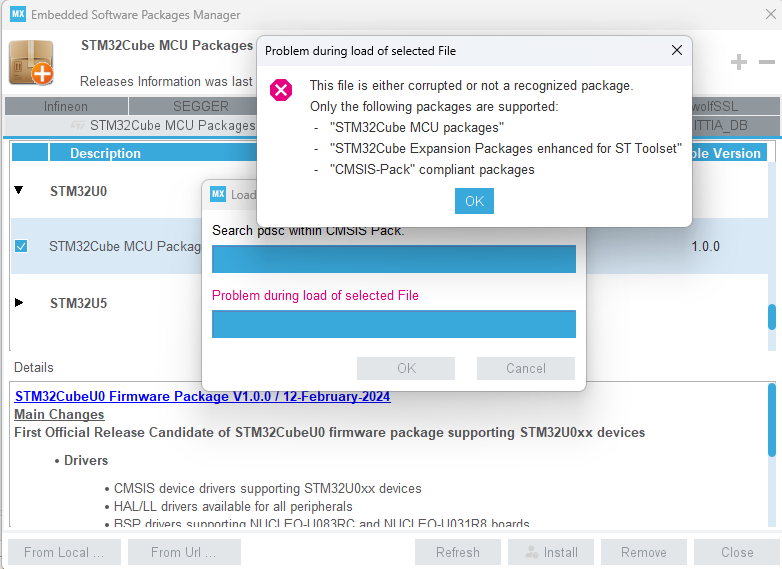

STM32CubeIDE 1.15.1 login error, although Check Connection shows "green" in the "Firmware Updater". Because of the Login error I cannot Install "STM32CubeU0 Firmware Package V1.0.0 / 12-February-2024".
I have seen in the Forum, that this kind of error has been around for a while, and even with this (for the time being) latest version of STM32CubeIDE.
If some of you fellows have working ideas, please let me know!

I have already tried similar methods over and over again since yesterday.
  1. Use System Proxy Parameters for STM32CubeMX:
     I actually get "green" Check Connection with the default Settings in Direct, Manual & Native, Network Connection Settings, and also Refreshed the SW! If the "Connection Check" is working properly, this should be an indication of that there is a connection, but the error is somewhere else.
  2. Install packages while offline:
    There is a problem during load "From Local", as shown in the snipped picture below:

In my Edge browser I am currently writing this message, and was thus able to log into the ST community.
I was also able to find and download "en.stm32cubeu0-v1-0-0.zip" from
https://www.st.com/en/embedded-software/stm32cubeu0.html#tools-software,
and tried to install it from my "Downloads" directory. The bad result was in the snippet picture I posted abowe.
(I was even able to unpack the ZIP.)

Could you try with STM32CubeMX as standalone application.
If the same behavior is faced, could you send me the STM32CubeMX log file found under .stm32cubemx folder.

I could fetch and install STM32CubeMX, and got the same errors when trying local package installation and login. The log file is attached below.

Hello Semer and Jacob WooDruff
On Friday 17-May-2024 I sent the email text below to notification@communitymailer.st.com, as a response, after the error disappeared without my interference...
Hello Semer,
Thanks a lot for your help, :smiling_face_with_smiling_eyes:
the issue on your server seems to have fixed my errors, and I can login and have installed the
"STM32CubeU0 Firmware Package V1.0.0 / 12-February-2024"!
How can I tell the community that you solved the bug?
