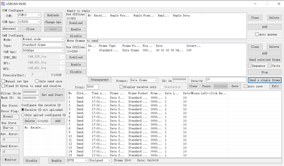

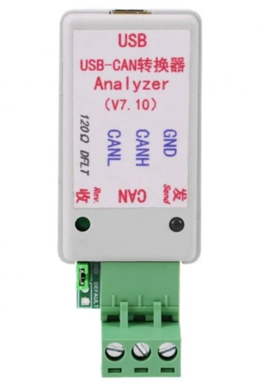

I am using stm32F407VGT board and I am trying to receive data from a can analyzer with stm32 board. I transmit a data to stm32 boards but ı cant receive the messages. I can work on normal mode with two stm32 boards succesfully. The messages are received and transmitted. At the same time, I want to transmit data to can analyzer and I want to observe communication. I attached my main and interrupt source files and I am using USB-CAN analyzerV8 device. The can bps values are the same 500kbps. The modes are same as Normal Mode and I dont define a filter so ı can read every data that ı sent from can analyzer  in live expression on debug screen.
Summarize,
All my purpose, I want to see data that ı sent from can analyzer in my live expression part. I am sending one message fisrtly so there is a one Id.

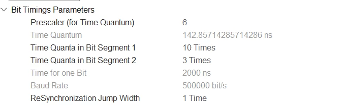

    Are you sure on the speed?
    What's your external clock? What's the AHB, APB1 and APB2 bus speeds.

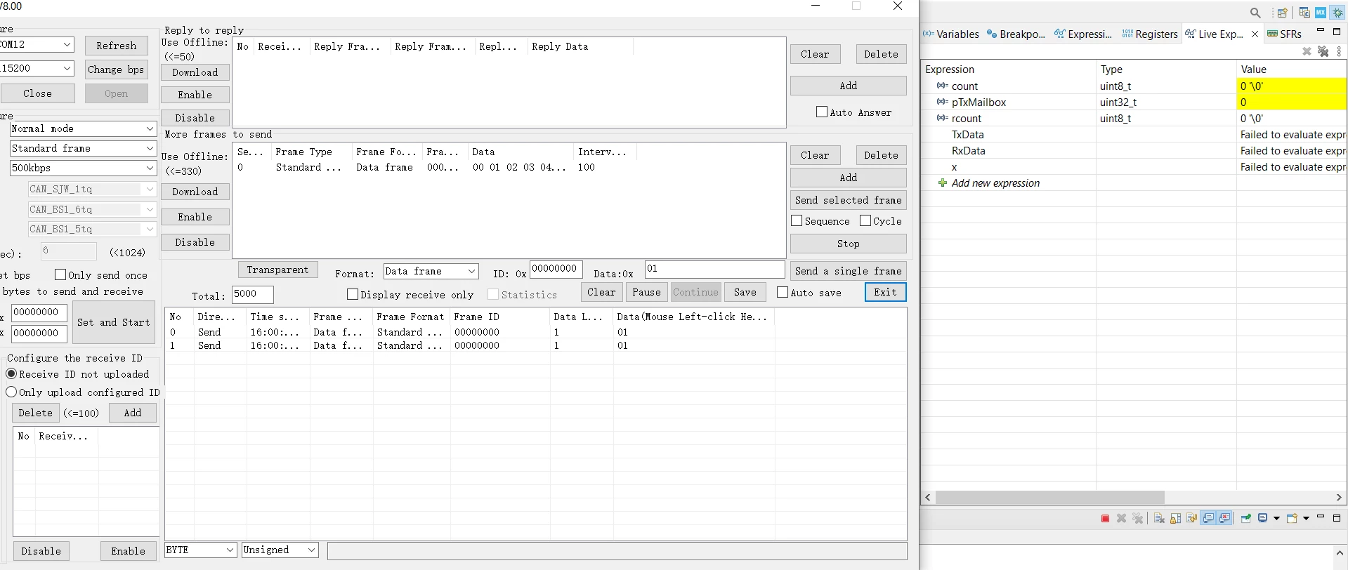

    I am sure that the speeds are the same. It is 500kbps. My external clock is 25Mhz and the Can Bus feeds from the APB1 peripheral. APB1 peripheral is 42Mhz. I want to monitor just stm32. I send a 1 bit data from analayzer and I want to read the data on my stm32 in live expression. Here is a screenshot. You are true about the filter ı forgot the edit filters but yeah unrelated. And I attached a more simple code. The purpose of this program is receiving data from analyzer and observing in live expression. By the way, I am sure that the analyzer is working. Because I received many messages with analyzer from a device that transmit can bus message. and as I said My can bus system is working in normal mode with two stm32 boards
    mƎALLEm
    February 14, 2024
    Ok.. you received messages on the analyzer with another device but did you try its transmit to another device in order to validate that its transmission is working well?

    Also, what about termination resistors of 120 ohm?

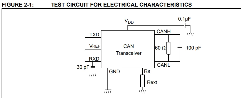

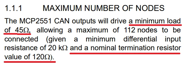

    I use MCP2551 can transciever IC so I used 60 ohm termination resistor on my stm32 can transciever circuit because In according to MCP2551 datasheet , the termination resistor should be 60 ohm in the recommended connection but There is a 120ohm resistor on the analyzer
    Could you please share a screenshot of the part of the MCP2551 datasheet showing that the termination resistor should be at 60 Ohm? I suspect you're are referring to the Test circuit figures ..
    because this is what was said in it:

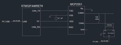

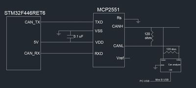

    I changed the terminal resistor with 120ohm on my can circuit and It still doesnt work. I cant understand my boards can communicate but why the analyzer can't ? I attached my can transciever circuit . I changed 60 ohm with 120ohm

    It seems you used "Test circuit" description for your project while this is not the right config:
    So is that possible to:
    1. Remove the following capacitors?:
      • The one connected between CAN_H and CAN_L
      • The one connected to Rx pin
    2. Remove the 2.2Kohm resistor and connect RS pin to the ground

    I tried but it still doesnt work :( I dont know where is the problem. I removed the capacitors except connected +5V one and I connect 120 ohm terminal resistor

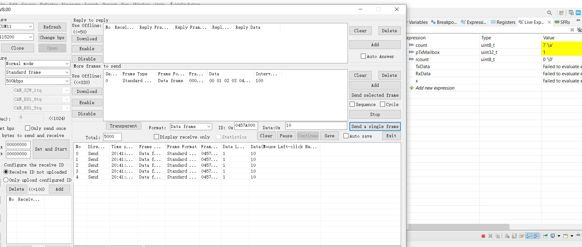

    I readjusted my mcp2551 can transciever circuit and my codes. I attached them. But It still doenst work guys. The prgoram is not getting in canrxfifo ınterrupt function or I cant transmit data to analyzer. Maybe, the analyzer sends hex codes not decimal so can I read hex code data in my live expression panel ? I mean, should I decode  the data in my codes ?
