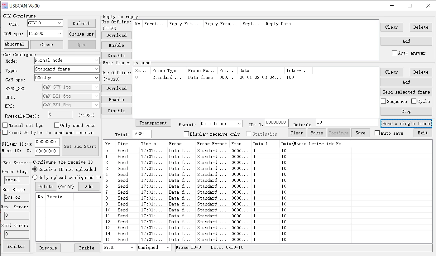

I am using stm32F407VGT board and I am trying to receive data from a can analyzer with stm32 board. I transmit a data to stm32 boards but ı cant receive the messages. I can work on normal mode with two stm32 boards succesfully. The messages are received and transmitted. At the same time, I want to transmit data to can analyzer and I want to observe communication. I attached my main and interrupt source files and I am using USB-CAN analyzerV8 device. The can bps values are the same 500kbps. The modes are same as Normal Mode and I dont define a filter so ı can read every data that ı sent from can analyzer  in live expression on debug screen.
Summarize,
All my purpose, I want to see data that ı sent from can analyzer in my live expression part. I am sending one message fisrtly so there is a one Id.

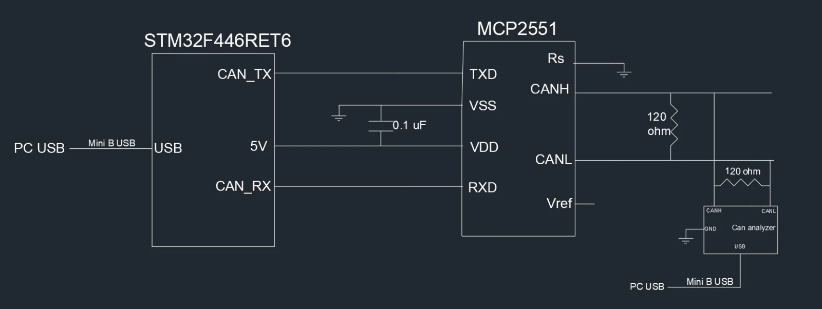

    Attach your project. Draw up a diagram on how you've connected the MCP2551 to the STM32. How you've connected the CAN analyzer to the MCP2551, including power supply, USB connector(s) and grounds.

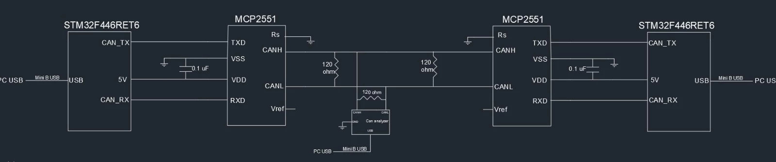

    Here is my schematic
    I observed the can Rx pin with a multimeter. The can Rx pin voltage is 4.88V when no receiving. When I send a message with other stm32 , can rx voltage increase 4.970V and the voltage stay in that value despite I send a data again. Then, I sent a data with analyzer to stm32 , the can rx voltage decreased 2,7V. that is so weird. In addition, when I connect the analyzer in Can Bus line, the stm32 boards doesnt communicate. It breaks the communication.
    My analyzer software settings is right I guess because the can bus kbps is same 500kbps.
    mƎALLEm
    February 21, 2024
    We cannot rely on a multimeter for this kind of debug. You need an oscilloscope for this.
    Meanwhile you need to remove one 120ohm on the CAN but.
    You need only two 120 ohm termination resistors at the extremity of the bus. So remove the one of the CAN analyzer.

    I removed the 120ohm on analyzer but it still doesnt work. By the way, when I observe the can bus line with oscilloscope , what should I observe exactly ? How should signals flow on can bus line or Can rx pin ?

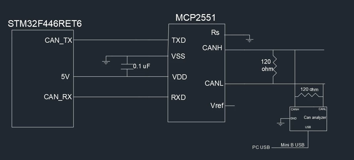

    By the way, according to this schematic before I connect analyzer to stm32 board, the stm32 program works well but when I connect the analyzer to stm32 , an unrelated program is broke like button ınterrupt. I guess, there is a problem on my hardware. You can check out my schema that ı am using and my codes.
    mƎALLEm
    February 27, 2024
    From the beginning I suggest you to check this analyzer! It could be an issue from the analyzer. And still having a doubt regarding a possible issue on this HW. As I don't have one to run a test, sorry, I cannot tell you more ..

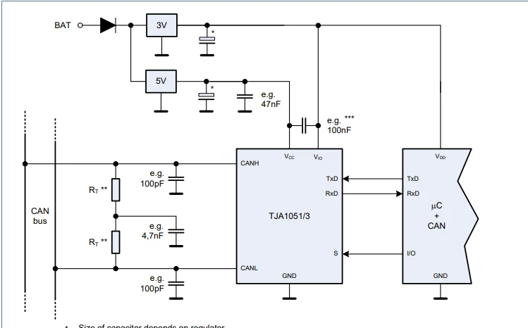

    I will use tja1051t/3 as can transciever. Do I have to connect Vıo to 3V ? Is this a essential thing ?.
    The second one, I will use common mode choke for EMI . Is it okey 51uH ? or should I use at least 100uH ınductance in every node ?
    mƎALLEm
    March 1, 2024
    I could answer your first question: indeed you need to connect VIO of the transceiver with the VDD of the MCU to guarantee a good voltage levels between the MCU and the transceiver and exclude the issues related to VIH min when the MCU and the transceiver don't have the same power supply levels. This is why VIO pin is provided on this transceiver's package.
