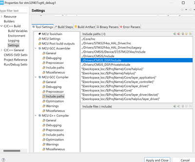

    Hi @baby_chicken ,
    Could you please add the ../Drivers/CMSIS_DSP/Include path and the ../Drivers/CMSIS_DSP/PrivateInclude path to "MCU G++ Compiler" "Include paths"
    Thank you;
    Kaouthar

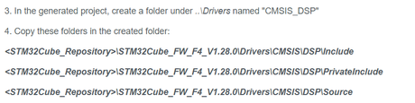

    If you want to use 5.8.0 version of CMSIS or higher, I advise you to follow the steps shared in this FAQ: How to integrate CMSIS-DSP libraries on a STM32 project
    Please let me know if the issue is solved or not?
    Thank you.
    Kaouthar
    August 28, 2024
    @KDJEM.1  ,Thank you for your response
    When I try this method, I get an error “error: arm_math.h: No such file or directory”.
    What should I do?
    best regards.
    KDJEM.1
    August 28, 2024
    Hi @baby_chicken ,

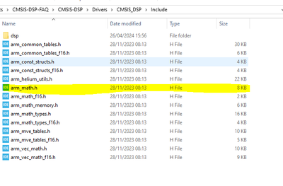

    Are you copy the Include Drivers from STM32Cube_FW_F4_V1.28.0\CMSIS\DSP\Include to your generate project?
    For that please, ensure that steps 3, 4 and 7 shared in the FAQ are followed properly.
    Thank you.
    Kaouthar
    August 28, 2024
    @KDJEM.1  ,Thank you for your response.
    I just checked and copied it to the project generated from STM32Cube_FW_F4_V1.28.0\CMSIS\DSP\Include.
    best regards.

    Hi @baby_chicken ,
    Thank you;
